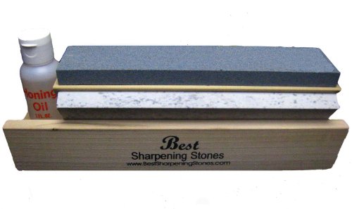

I bought one of the triple Arkansas stone setups on a base. Gets my knives dangerously sharp. I really had to get used to handling them much more carefully than before - after a few deep slices in my fingers. LOL
