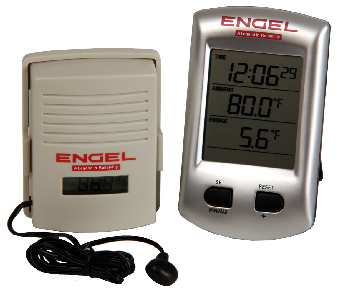

I would call an outside thermometer -preferably wireless and preferably with an audible alarm- a must when you're taking a fridge on the road. You don't want to discover in the morning that your fridge stopped running overnight... And you may want to keep in mind when you set up the probe that there are large variations in temperature inside most fridges.
I have used the Engel wireless one for years, it works great.
Keep it on the side of the fridge, in your tent, or out by the eating table.

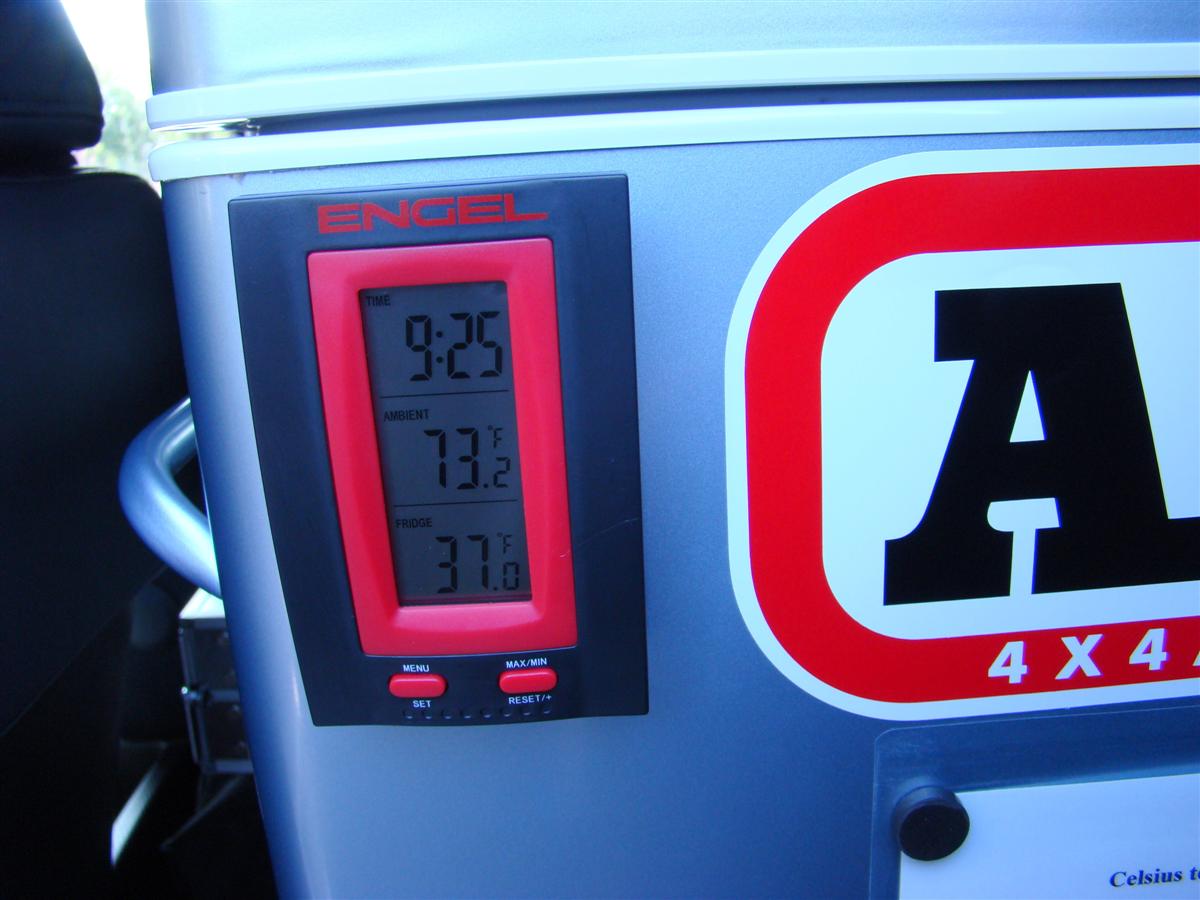

Another ARB feature is the continuous LED temperature readout on the outside of the fridge. I can read mine through the back window of my 55, or when accessing gear in the back. Makes it easy to monitor the temp.

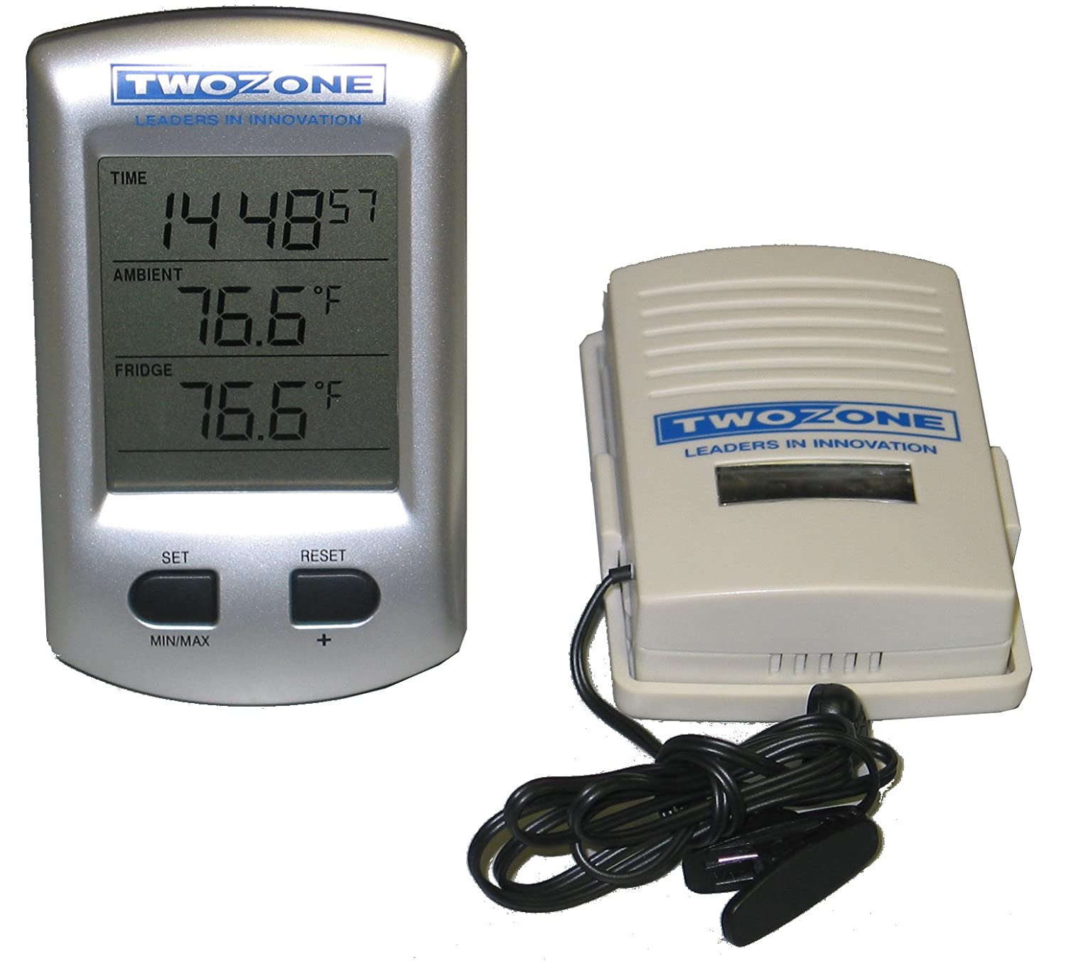

I see the arb monitor is specific to the fridge. Does anyone have a non-arb wireless monitoring system that works well? I could probably buy a cheap outdoor wireless thermometer and display, but not sure how that would look.
I have this: http://www.amazon.com/Twozone-WH-0200-Digital-Refrigererator-Thermometer/dp/B002B9FEEU/?tag=ihco-20
It's identical to the $39 Engel two zone thermometer but it's only $19. I keep the display (fridge temp and inside truck temp) in that weird little "cup holder" under the dash and in front of the shifter in an 80 that no cup will fit in. It's perfect there, you can easily read both temps at a glance. If you look on amazon you can see the Engel version, they look the same.
The sender stays outside the fridge, the sensor is that peanut sized black thing on a clip. I clip it to the side of the basket about half way down to get a median temp rather than all the way down cold or slightly warmer near the top.
