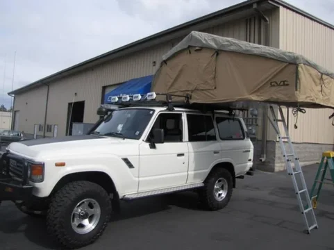

ARB fan
I put an ARB on mine without the mesh floor - which I think adds about 15 lbs or so (?). I really like it because it seems well engineered and I also dig the dark gray powder coating vs black... matched up with my front/rear bumpers nicely.
I know the PVC wrapped gutter track that comes with the ARB distributes the weight, but I didn't put that on mine. I fashioned some little feet for the mounts out of rubberized cork. I felt like the track would eventually start scratching paint where I couldn't see it and expose raw metal... and we all know what happens there!
Here is a pic of mine with one of the 62's biggest fans!
