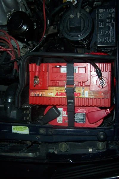

I bought this Odyssey PC2150 on ebay about 3 years ago for $225. It shares the tray with an optima 6v that is tied in series to another 6v fastened to the fender support on the passenger side. That is a stainless over-the-center 300lb tie-down fastener holding down the weight.

Odyssey PC2150. That is a stainless over-the-center 300lb tie-down fastener holding down the weight.
Where did you get the tie down? Where is it connected, to hold down the battery?
I have a group 31 odyssey (PC1700MJT) and it fit in the stock tray without trimming. I had to make a spacer out of some wood as the odyssey is shorter than the original. I also ended up bending the j hooks slightly about an inch or two from the end to get them to go through the holes on the cross bar. It is a very secure setup.
Please post a photo of this.
I acquired the tie down about 3 years ago from a industrial tie-down supplier. At the time I could not find it retail so I called the supplier and was told they did not do small orders, but she volunteered to send me a free sample. ;)
Try a google search on over-the-center tie downs. I think I saw somewhere recently where you could get these retail now.
I had my wife help me thread and sew webbing straps into hardware used to bolt them down. I used existing battery tray bolt locations directly under the batteries for anchor points.
