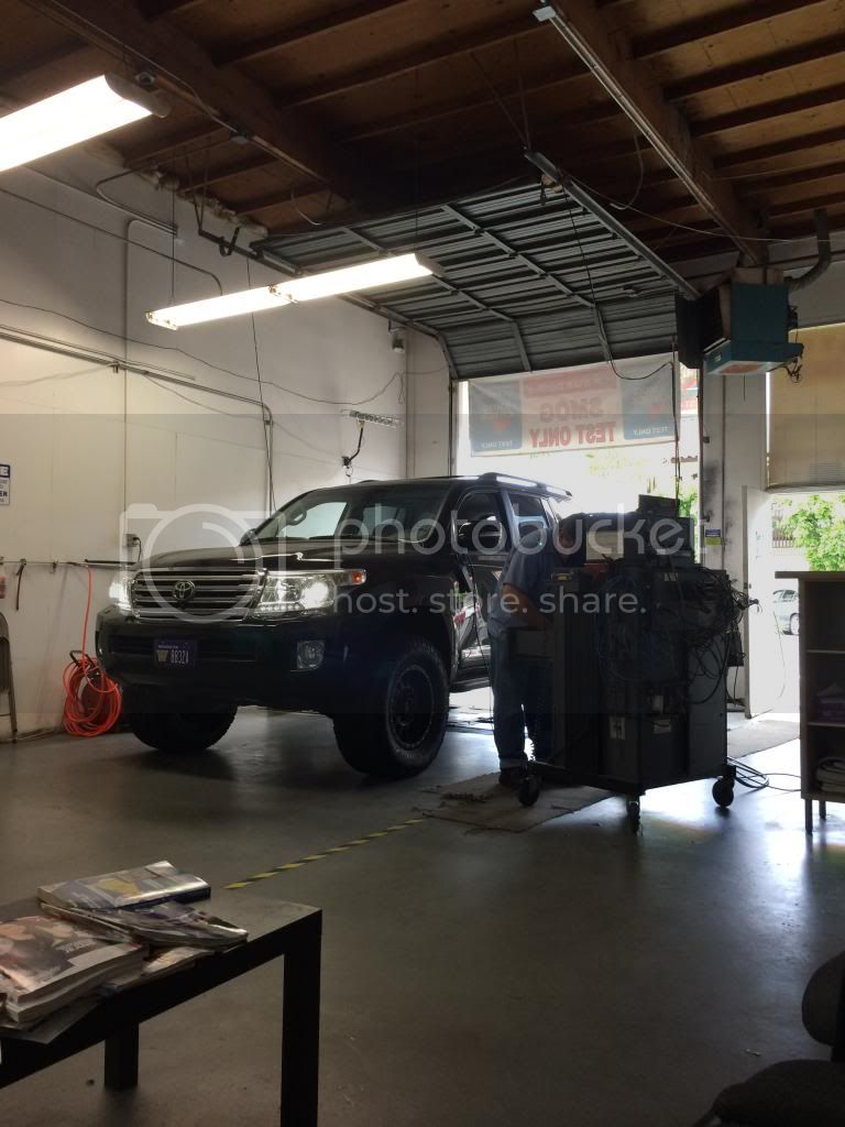

I was going with the 305/60's but went with the more aggressive tread on the Toyo Xtreme 285/65r18's. They are louder at hwy speeds but not annoying.
Just under 33 inches and wide enough to fill out the wheel wells.
Just under 33 inches and wide enough to fill out the wheel wells.View attachment 1007302

The NTG's in 305/60 are really a great balance all around. Barely louder on the highway than stock, great manners all around, yet capable off road. I keep wanting to go bigger, but practically speaking, it would bring compromises that don't exist for me now to any noticeable degree. Like lost gearing that would compromise power and towing (w/o regearing). Little talked about but even more importantly, braking torque would be compromised and that safety margin is not something I want to give up with family or track car in tow. And for width, obviously I'm at the max threshold now unless I want to run spacers or different offset wheels which would compromise suspension geometry.
Meh, all that stuff is a bit over-baked especially since we're not talking 35s, at least speaking from a 200 owner's perspective. We're not on ih8 because we keeping things as-is.
You definitely choose your own adventure it when replacing any OEM part with a non-OEM part. 33s and going wide is hardly sticking your neck out. Plus, it's not like we're trail braking at 130mph hot into a chicane from a long straight here. I had the LT AT2s and now the Xtreme AT2s - noise level is barely, barely noticeable. Like you, I have a side hobby that involves go-fast smaller cars (911s) so I get what you're trying to think through.
Good luck and have fun.
I'm all for 35's, and yours looks great BTW, but it's just not completely practical for my usage. I don't kid myself and pretend my car is sees 50% off-road use because in reality, I need to it work better than great on the highway where it sees 95% of it's usage. 33's walk that balance better. 35's are a slippery slope of compromises I'm just not willing to take until this truck becomes strictly an off-road play thing.
