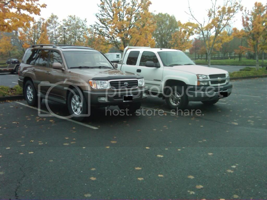

Here are the results! Nitto Terra Grappler 295/70R18. Very happy with the upgrade! Spedo is now way off (55 indicated is 62 on GPS!) I have a very slight rub on the front PS when that corner is loaded in tight turns (it rubs on a protrusion of the plastic well liner right at the elevation of the rocker). I plan to lift it over TG weekend (thinking 866's), if this doesn't cure the rub I'll trim about a 1/2" of the plastic.
At the tire store before swapping the LC caps back on the Tundy wheels:
Size comparison against my buddy's 3/4T Chevy. 34.26" is a sizable wheel!
:eek::eek::eek::eek::eek::eek::eek: 295s look awesome on a stock hundy
Thanks LJ!
I was a little worried about both the size and the offset, but it worked out perfect. The 295's are wide enough that it no longer looks like a 'rail car' from the front/rear. I really didn't want to add spacers and I'm happy with this look.
Thanks LJ!
