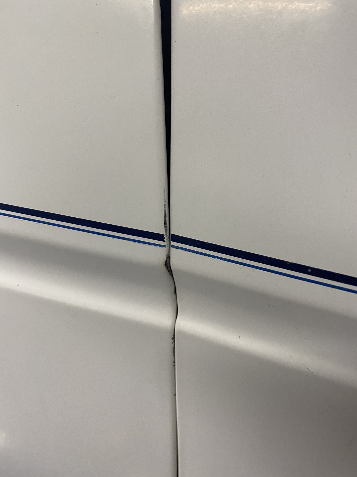

So the PO said the passenger door didn’t close perfect, and it looks like the door was hyperextended at some point. The door rubs on the fender here

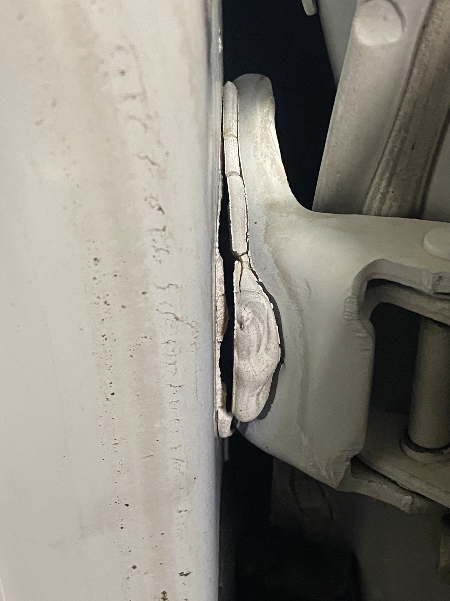

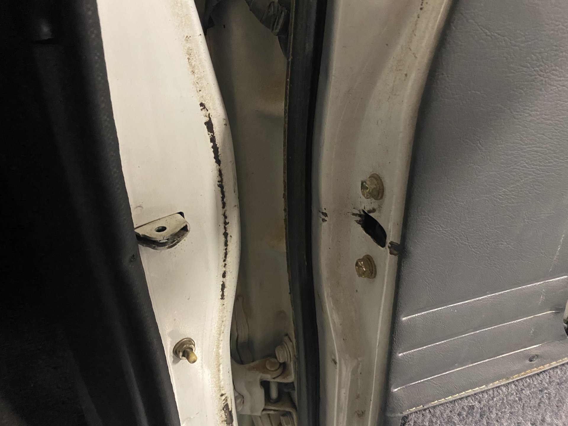

The hinges have a gap in them and the door limiter is missing. Anyone know the PN for that?
IIRC, a lower passenger's side front door hinge can be flipped and used as an upper driver's side hinge. Study closely to be sure you don't need to relieve any part of the hinge before bolting it in.

I've got some white hinges from an '83 FJ60 I parted out. Haven't paid much attention to if they're easily removed from the body, will take a look tonight when I get home.
