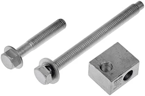

Throwing this out there for those looking to replace the nuts and bolts that adjust the alternator and air pump belt tension on FJ60s -
I found Dorman part #917-148 on Amazon (LINK) to be a good fit and replacement. It has the same M8x1.25 thread as stock. Quick and easy fix for any stripped/bend/tired OEM parts.
