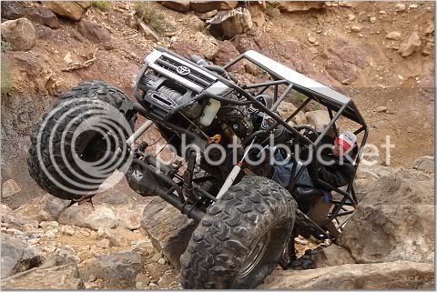

I beat the hell out of my chromo mini axles with a 3.4l, full exo, and 37"s and dont have many problems. If you have a real fat piggy, just done go bigger than 39"s with the 80 stuff. I just watch the Slee guys replace two ring gear with a raeeelllllyyyy fat piggy. Both front tires were five feet off the ground (boy scouts honor) at full throttle when one broke. It was worth it :beer::beer:
