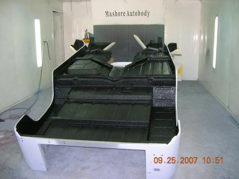

heres a pic of how mine came out:
good luck
heres how mine came out
we really had plans to lay it on thick , so we used 3 and a half kits ( boxes of it)
