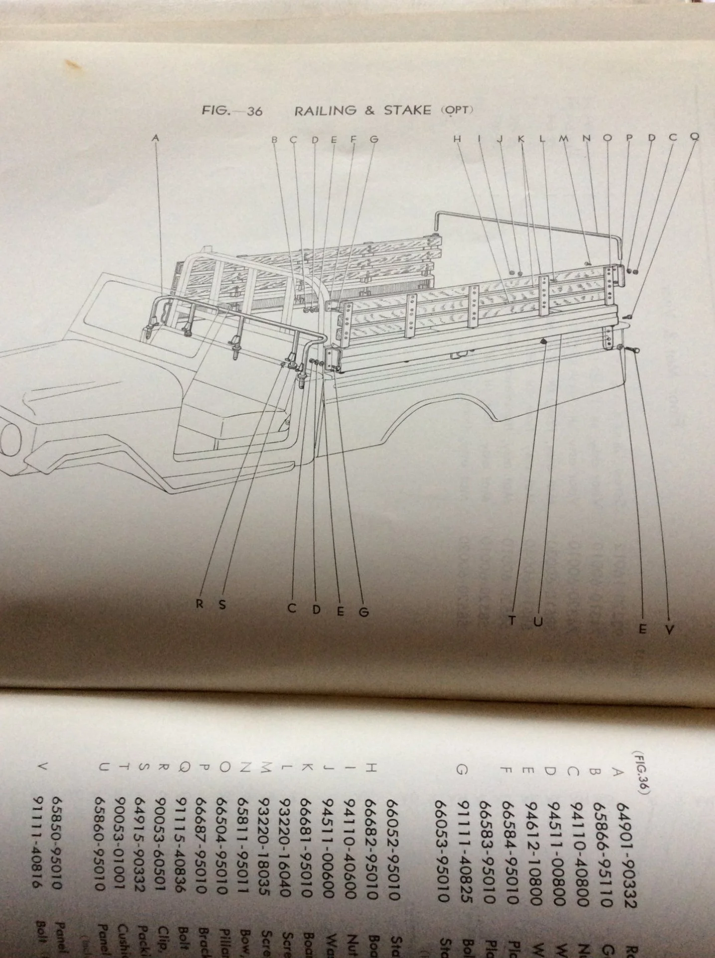

Here is an OEM option. I have never seen one in person. I am looking at making one.

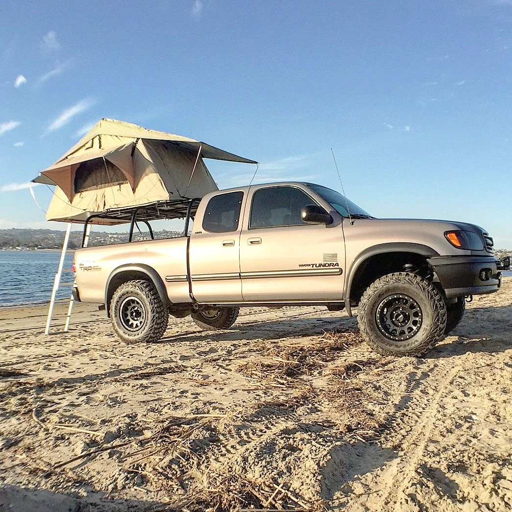

Made an aluminized tubing rack to carry kayaks. Strong enough to carry stuff, sleep on or just cover with a tarp

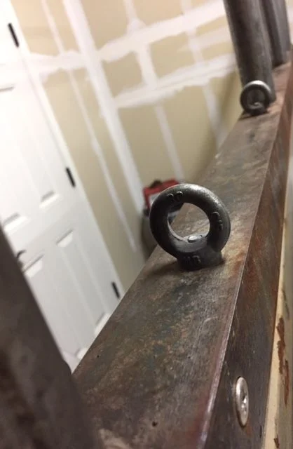

Just a few bolts on two strips of angle, I clear coated the welds, and hit the road

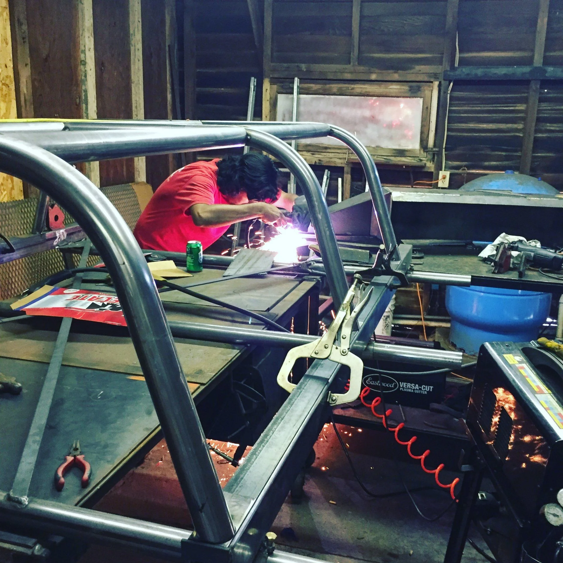

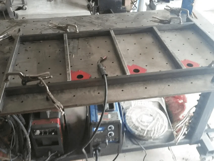

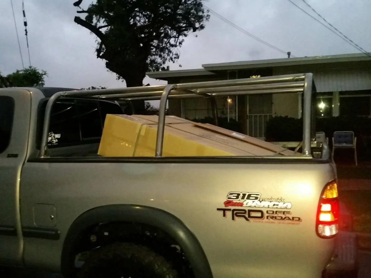

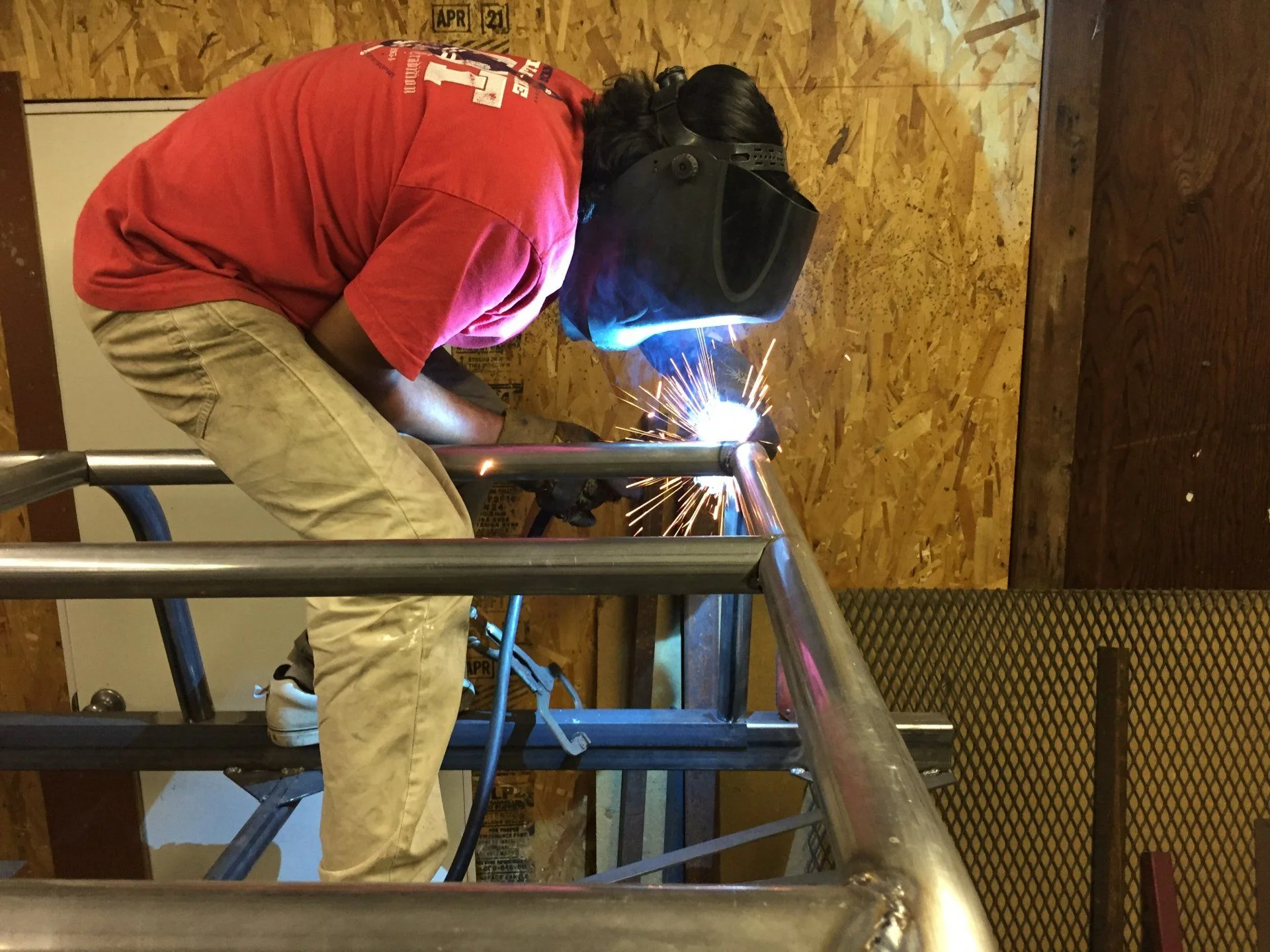

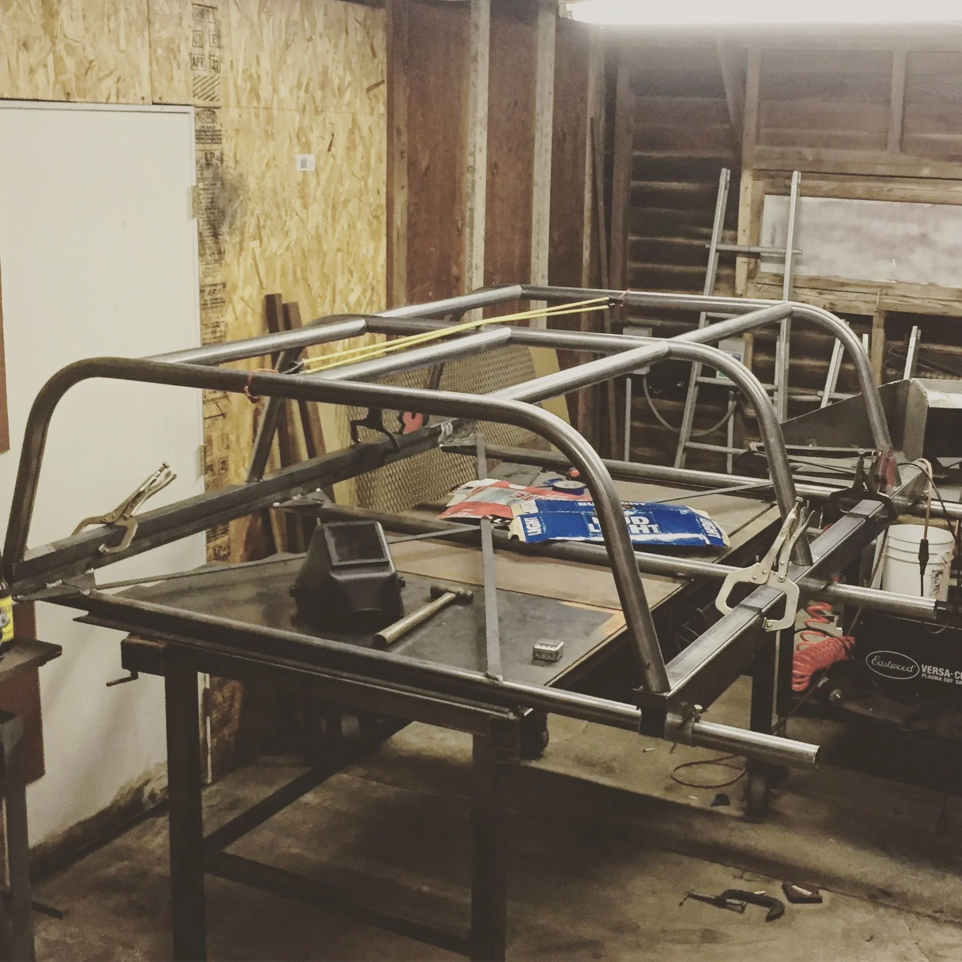

Angle iron, as mentioned above, can be cut to allow clamps to grab your bed rails, or it can be definitely drilled also. Here is a bed rack built for a Gen 1 Tundra, the one shown in progress we are building for a 2017 Tacoma with 1.75 diameter steel tube, 1/8 wall, 1/8 angle iron 2x1.5. Cheers
