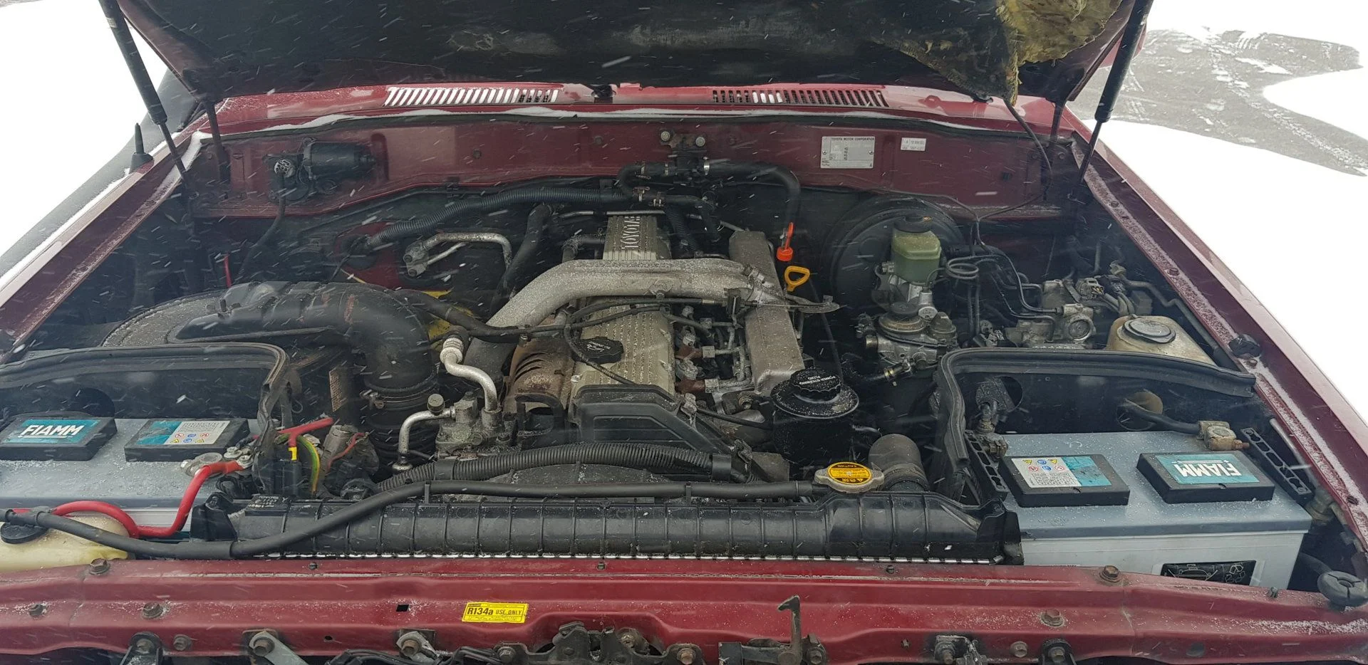

Any idea what are the required CCA for the HDJ80. Here is a picture of my engine bay, just in case guys need to know the wiring set up. But, best I can tell it is two independent 12V batteries, that go into a converter to 24V. Please correct me if I am wrong.

you need reverse posts on one battery. Do not ever turn the key and start your rig while jump starting. You are missing the decal on the DS battery cover that spells this out. I use lead acid and change them every 2 years. looks like an HDT- do the big end bearings and pull the acsd.
@sailor - why do I need reversed posts. Is it so the wiring can reach the posts? Or, can the batter just be turned around as in the picture above?

You'll want one group 27 battery and one group 27F (reversed terminals so the cables reach). I don't remember exactly what CCA they are, I want to say 725.

one battery will go 24 volts when starting. You might fry the other vehicle. Id pull the BEB asap.

Looks like yours probably has 24 volt start. Both batteries should be matching and replaced at the same time.
Yes you will need reverse terminals for the right side battery

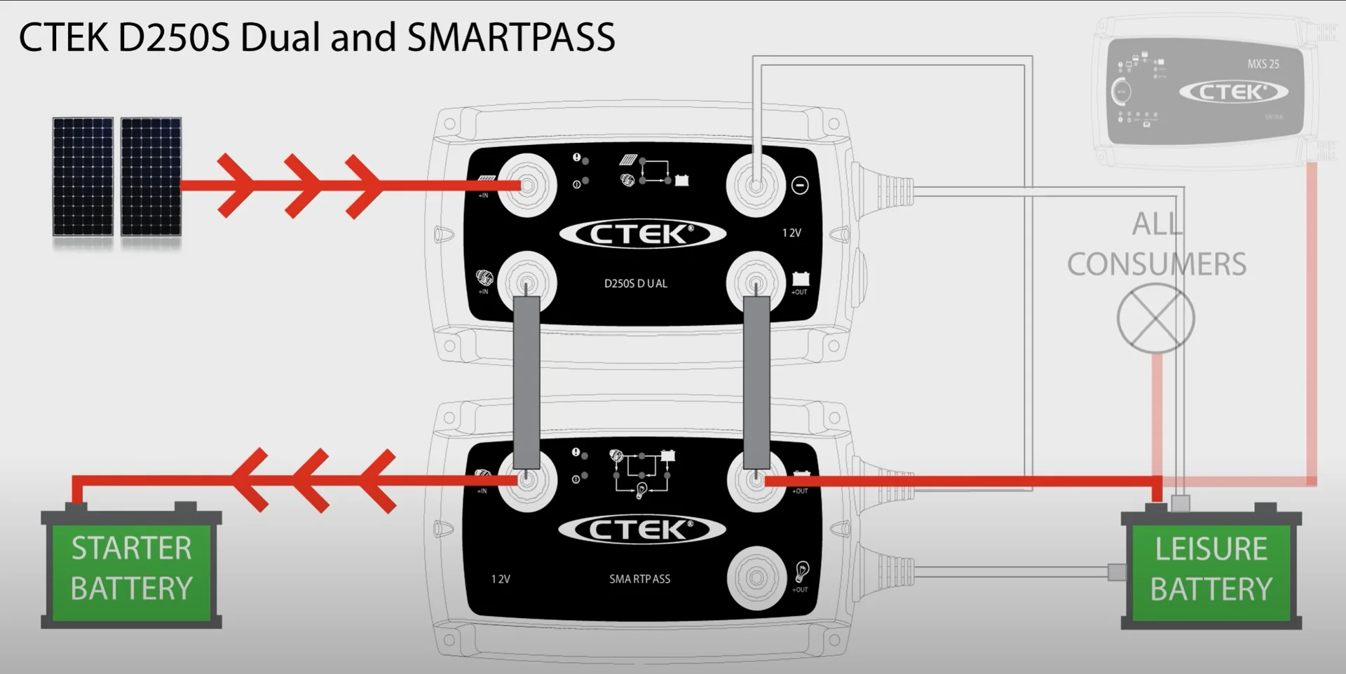

I have 2 Northstars in mine and I have a CTEK D250S Dual and SMARTPASS to top them up full and it also acts as a Charge controller for Solar.
It maybe a bit overkill but i can mix and match battery chemistrys without issue.
