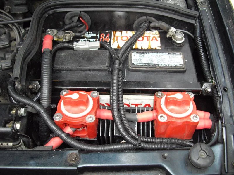

I used these Blue Sea switches as well (300A cont). One on the left is for winch, and the one on the right is to join my batteries.

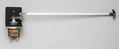

Yeah the reason I was leaning towards those knife style switches over the marine style was just for the emergency "holy crap" moments
( had the marine ones before as a night switch, so some evil friend didn't winch my truck to a lamp post while I was away.:lol:)
thinking I could attach a pull to the knife switch and have it somewhere accessable. A tab by the grill or dash maybe.
When my solenoid stuck it was naturally right at the end of the cable and was cinching the crap out of everything and I was desperately trying to get the hood open so I could unhook the battery cable before something snapped. Which meant having to run around the truck to get to the other hood latch...was not cool..
Some sort of emergency shut off that didn't require getting the hood open would have been nice...
