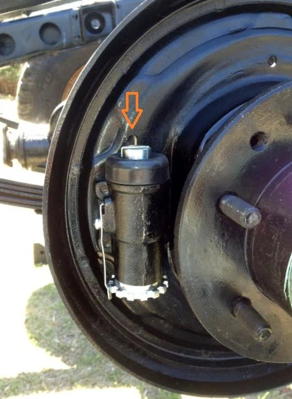

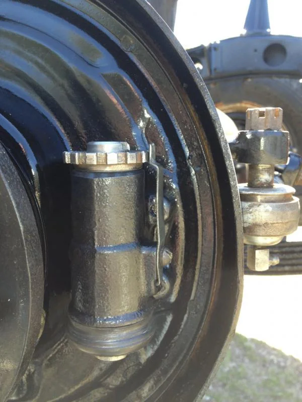

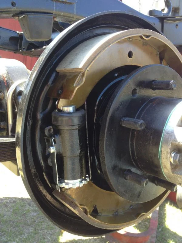

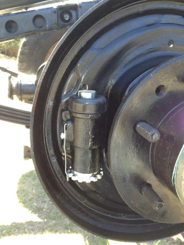

Wheel cylinders are being refinished and rebuilt. I mounted the front right cylinders, and wanted to check with MUD to make sure I have things oriented correctly. Cylinders marked "R" are on the right side, and bleeders are outward. Pics to verify; one new aftermarket and one rebuilt with Aisin rubber.
More assembly pics for right side. I guess I need to get the drums machined!

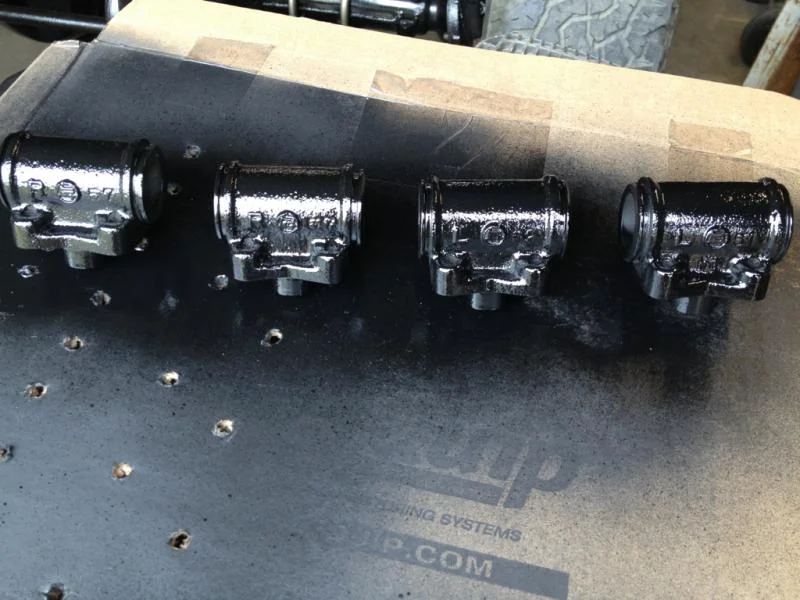

This week I am still tinkering with brakes. Fronts are assembled. Rear cylinders are cleaned and painted, I'm going to reassemble them next time I get out to the barn.

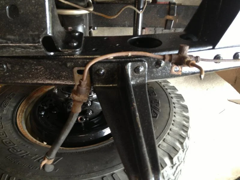

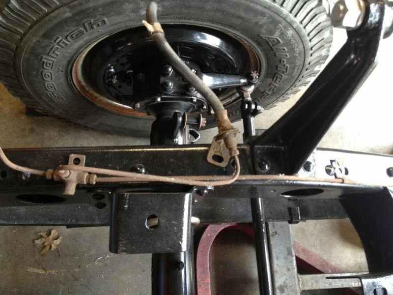

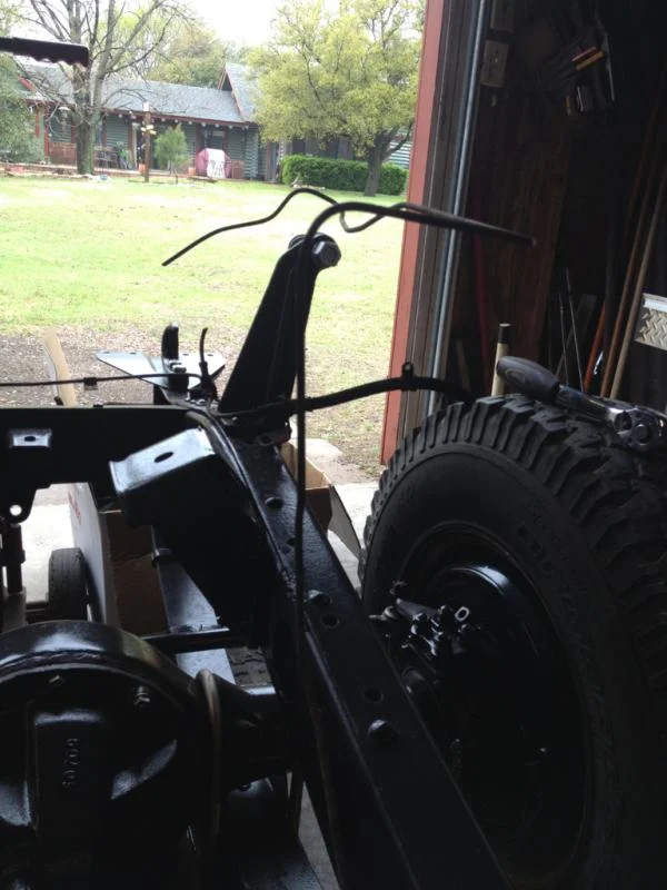

Speaking of remembering where stuff goes, I took the hard lines off assembled and hung them on the wall. That made life easier when I was trying to figure out where these parts go. I took pictures, too. Any experts out there that can catch anything before I bend the lines wrong?
Foresight tells me that if I bend the section flying over the passenger shock tower wrong, mounting fenders is going to be challenging. Any tips?

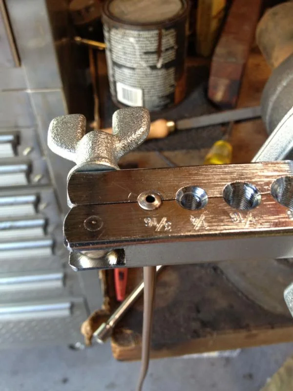

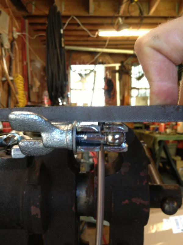

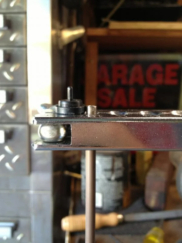

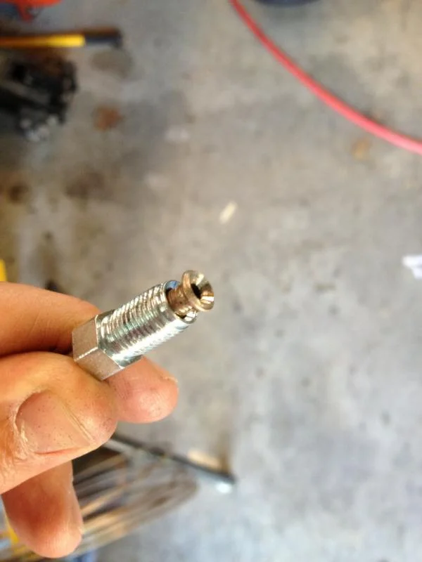

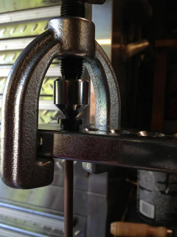

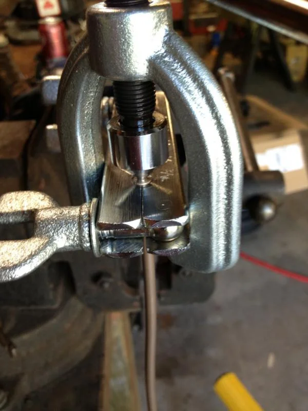

It has been a few weeks since I have given any real time to the Toyota. I rented the double flare tool from O'ReilleyZone (looks lightly used, a good sign) and watched a YouTube tutorial. Here's what I did:
Insert the line and use a file to de-burr and square up the end.
Bevel the outer rim of the line with a file just a bit. Bevel the inside edge with a 5/16 drill bit (only slightly). No pics.
Insert the line with the beveled side of the clamp facing up at a depth equal to the height of the shoulder on the double-flare bit.
Insert the bit and make the first press. Should have a bubble shape to it.
Here's the bubble I made on my first attempt. It looked ok to me. The tutorial I watched said to run the first flare (with the bit) down until the bit was flush on the clamp.
The second flare requires you to take the bit out. Use the cone and a drop of oil. The pressing motion should get the bubble to invert a little bit as the final flare takes shape. The tutorial I watched said that over tightening on this step would cause my line to crack, so I turned the bolt until I felt a natural jump in effort to continue.
Here's what my flares look like:

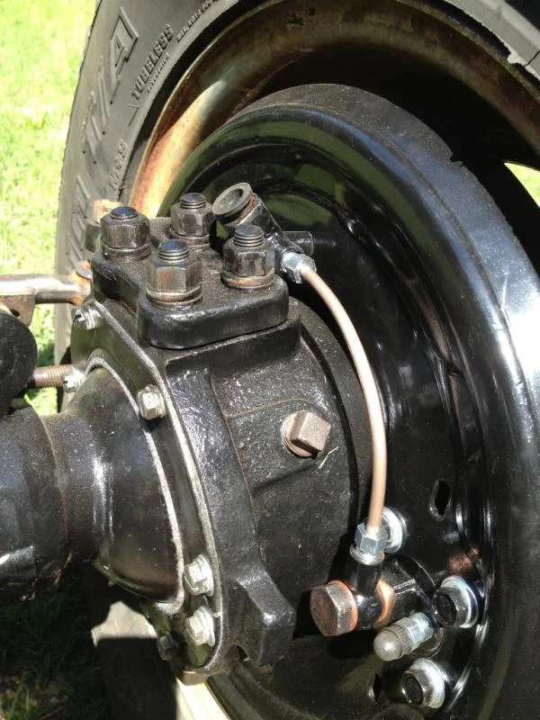

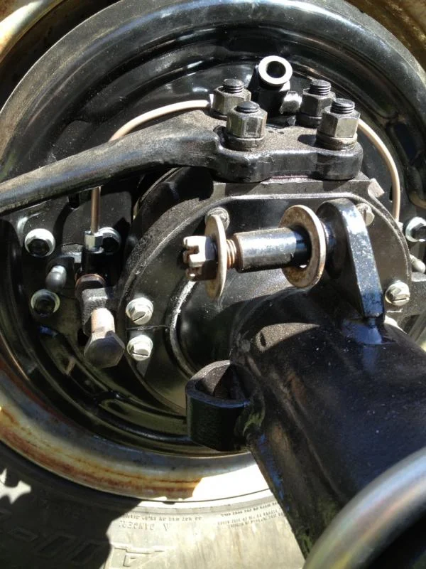

After the first flare seemed good to me (I hope it turns out to seal well), I started making the little jumpers for the front wheels. I had to to something while the spray paint dried on the rear slave cylinders.
What do you guys think?
Looks F'n perfect to me!
Its hard for me to tell from the pic and a VERY long time since I've worked on toyota drums (all mine are 4wheel disc) but in the second picture it looks like the adjuster is on the wrong end. It should be at the end with the hole so you can adjust the brake contact.
