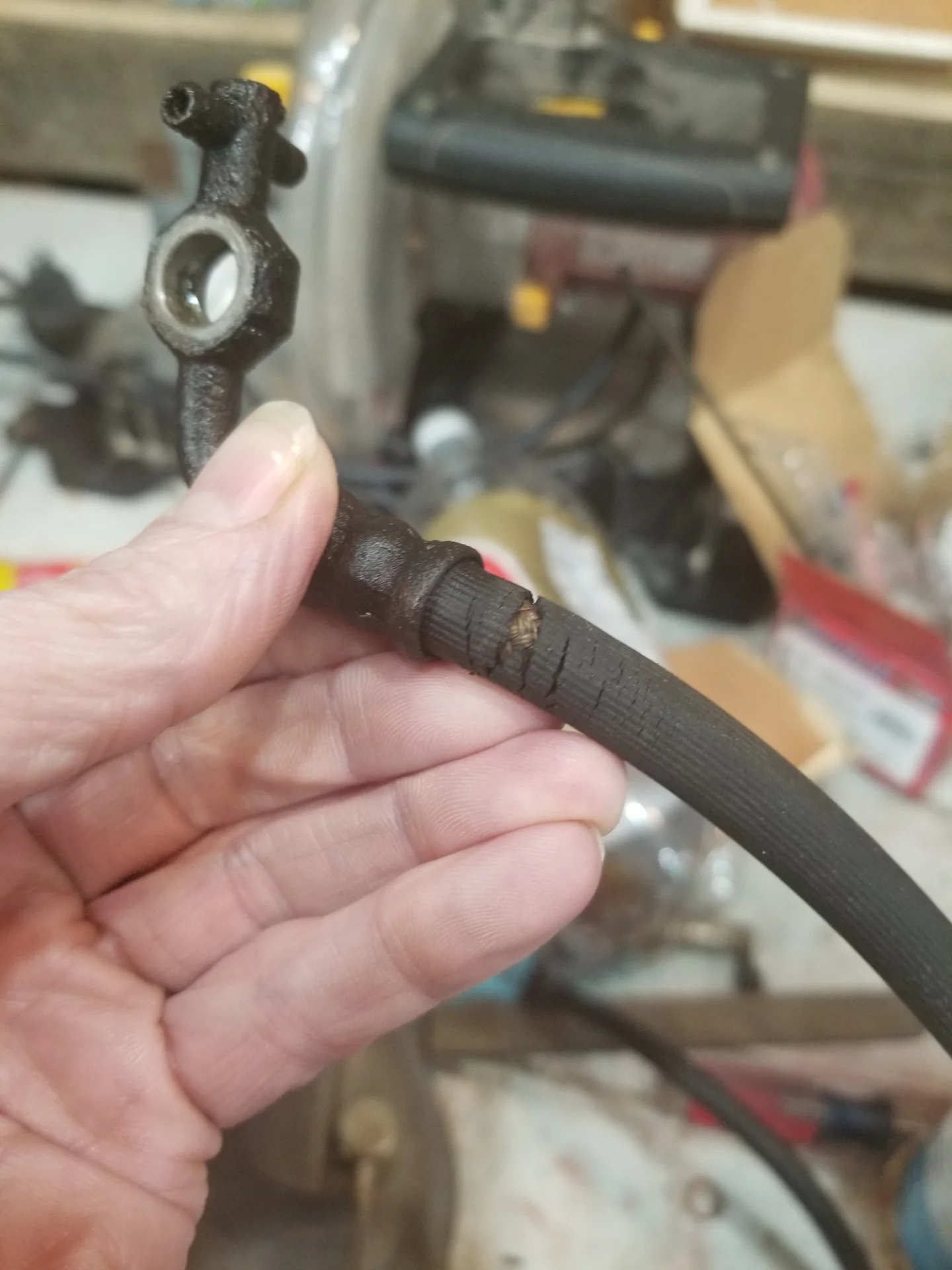

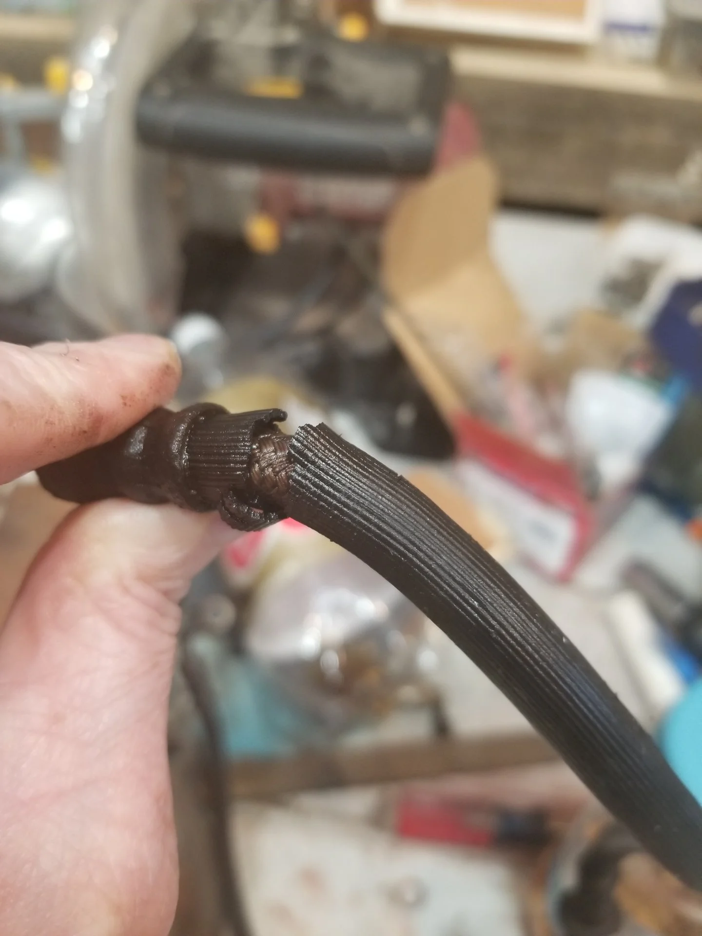

We replaced some soft lines on the fronts sides and found the outer rubber sheath on both sides on a couple lines was torn. the braided line inside was exposed. Not sure if that was the issue but they were replaced.

Here are a couple pics of the sheathing of the lines that were torn.

Did U replace "all" rubber brake lines?..the one you showed is toast, I bet the rest are bad as well...dont forget the axle to frame front hose and rear hose as well..
Did U replace "all" rubber brake lines?..the one you showed is toast, I bet the rest are bad as well...dont forget the axle to frame front hose and rear hose Not yet
Not yet. looking into getting all of them ordered, I cannot find a hose diagram anywhere to make sure that I am ordering the correct ones. Do you know if a diagram exists? I've looked at the FSM. No diagram. I have a Haynes cannot locate a diagram there either. Nothing to be found online. I just dont want to miss any of them.
