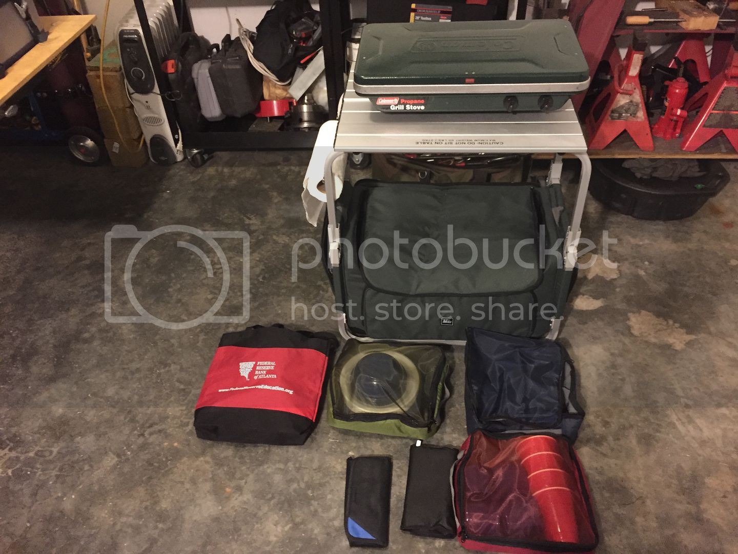

Initially I had planned to build a chuck box/ field kitchen (and would still like to), but I have not been satisfied with any of my mock ups to date. I stumbled upon this "camp pack & prep tote" from REI that is essentially a duffel bag with an external frame that doubles as the base for a roll top table. This is dimensionally exactly what I was looking for, offers plenty of storage, and allows me to cook away from the trailer. (This is a good thing as My cooking often leads to excessive smoke/messes)
Transport location
Deployed with contents (all items are in the bag in the first picture)
Red/black bag- cast iron skillet & small (solo cook set)
Green mesh bag - plates & bowls
Blue mesh bag - dry food storage
Black pouches- flatware
Red mesh bag-cups
If I need to carry more dry food I use a cheap canvas brief case that lies flat on top of all the other bags inside the duffel when closed.

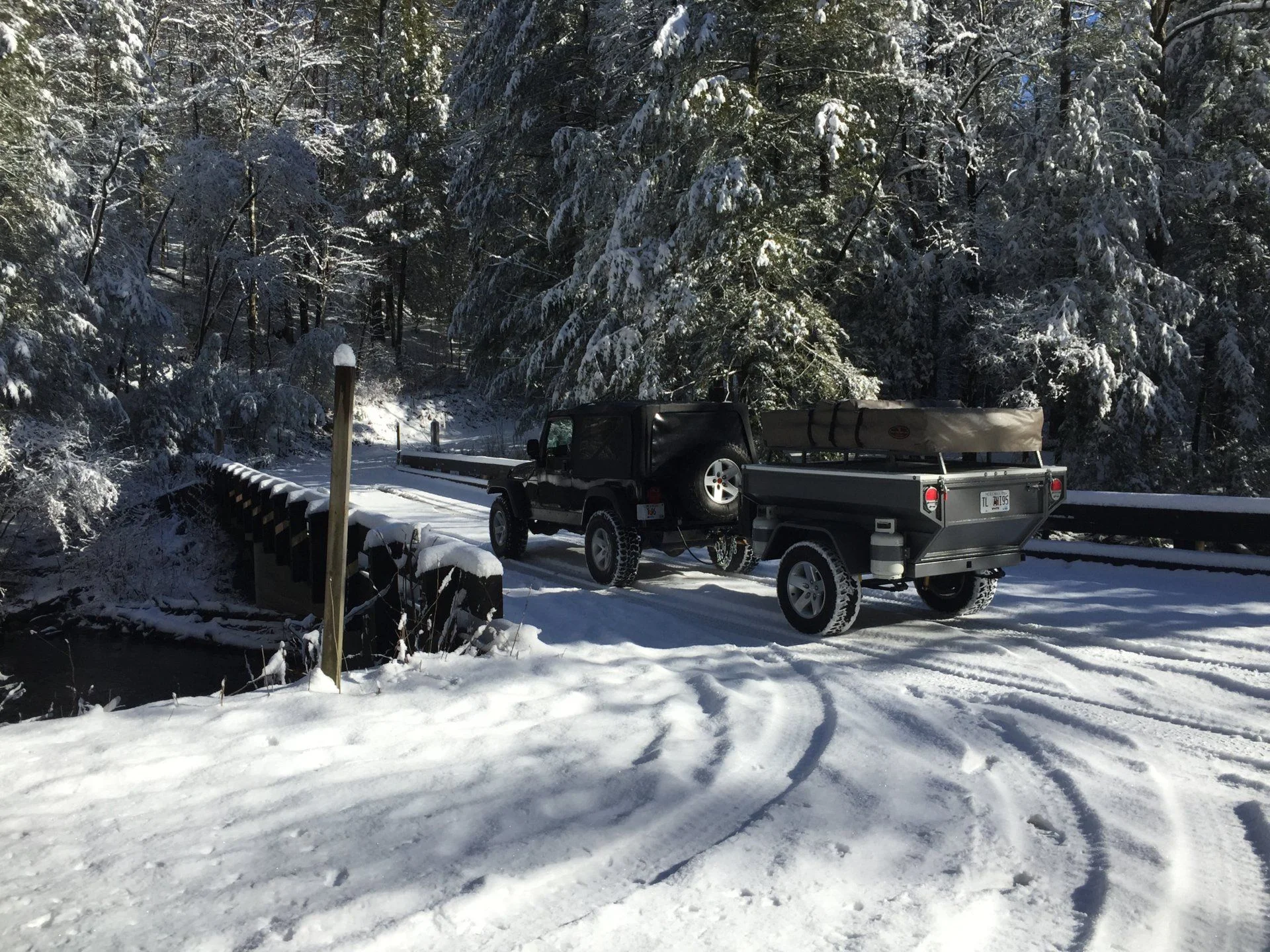

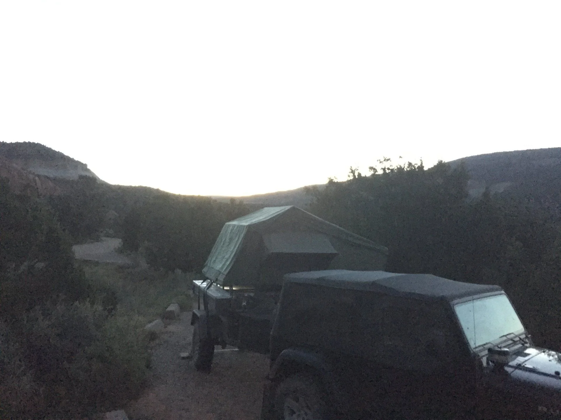

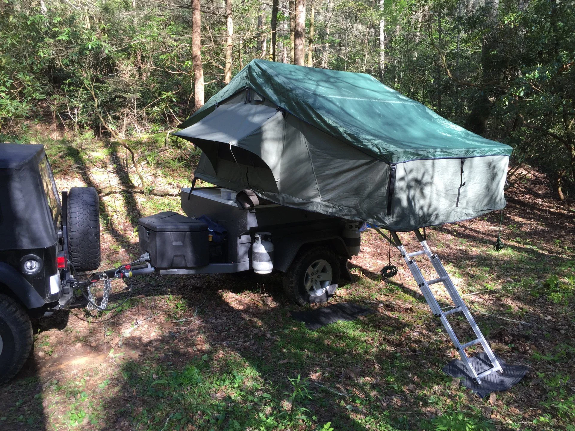

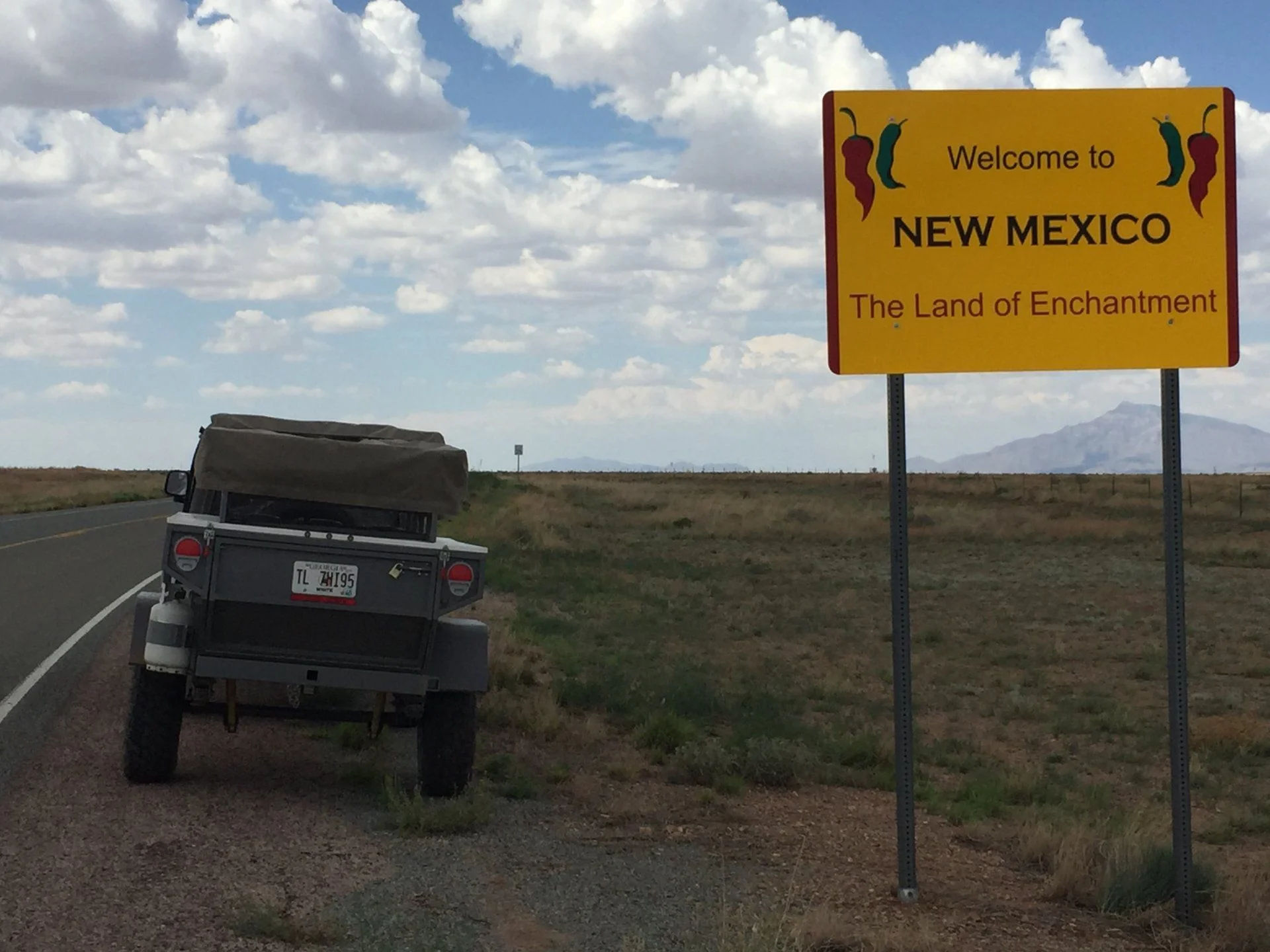

I have taken way fewer pics of the trailer while using it than while building it, but here are a few
Close to home in the
Chattahoochee Natuonal Forrest
Land between the lakes
Lewis & Clark State Park , Iowa
