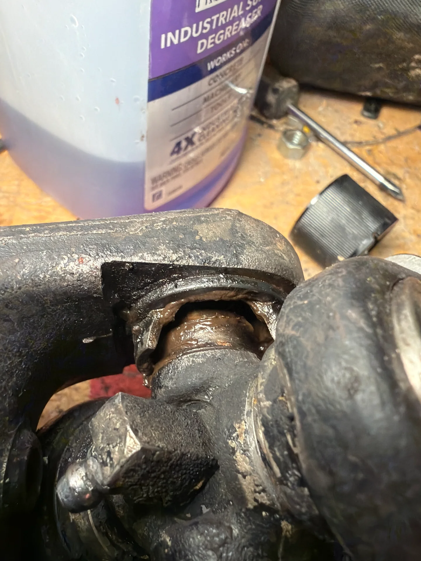

Sorry it has been a while. I took off the front drive shaft and looked like it was a bad u joint that had bound up so it felt tight until it was off. It sat for week or so then I cleaned it up and really looked at it. Turns out it doesn’t matter what shape the inside is in when it is being held by a broken shaft. See picture I hope. A new shaft is on its way.

Front drive shaft vibes were hidden by 2 things, my old mickey 35" MTs (new AT3s are much smoother) then finally added Slee Caster plates, which exasurbated the vibrations, which lead me to a Double Cardan requirement (still might be the case) but 75% of a functional U-Joint is most likely the main culprit.
Greased mine about a year back, maybe 1500 miles and it's now dry (lots of puddles and dirt), must have been on the opposite side for me to miss the giant missing cup section.
Great post, hopefully more find this and try a $75 u-joint before going down a rabbit hole like I was about to.
