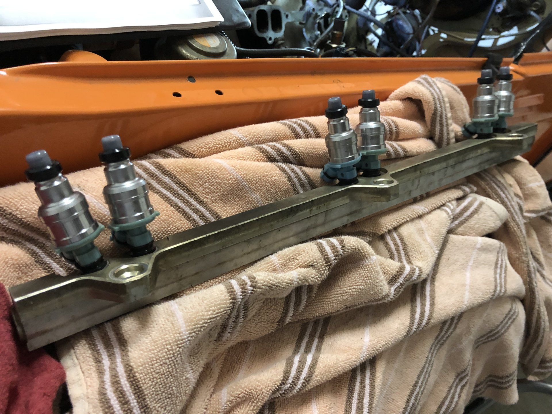

Got them cleaned and tested by WitchHunter. Came looking brand new!

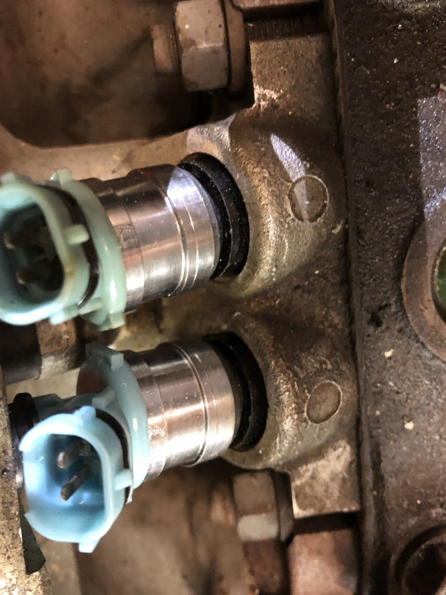

Got them installed in the fuel rail, and then seated into the spacer cups. I am hopeful it is correct...I am not sure how to verify they are seated correctly. I just followed the FSM instructions.
There is the slightest of gaps, but it is the same on all 6, so I’m thinking this isn’t an issue.
