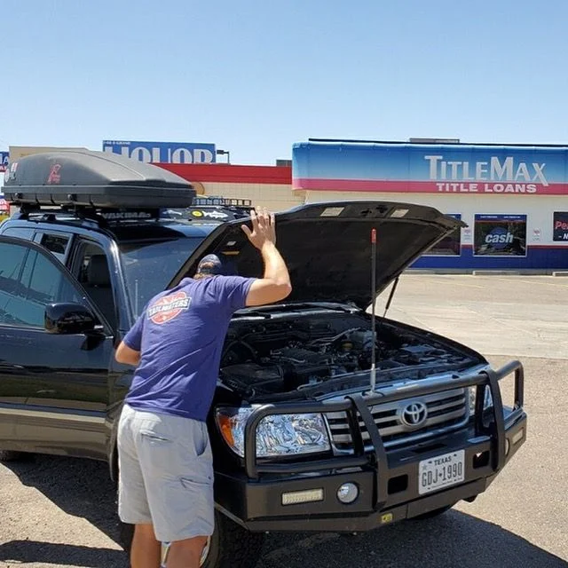

So the trip came and I loaded up and hit the road last Friday. I left Dallas at 7:00 AM and made it to Amarillo. Stopped for some Whataburger and went to get back on the road. Then it lost power and started sputtering and backfiring... lean. "come on baby give me a code..." she took a while to give a code but finally gave me P0171 and P0174 (bank one and two lean). I was rooting for a 300 code because i had a fresh batch of spare coils. But those were the only two. So we limped into a title max parking lot to do some research. Called a couple of shops that had looked at it and consulted the bowels of MUD for answers. Everyone was saying if those are the only two codes then its a MAF sensor. One guy told me i would get a voltage code if it was anything like a sensor or pump. So I called Street Toyota in Amarillo, confirmed they had a MAF sensor and called Uber. Got the part, put it in, and presto! Everything was good, right?

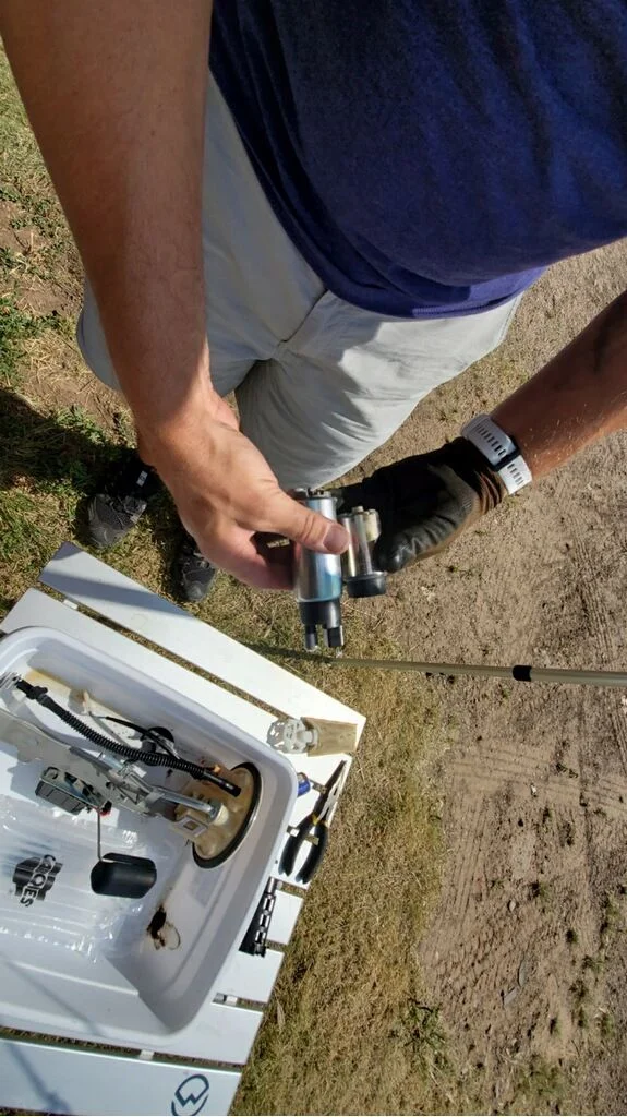

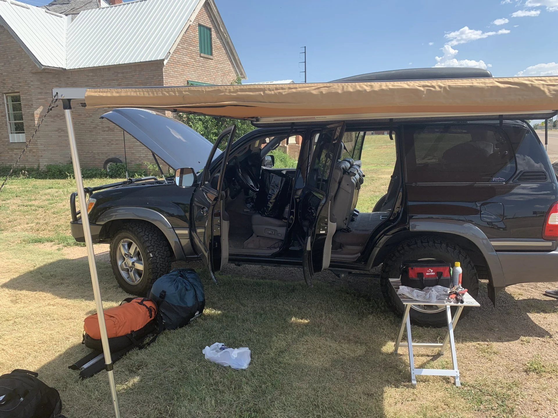

We pushed the car off the road and popped the awning to set up shop to replace the pump. The fuel pump is accessible under the rear seats. You have to take both out. There are several really good youtube videos on this. It is actually really easy to get to if you have a 14mm and 10mm socket, screwdriver and small torx. I was really pleased on the low banana job that went pretty quick to produce the pump assembly. Upon pulling it out of the tank I knew there was a problem. The aftermarket pump looked totally different. It was longer and had a different wiring harness. Apparently the 2006 and 2007 pumps are different. Pics to follow.

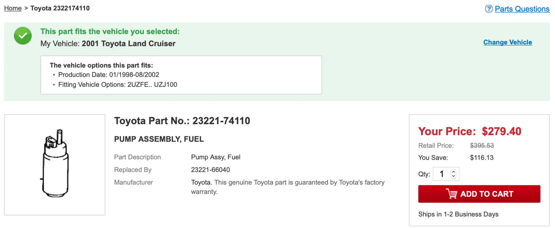

Not sure for 2007 model, but for future reference in a 2001LC: Toyota Part# 23221-74110 (replaced by 23221-66040) is about $280 but doesn't include other parts such as filters, clamps, etc.

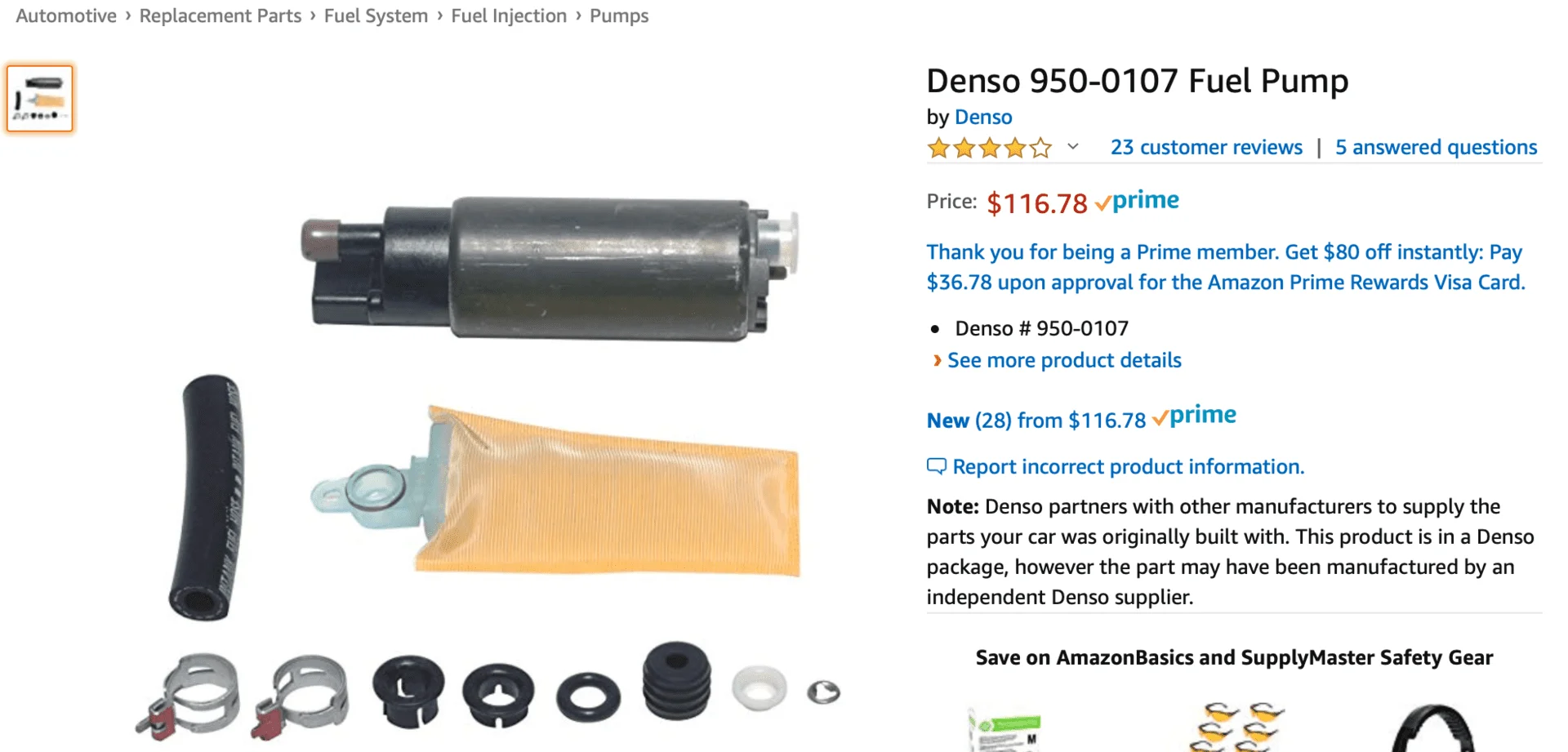

I also saw a Denso replacement kit with new rubber hose, clamps, filter, etc. and its only about $120. Part #Denso 950-0107. A youtube video watch from ThePracticalMechanic does a good job replacing it with Denso kit and it seems to fit like OE except the rubber hose.

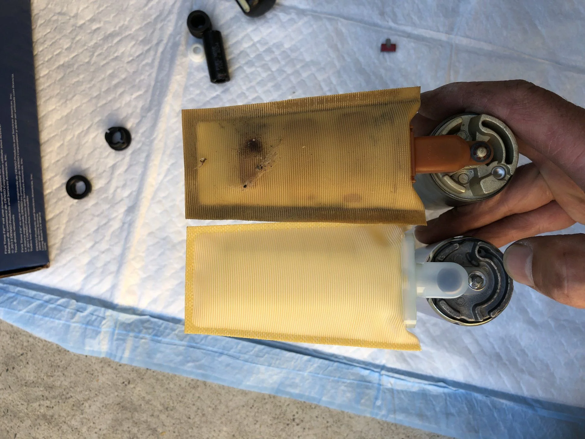

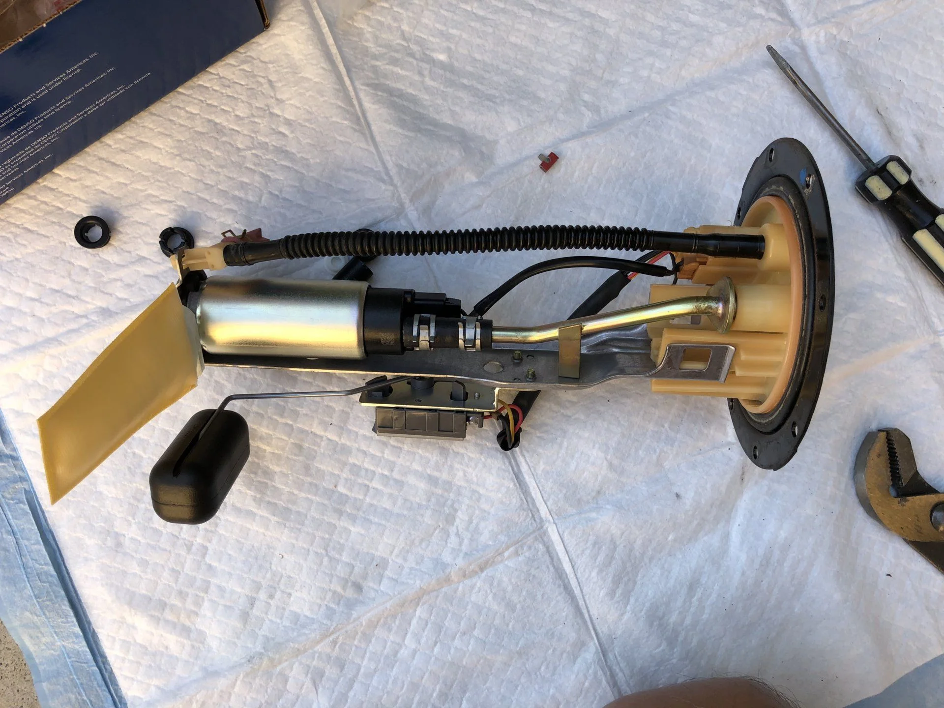

I ended replacing the fuel pump in my 2001 LC (178k miles) last night. Nothing wrong with the original pump but I had a new Denso pump (part #950-0107) and gasket in hand when I was troubleshooting a rough idle issue couple weeks ago. I figured I would do this as PM since my wife drives it right now and we take long road trips and I always end up losing spare parts and don’t want to mess it with for another 170k miles.
I’m not mechanically savvy and I would say it was really easy and simple. It took me less than 1 hour replace.

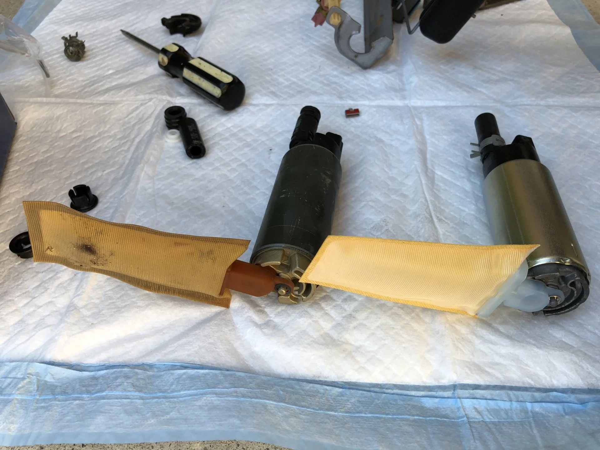

Here’s a comparison to OE and new Denso fuel pump

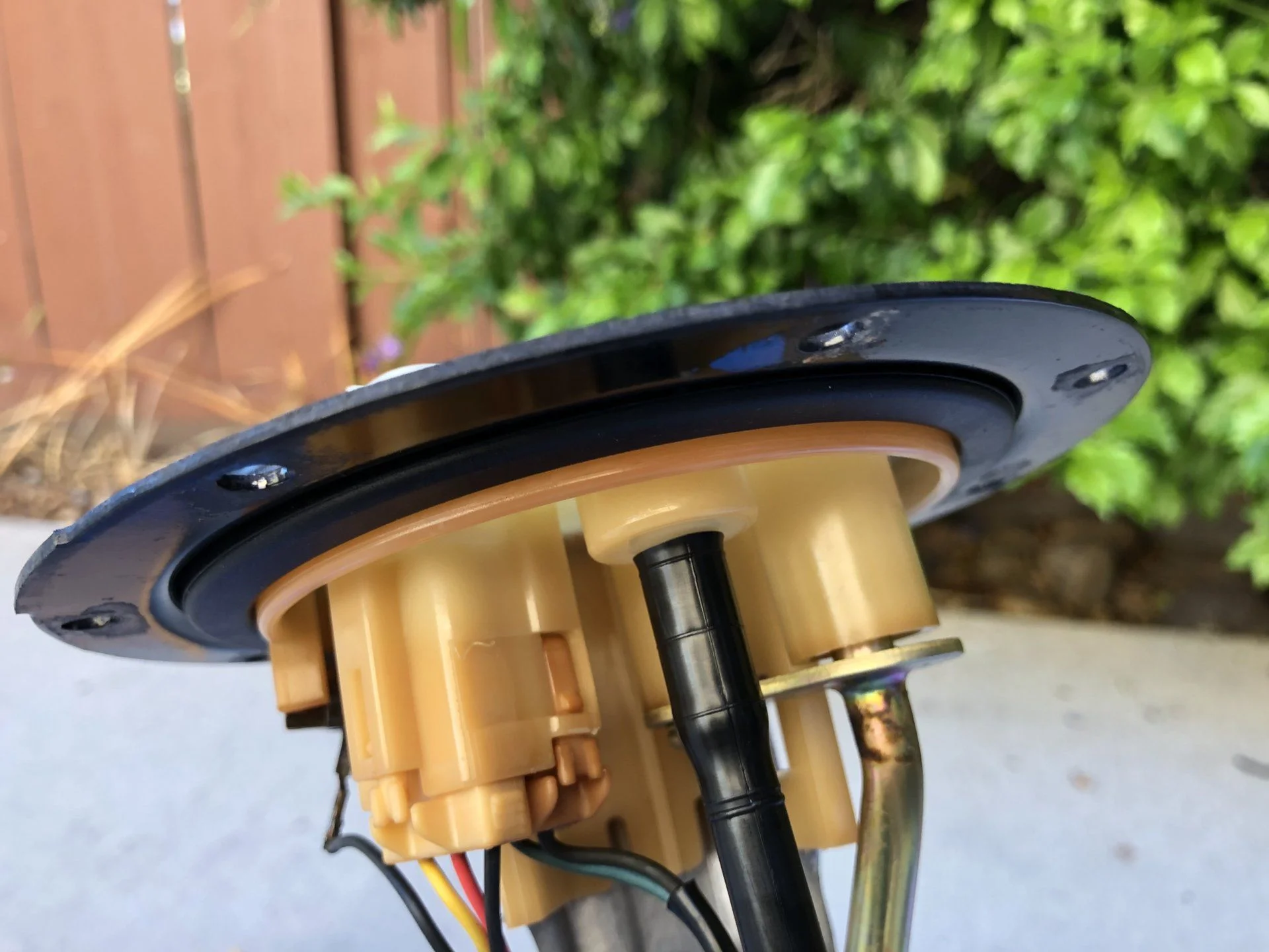

Here’s with new gasket
Full View of assembly
I guess some folks would say it’s waste of money/time to replace when it’s not broken but I say why not do some PM for piece of mind while I got the part, time, tools and not in a rush.
Anyway, just sharing some images and how simple it was to replace OE part with Denso Kit.

was the denso identical to OEM in height?
i messed up the quote... was the denso identical to OEM in height?
Also, what was the part # for the gasket?
