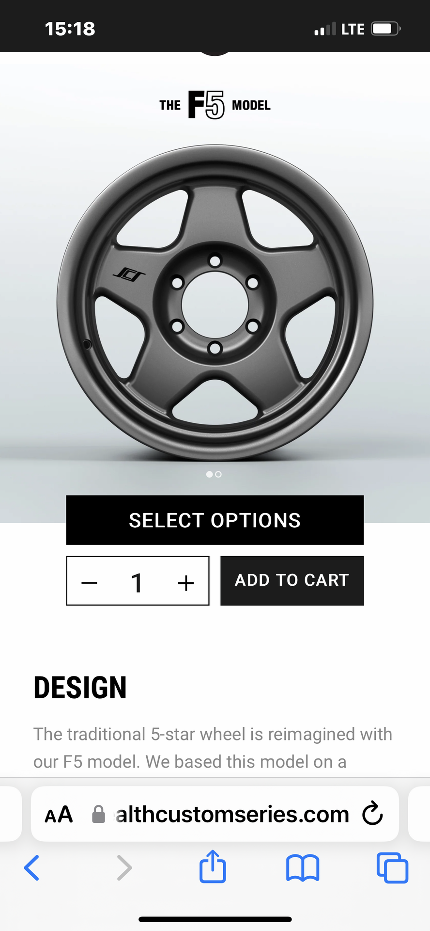

Anyone run these in the 16” with 3.5” backspacing on their 70 series?
