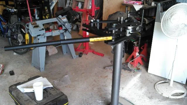

Ready to bend some pipe like a boss.
Just need some pipe:(
:clap: Nice looking. I see many happy hour building your jungle gym trugy. The nice part is the possibilities are endless on how to tie all the pipe, tubing together. :clap:
