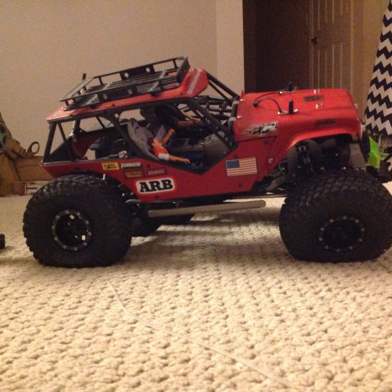

What 40 hood or body did you chop? I just picked up a Poison Spyder RTR and the jeep body must go ASAP. Was thinking I'd cut up a Tamiua body and graft it on much like you did.
It was a Proline Bushwhacker. Very similar to the Tamiya. I had to narrow the Wraith chassis at the dash bars to make it work.
