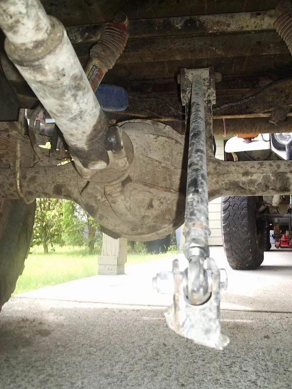

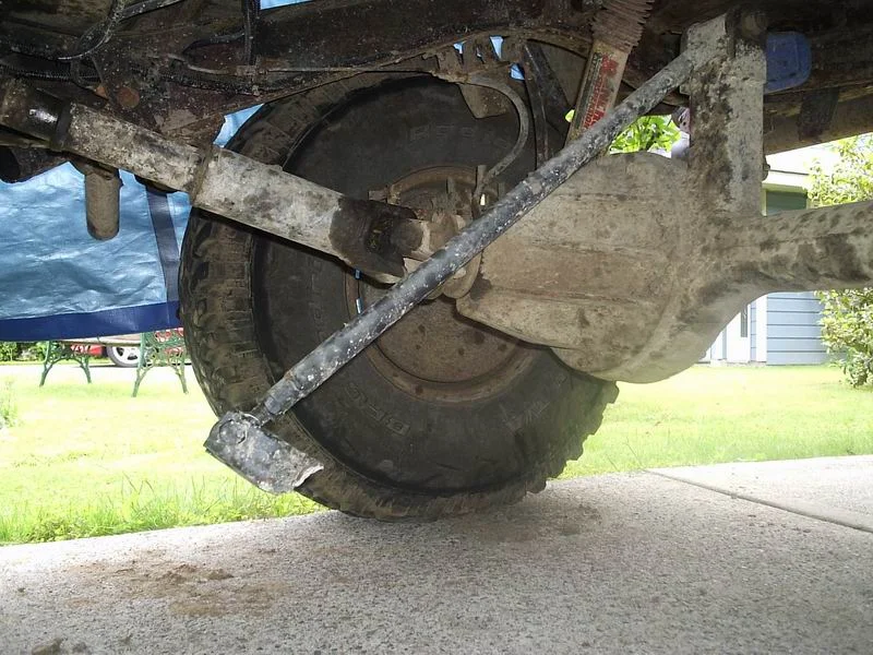

Well apparently I need some welding done before my next trip anywhere. I havent looked at the 40 since my last trip up Eagle. I just came home that night, thew a tarp over it and went to bed.
So while playing around with it today, bent down to air up my self deflating front tire, and....doh!

While deep in thought just now at work, so deep in fact that my screen saver had come on that features random pictures off my 'puter, one of my poser shots from that Eagle Ridge trip pops up.
I can plainly see the broken traction bar dangling away in it. I didnt take the pic's, otherwise I would have noticed it right away. So there goes my theory that I tore it loose while yarding that Blazer thru the bypass.
It's rather amazing it didnt catch any low flying objects the rest of the day.

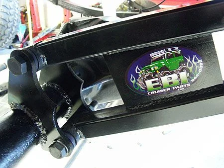

sorry, I looked at it again
it's a plow for the wife's flower beds

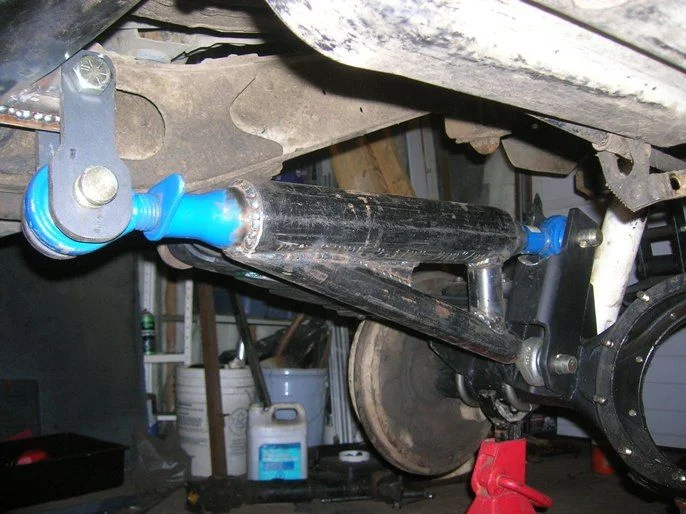

Or go Overkill like me!
I don't quite understand that design. It has that 4th pivot point at the shackle that would still let the axle move forward and wrap the springs?
