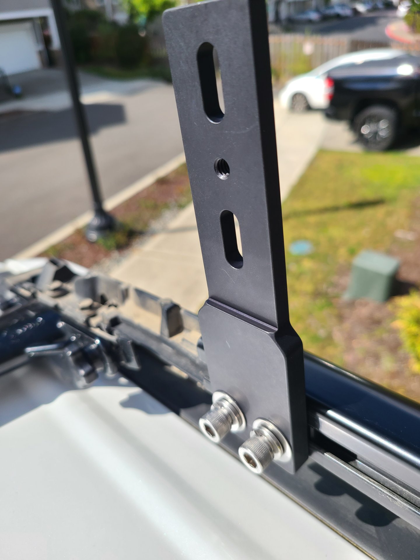

I do. But I have DIY brackets. Works great. 4 bolts on 2 brackets. Instal under 2 min

@DirtyPepper May help to post in the 80 section then. You don't need to buy anything else to get your awning mounted.
Your rack comes with L brackets that are pretty sturdy. They're long enough to attach to your OE stock crossbars by way of rivnuts drilled into said crossbars. That's about the simplest way to attach your awning with only the cost of the rivnuts and fastening hardware (<$20).
