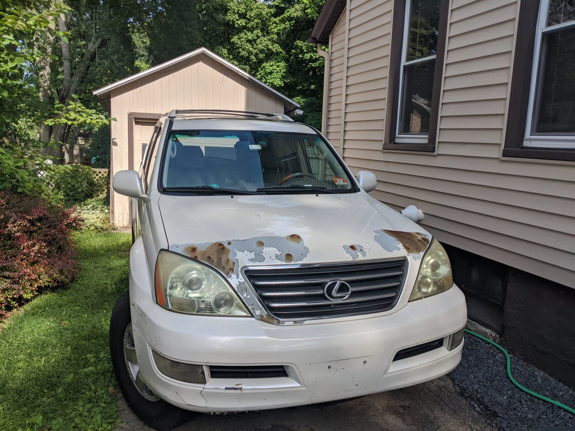

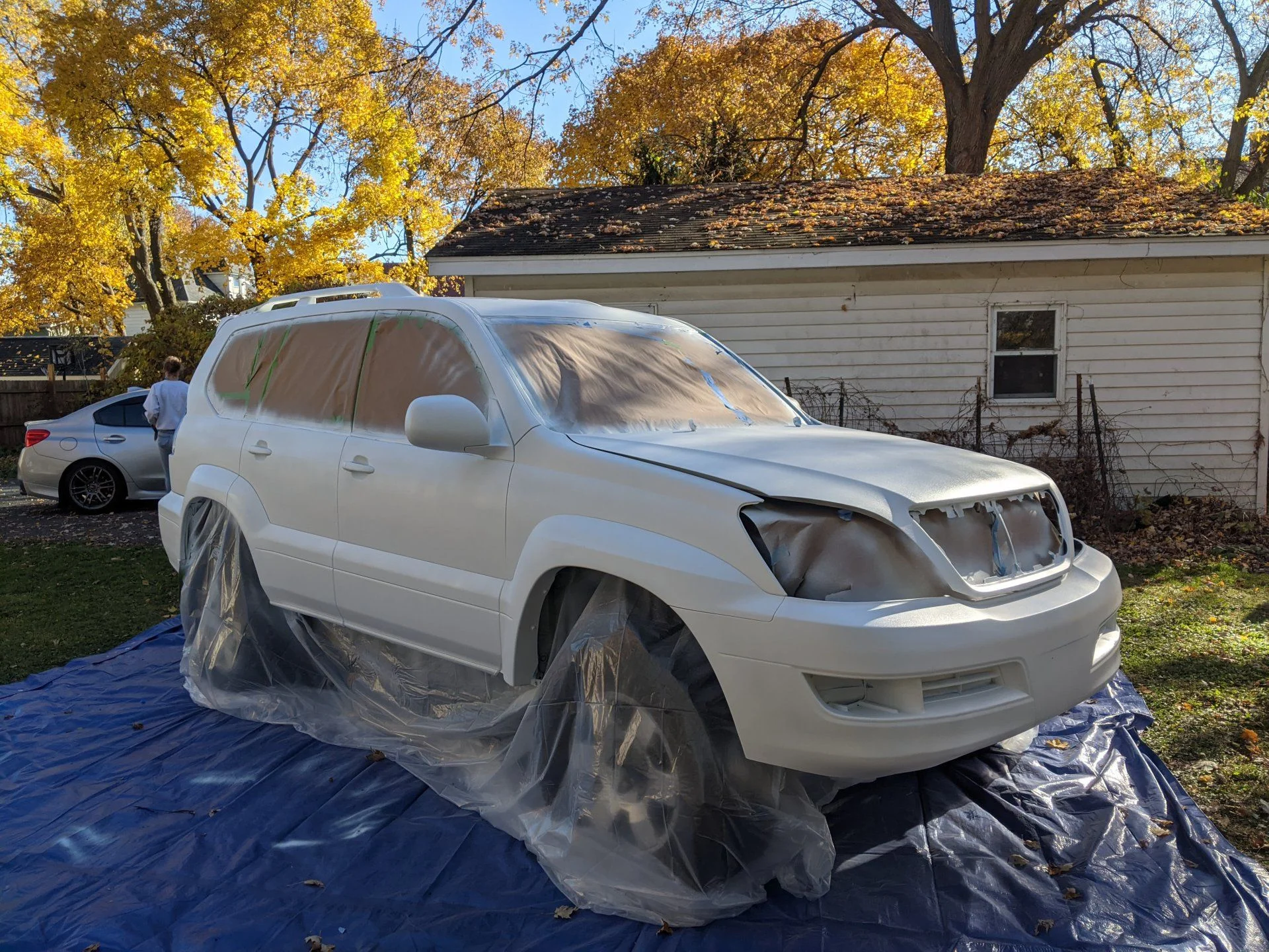

I found this abused NJ-owned 04 and it was a disaster. Ended up sanding a Lot but after Bedlining ($400 in supplies, $60 to rent a large air compressor, and 3 days to prep, tape, and paint) it white I'm super happy with it. Door jams fade super well and just hose it clean at the end of the day.
Dude, that looks great! Have you done that before, or did you pull that off your first try?
The closest thing to doing this was when I Plasti-dipped my old Impreza with a paint gun. A lot more prep work for the liner to come out good but only watched youtube videos to prepare. If your paint is going I see little reason to not do this for what most people are using these trucks for. It's so nice to never have to worry about the paint.
agree. if i wanted a show car, i wouldn't drive a gx. maybe it's my inner redneck, but i kinda dig the bedline look when it's done well. glad to hear the spraying isn't too bad. figured prep would be a lot - always is with any kind of painting.
