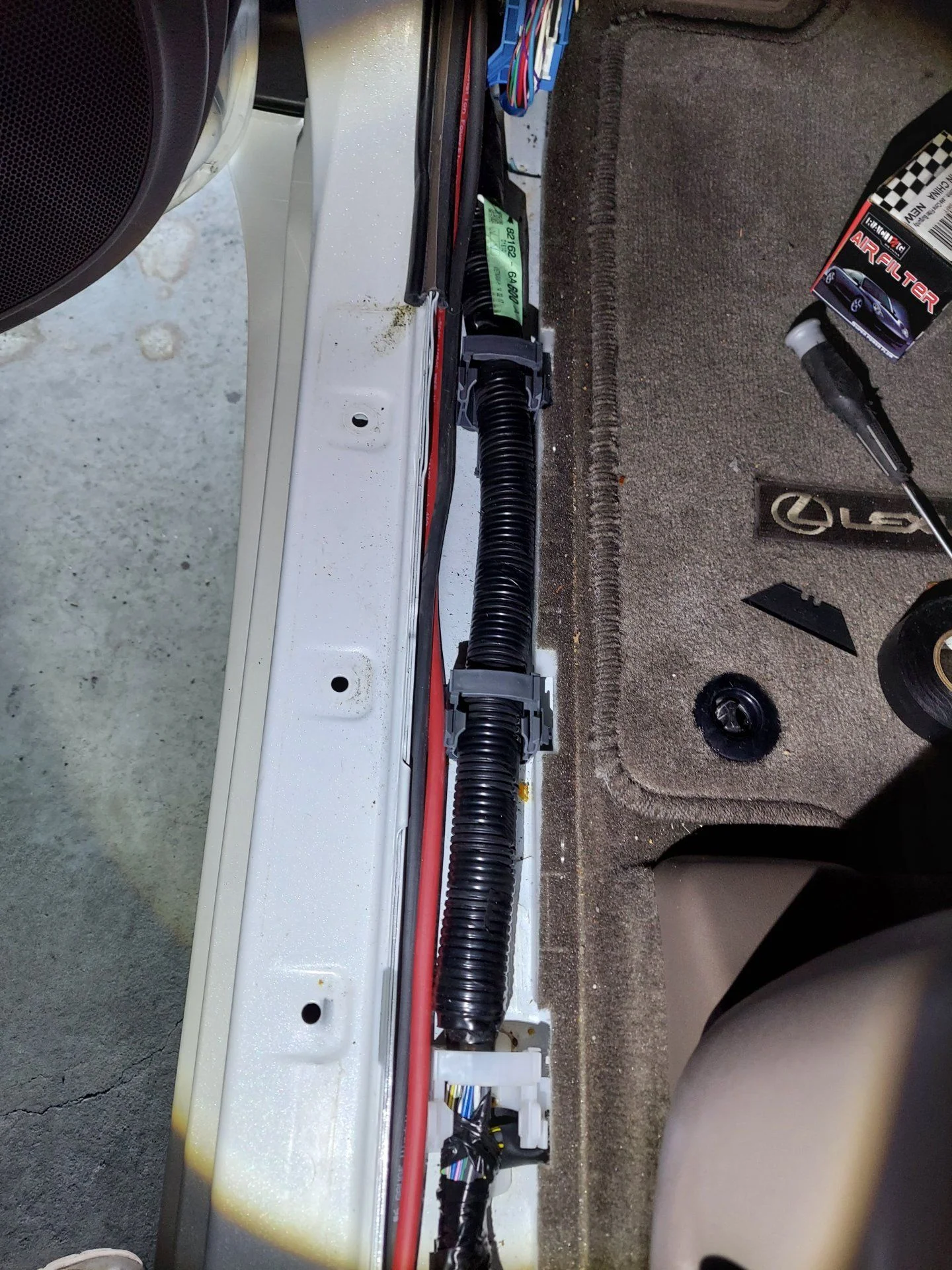

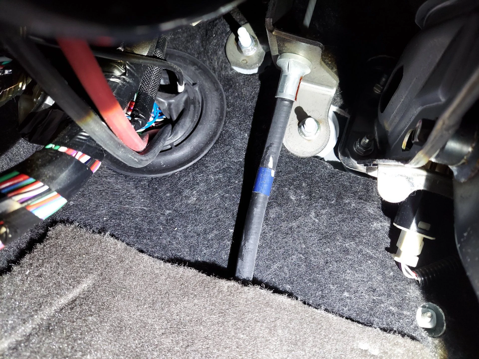

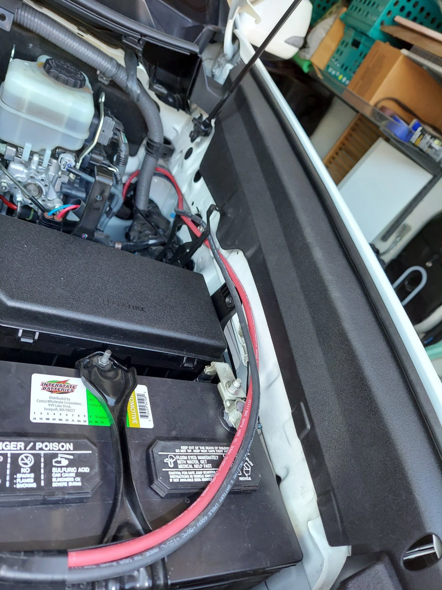

To close out this thread, we determined there is no good alternative 12v wiring that exists in the in the rear cargo area of a 2014+ base or premium model. The Luxury model can use the 12v wiring for the 3rd row seats.
I ended up dragging 6awg wire from the starter batt through the existing firewall grommet and along the sills, after unclipping the plastic. Hopefully, the pics explain better.
I am going to setup a distribution board that, hopefully, can sit inside the cavity between the rear side plastic and the wheel well quarter panel. I am going to put it split conduit in the engine bay but leave it open in the sill channel.
