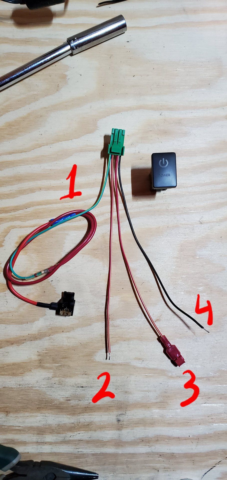

Wiring the switch:
I know this is an older thread, but what is that green plug, and what is that connecting to?
The green plug comes with the switch and it plugs in the back of it.

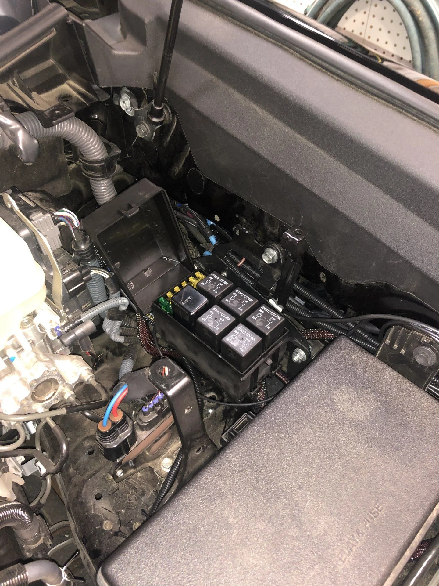

Under the hood:

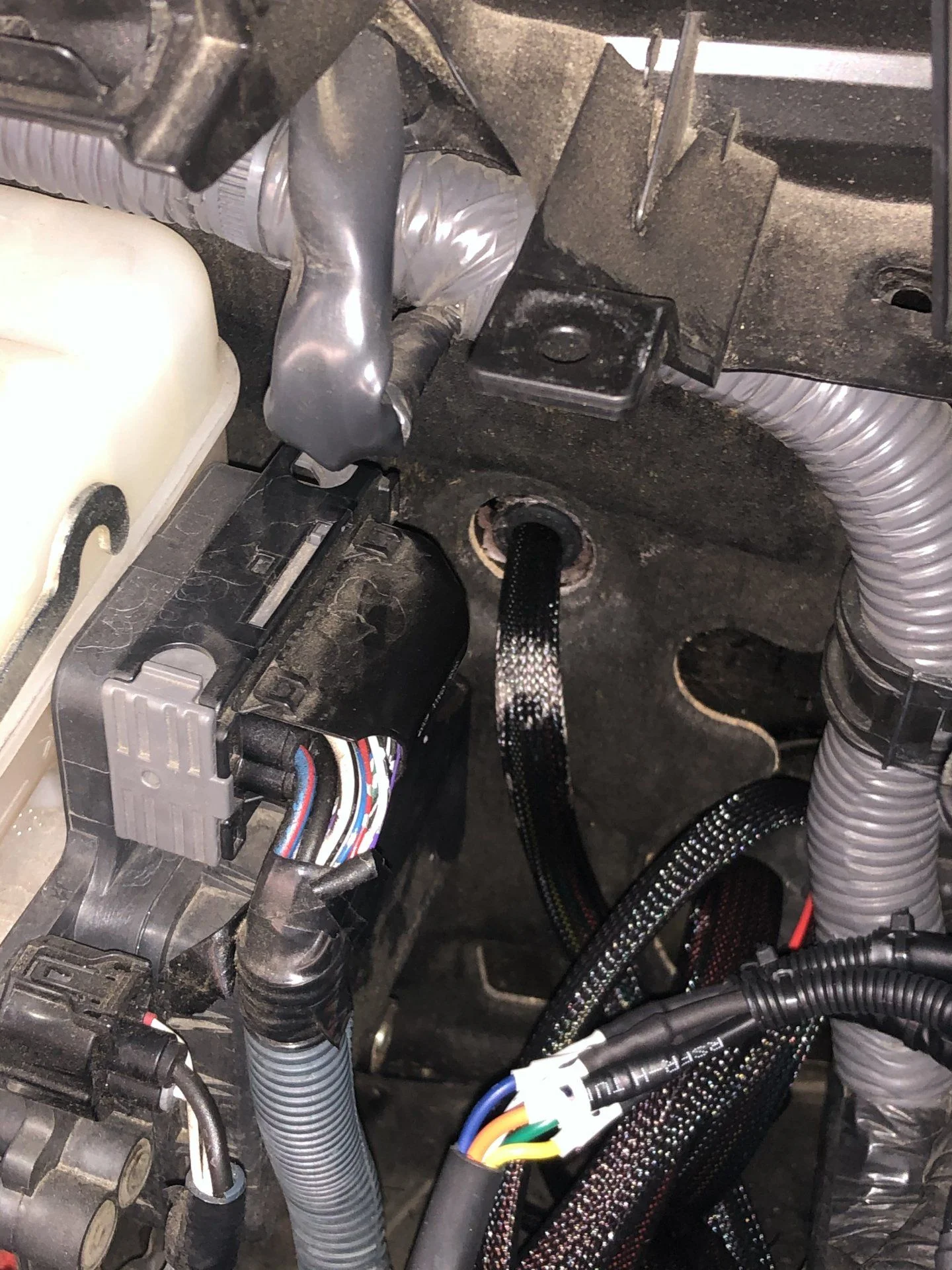

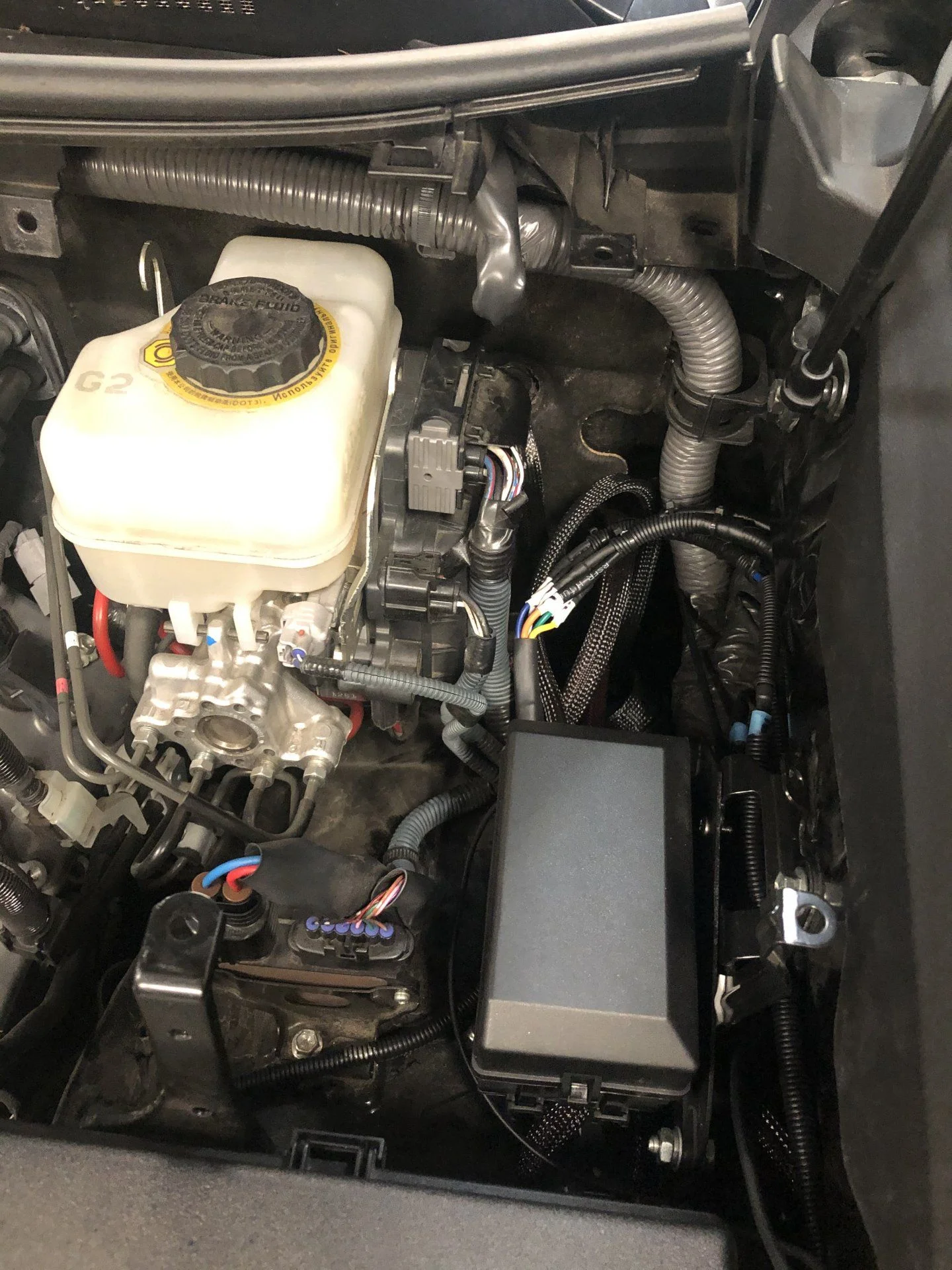

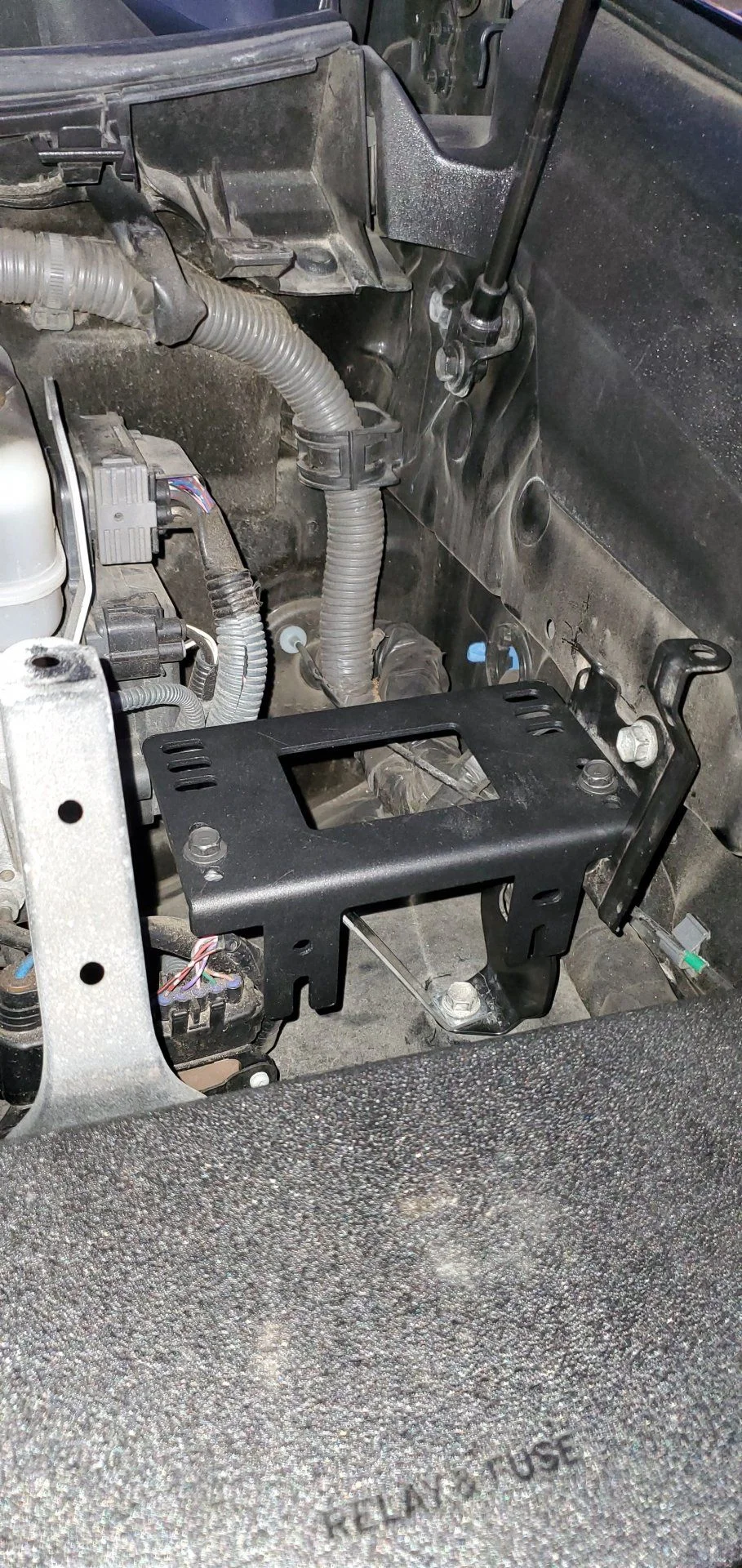

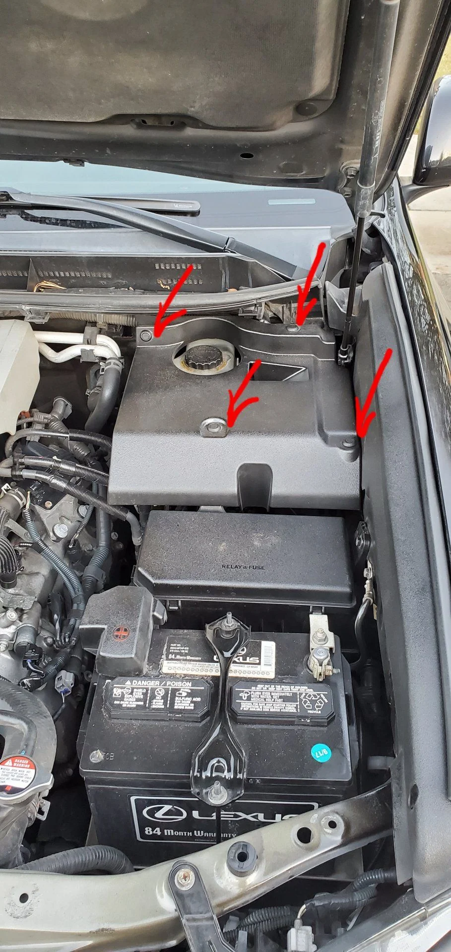

I found the best location for the Fuse/Terminal box in Under this cover. Which is removable by 4 plastic clips that like to jump around and get lost. As you will see in the final picture, this location keeps all the wiring rats nests hidden and somewhat protected.

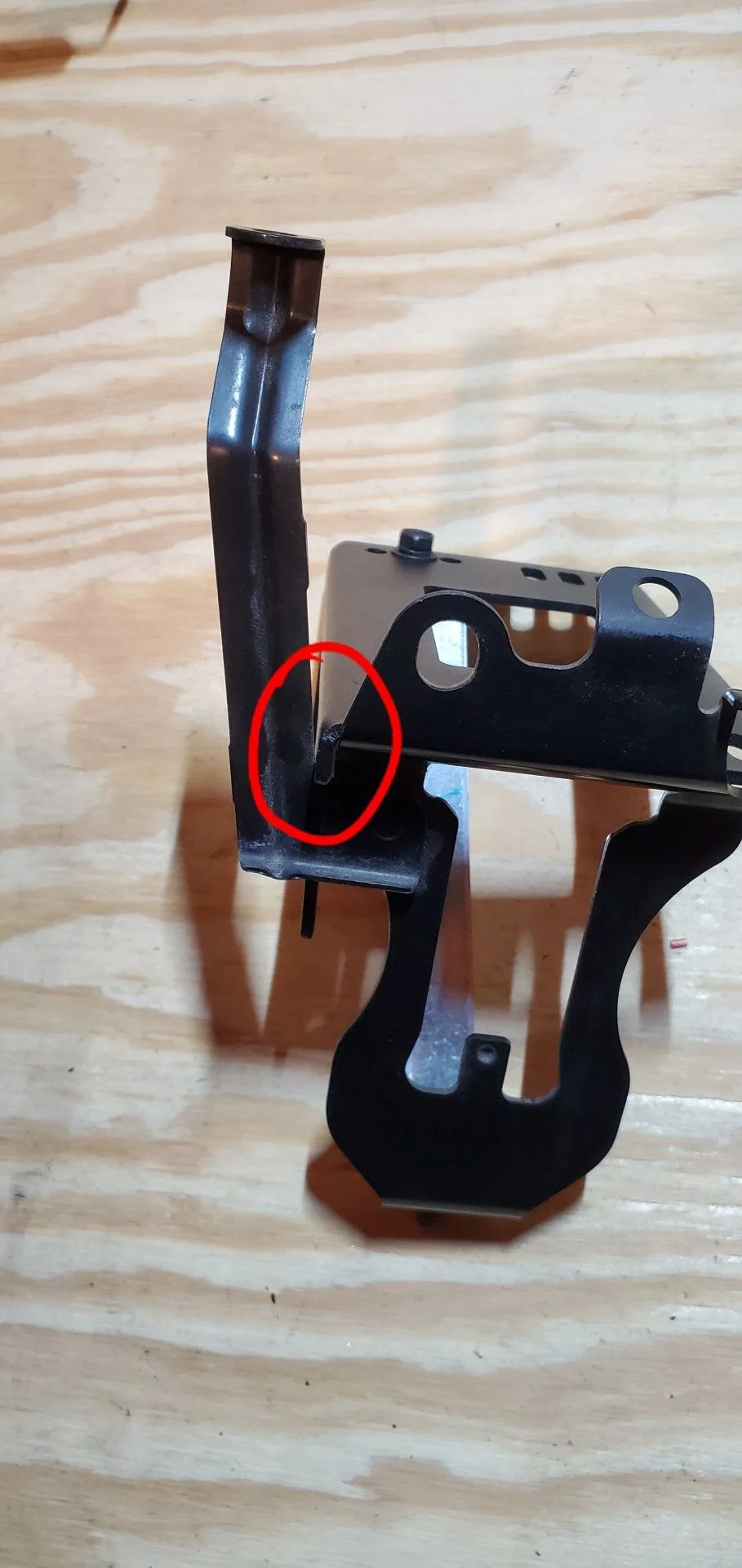

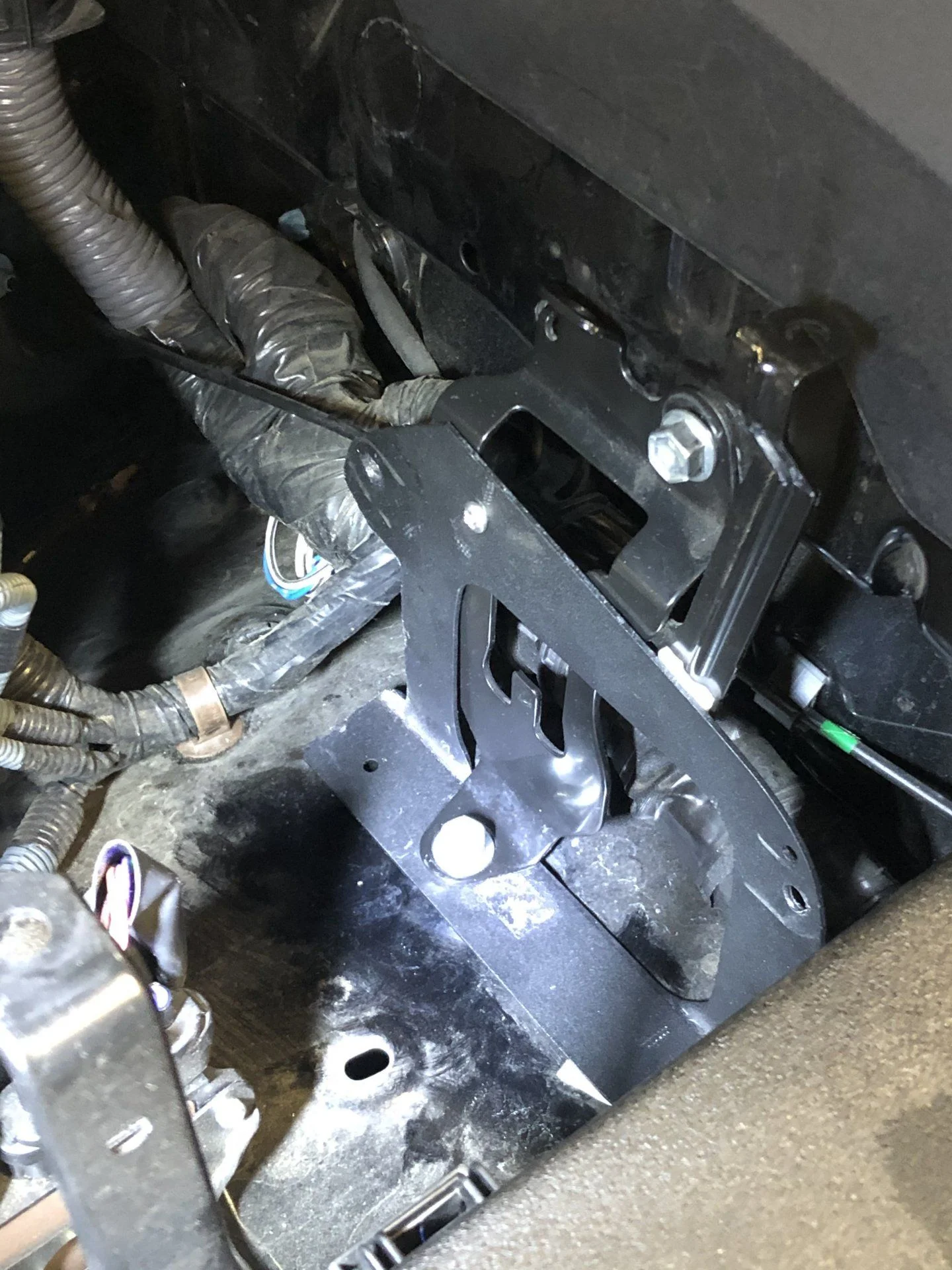

I will be mounting the cradle that was supplied with the switch panel to this bracket.
I made a little bracket out of Aluminum to support the other side of the cradle.
Cradle has a little lip that will get perfectly sandwiched in a little grove on OE bracket.
I then Installed the bracket assembly back using the 2, 12mm bolts.
