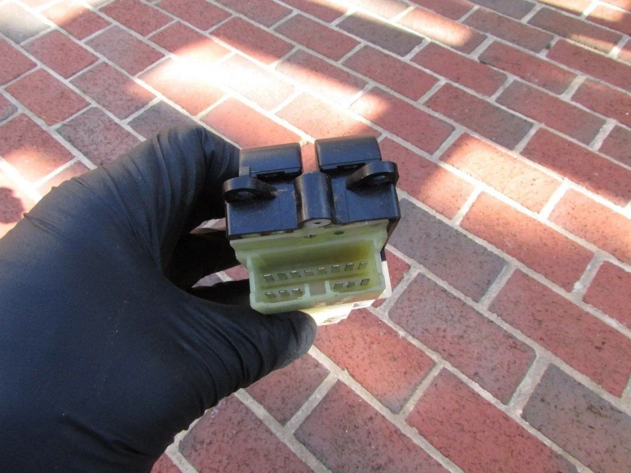

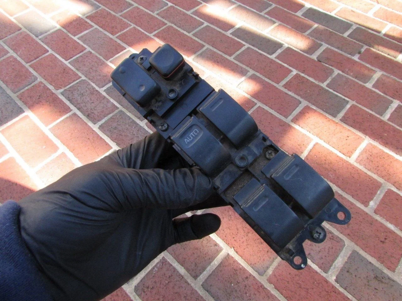

Has Anyone Notice or Have Converted our regular AUTO DS Master to a AUTO DS & PS .
Here are some pix for comparison and maybe some feedback or suggestions on how to get it done?

I don't think that thread addresses the passenger side.
The stock switch assembly can only be modified to auto up the DS window. The switch assembly with the ability to auto control both front windows is a likely candidate as a swap assembly to add that feature to our trucks.
Anyone with a part number or know what vehicle it came out of?
My 99 4Runner has ds and ps auto down, but not up.
I have one out of a '99 4runner I've been saving for this. It sure feels like it has auto up, but I never tested it.
Now that I think about the 4Runner does both. (Up and down) and label on the switch like the pic above.

Going to reach out to the new owner for a pic of the assembly.
My last 80 had auto up/down on all 4 windows from the drivers control. It was incredibly handy.

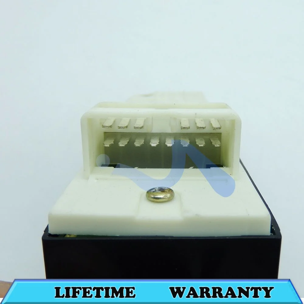

Did anyone ever try one of these other switches?
