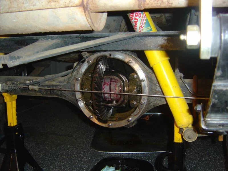

Have been half searching for an Aussie Locker for the 40 after reading good reviews here on the tech board for a decent inexpensive auto-locker. Last week, found a deal on a "gently used" Aussie Locker and differential assembly from a guy here locally on craigslist who was upgrading from his current set-up.
Got around to installing it the other night, and it really was a very easy install. It's a pretty simple design, and despite my 1-
mechanical skill level, was able to knock it out in a couple hours.

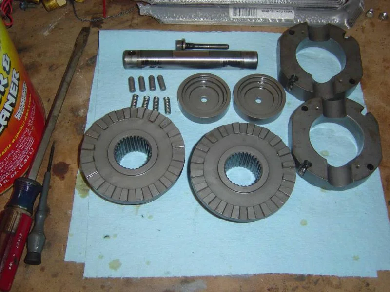

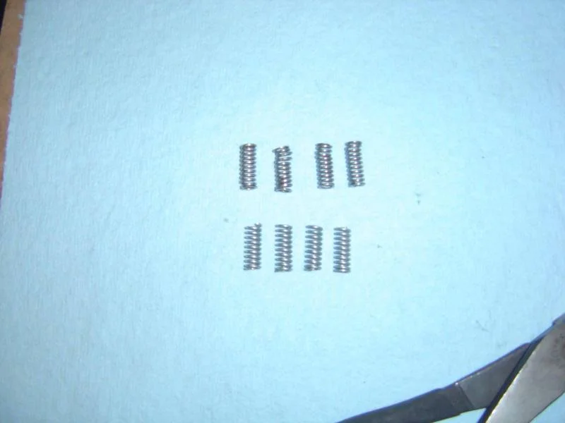

2. - Disassembled the locker assembly and cleaned the parts:

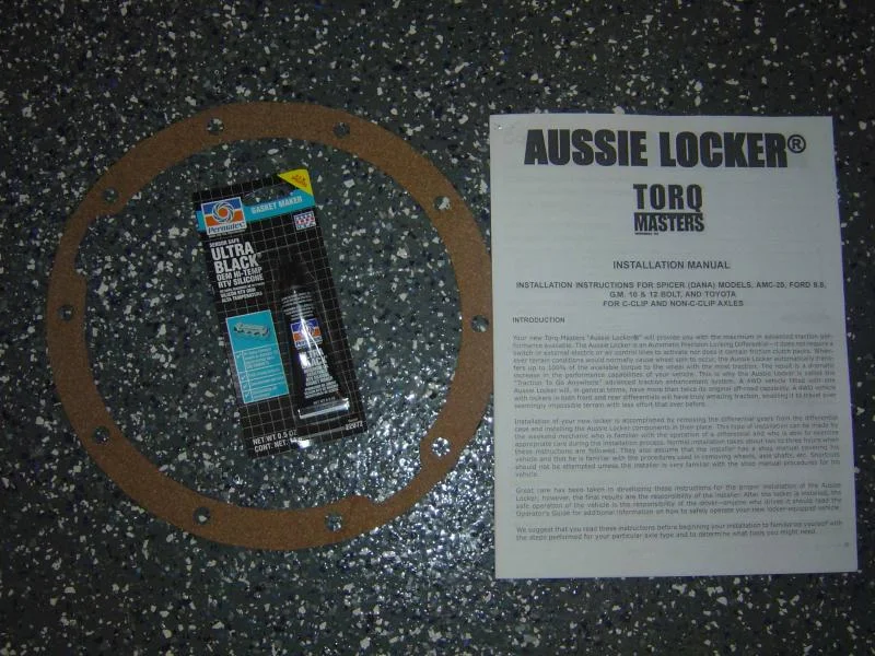

3. - Downloaded the manual from aussielocker.com, new diff cover gasket, and some RTV:
