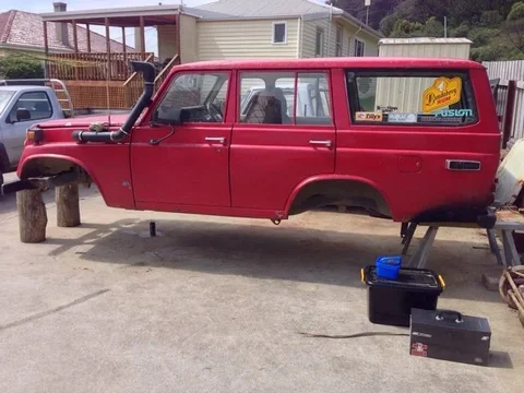

unfortunately we forgot to paint the dash or cover it from overspray before windows and headliner went in but we sorted it I've only just realised I should of made hole bigger for stereo but that is skipping a fair way forward

Looks like mine could do with your touch haha feel abit ashamed as im not going to this sorta effort with mine, i brought it as a wood hooking bus and something i could also have a good thrash on the weekend with.
Yeah I'm going to be too scared to drive it it will be my toorak tractor for a while would like to build a tuff ute and put the diesel in as panel damage is pretty common on the tracks around herebut we've got the shorty jackaroo for our mud rush at the moment
