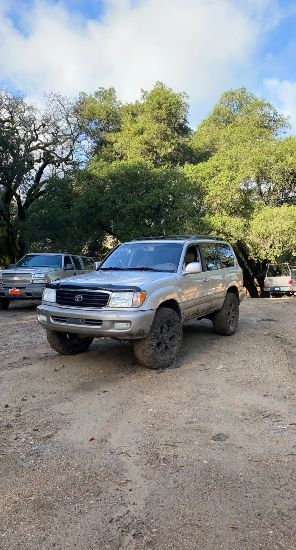

Hey guys I have an 01 lc and for the life of me can not get the tires to slip on anything. It def feels like 4wd is being engaged but still haven’t heard the atrac “beep” or seen the light. I know the light works because it comes on when I start the truck but my question is aside from crawling up a mountain are there any surefire ways to test my atrac system or trigger it manually? I want to know that it works so I don’t have to find out the hard way. Thanks boys.

Just because I took it up a few steep muddy slopes today in hopes of getting the system to trigger and not even a light comes on? Does it need to be in low? I’m wondering how it works for the rest of you ? When do you typically see the active trac light come on? Does it have to be a very significant slip? Are there any reasons why it wouldn’t go on? I have def heard vsc beep when taking a tight turn at high speed but still haven’t seen the atrac light ever come on aside from start up.
Atrac won't beep unless the system is overheating iirc. I don't recall the light coming on but i can definately tell when it's working. Usually in muddy or snowy conditions. You'll start spinning a tire and you'll feel it engage and kinda pull you forward in an almost jerky kinda way. It seems kinda slow to kick in at first but then it keeps alternating as wheels slip until you get through. You have to give it even consistent throttle or it doesn't work so well. There's a great thread on mud on how to use atrac. Includes videos.

Honestly Sounds like you haven’t really put it on anything difficult yet. You have big all terrains and If all four tires have traction then atrac won’t come on. If you don’t hear the fast clicking then it’s not difficult enough. You need to find a rutted dirt road and really try to get stuck. Now, If you’re in spots where tires are spinning and no light or clicky clacky from atrac, then you have a problem. My truck never engages atrac unless we are on harder trails. Fire roads won’t do it.

I’m going to try & put this thing in a ****ing lake tomorrow if I can and if atrac doesn’t engage then I don’t know what will😂I’ve been pleasantly surprised with these cars as I took it out and threw a few rocky/muddy s*** water crossings and did experience the “jerky” kind of pull a few runs but didn’t get the light to come on maybe it wasn’t slipping long enough.

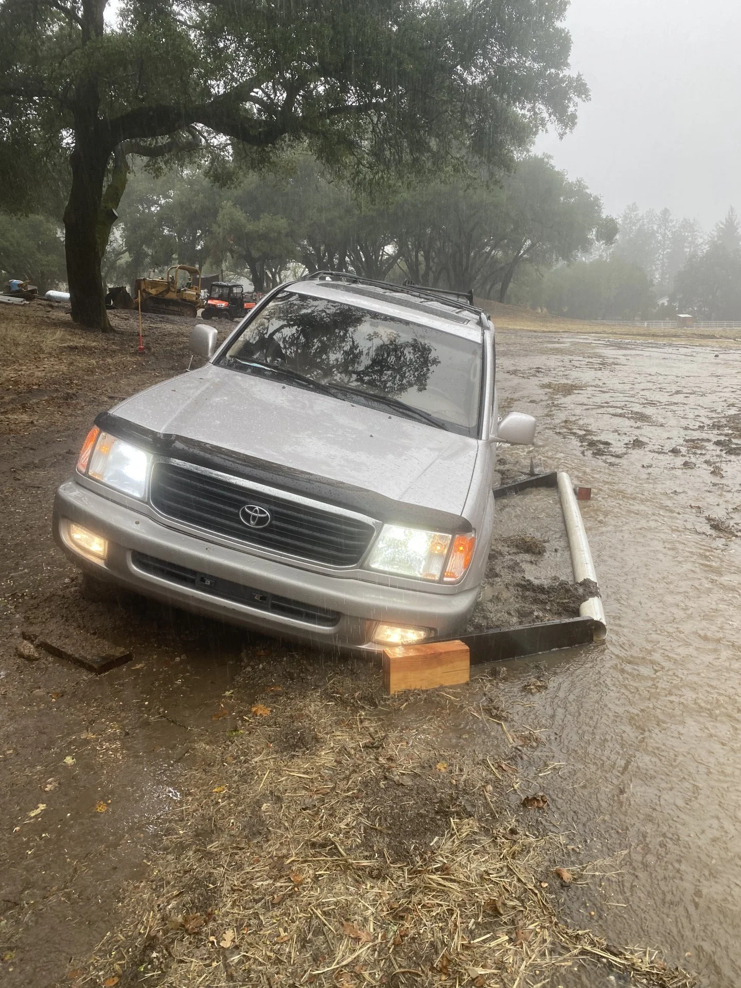

It is , only way I Got it to engage was when I buried it to the frame in mud 😂 atrac didn’t do much here but I found out it works👍🏽
