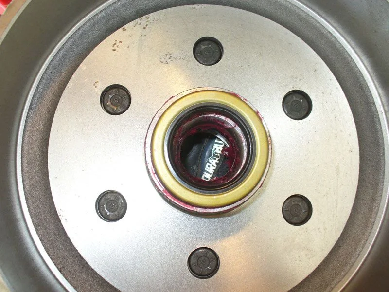

I went to a local trailer shop and bought a 10" Dexter Toyota Hub with the bearings and seals.
You can re-use the existing bearings, but need to replace the inner seal. The new bearings were fairly in-expensive ( Compare to cruiser bearings) so I bought new. This also allows you to set up the new hubs and have them ready for a quick swap.

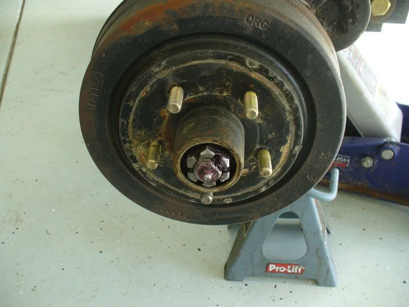

The first thing of course is to remove the tire and the axle dust cap

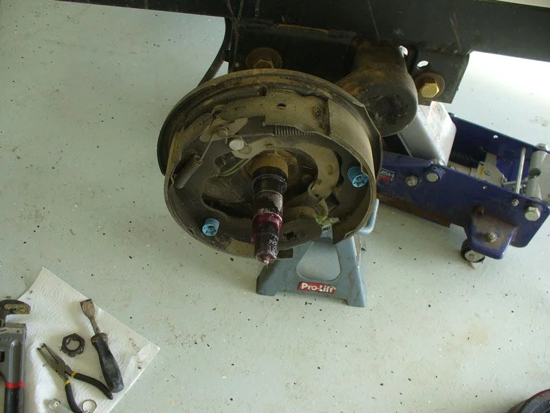

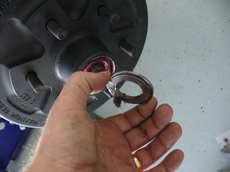

Next, bend back the tang on the lock washer and then loosen the retaining nut
With the nut removed, remove the old Hub

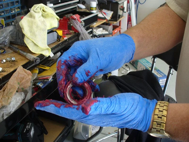

Pack the new bearings.
I use Mobil 1 Bearing Grease and roll the bearings in my hand till it is well into the inners of the bearing. You want to see grease come up through the inner ring
Tap in the inner axle seal and ensure it is fluch with the inner part of the Hub.
I also put some grease on the inside part of the hub that goes on the spindle

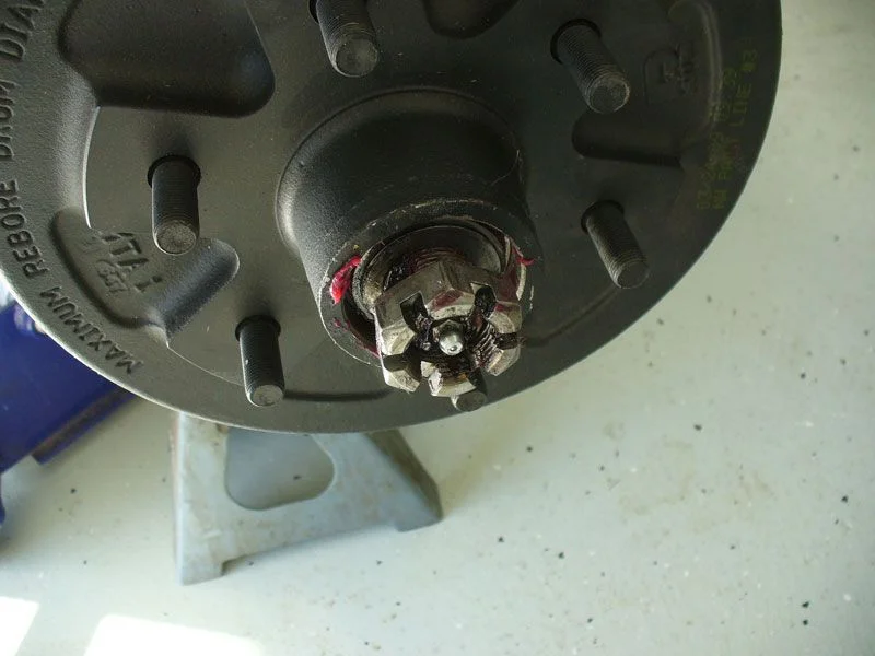

Install the lock washer
Add the lock nut

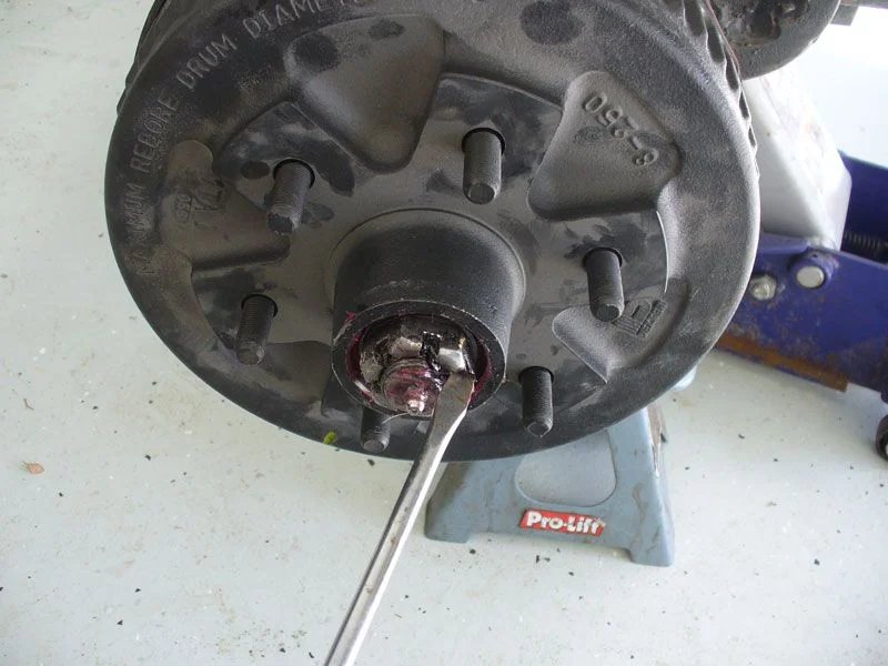

Now you need to tighten the lock nut until you can't turn the drum. This will set the bearings and seals in place.
Then loosen so the drum turns freely, but not to loose.

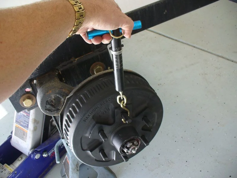

For those cruiser guys who do their own front axles, I used the fish scale method and set the pre-load to about 10lbs. Never done this before on a trailer, but it seemed about right to me
Then push the tab from the lock washer into place

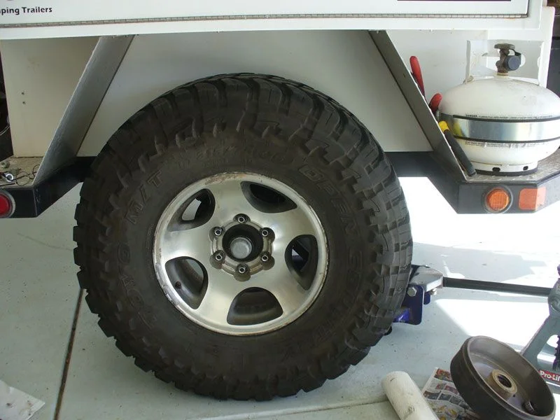

Install the tire an torque the new nuts.
You can replace the Dexter bolts with Toyota's so you can use the same lug nuts if you want

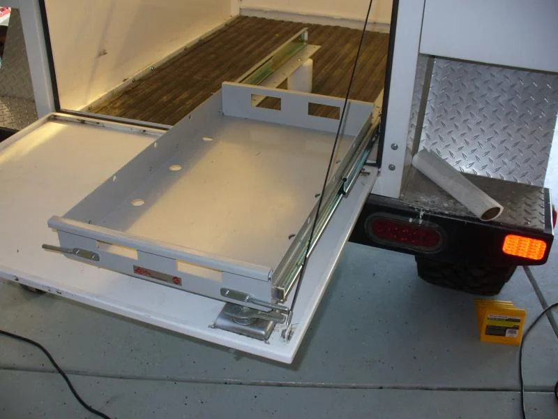

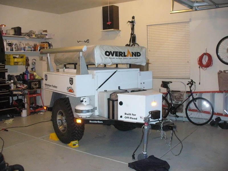

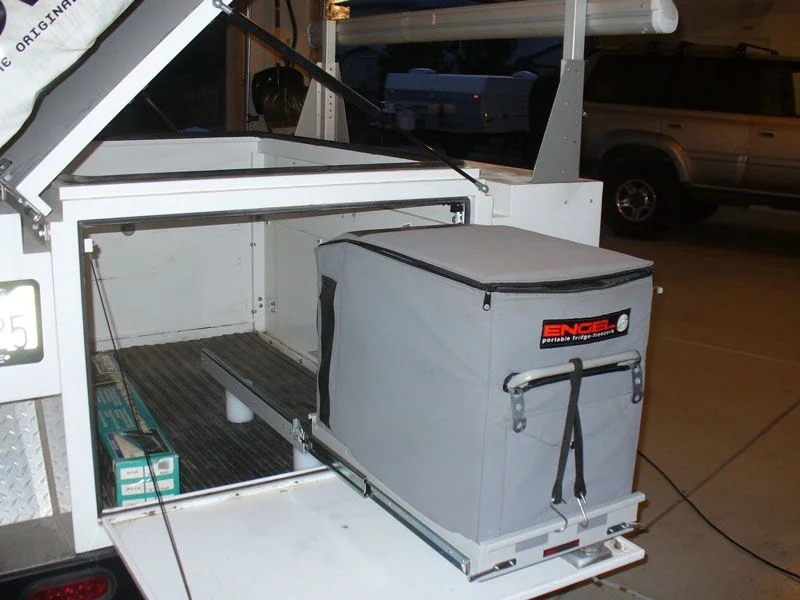

I also installed the ARB Fridge Slide.
Lesson Learned: I installed it to far to the right so I had to modify the right latching mechanism

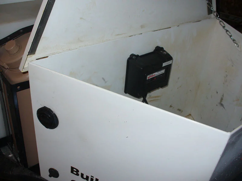

I then installed the Battery Charger and shore plug so I could charge it off of 110V rather than just the truck
Now I just need to swap the RTT for the one I want and I am set.
May want to get larger or at least a spare Propane tank and come up with some kind of heater system

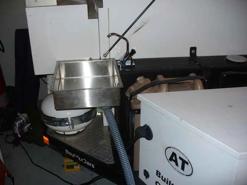

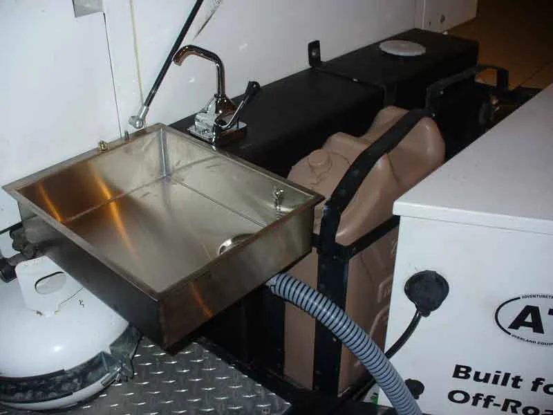

I swapped out the white tank for the Black one and handpump and installed the Sink setup
Of course you take the sink off when driving:D

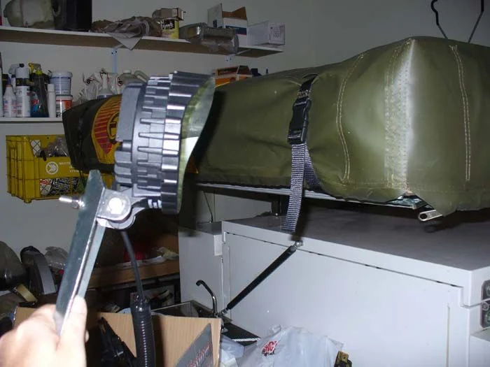

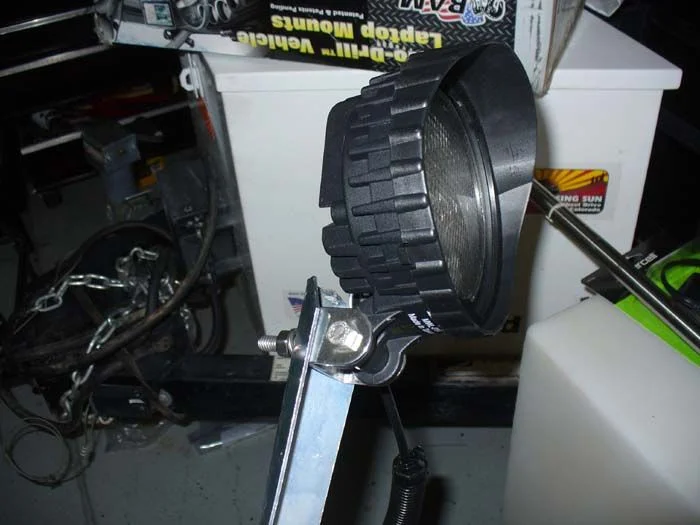

I bought an LED light from AT that can be attached to the camper or used on the truck as a reverse light.
I struggled with where to mount it as I envisoned being able to use it in multiple places.
Over a beer and Cigar I came up with an idea.
Why not mount it on a stake with a long plug to the aux outlet, then I could move it around
Bought the stake at Harbor Freight.

How are you going to plug all the stake holes in the trailer? :eek:
:D
Here's a challange Oh Gifted One.....
Make a dual pupose jammi...something that fits on a stake AND...
can be removed and connected to a magnet to stick to the trailer, if need may be
But thats why it takes me forever to do something...wheels won't stop long enough to just execute...lol
