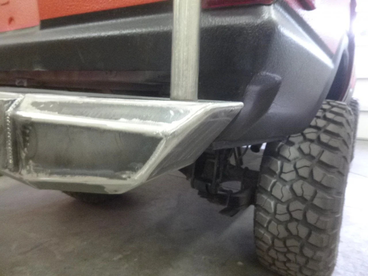

Rough grinded and need to put a 24 and 36 grit flex disk on the edges to smooth them out......
I use a hard disc, then a tiger/zip disc and then a flex disc until I'm happy with the edge. A hard disc alone leaves too aggresive of a cut and a tiger disc will leave serious waves in the metal. The flex disc straightens everything out without warping and heating the base metal too much...
J
