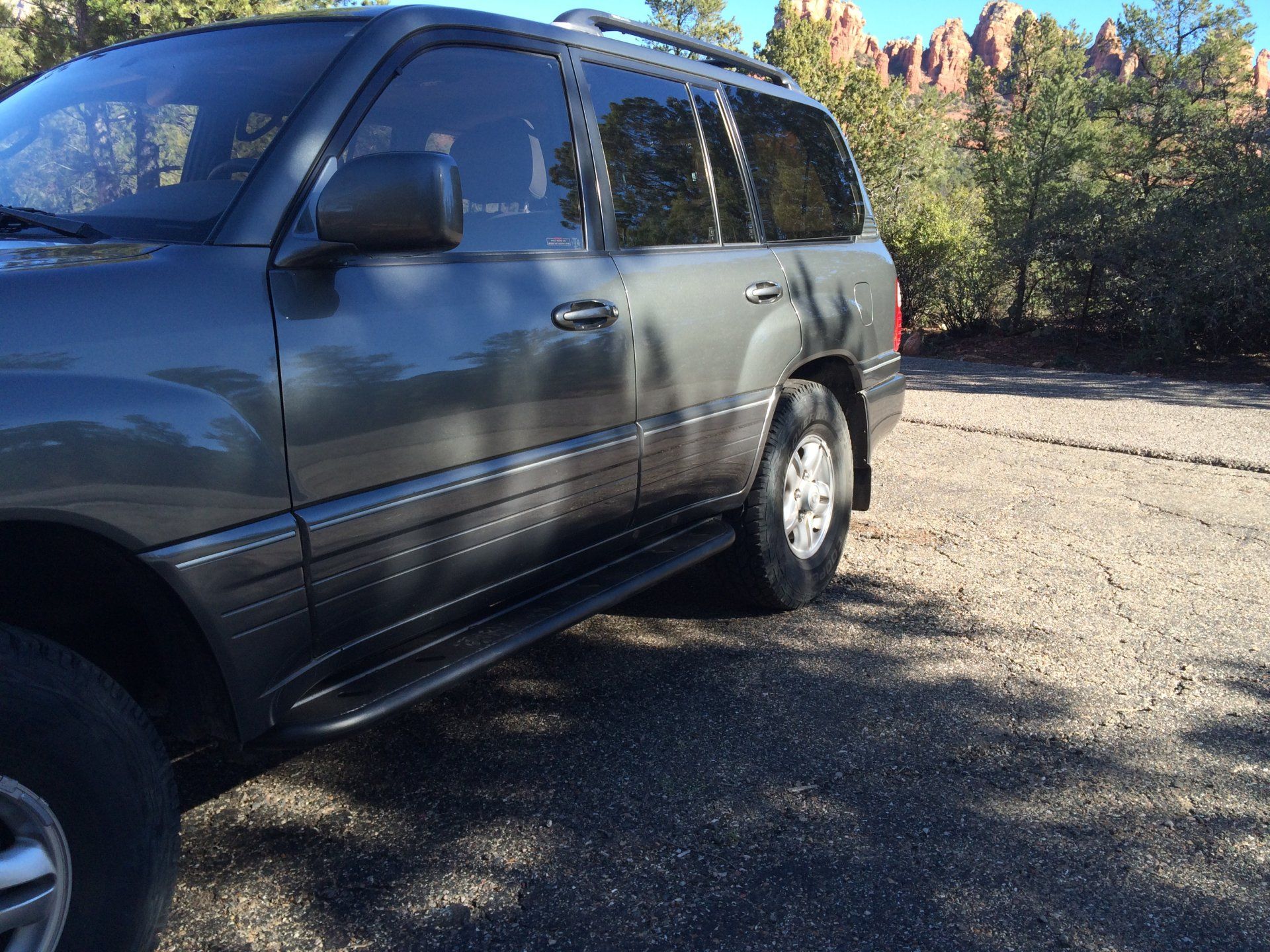

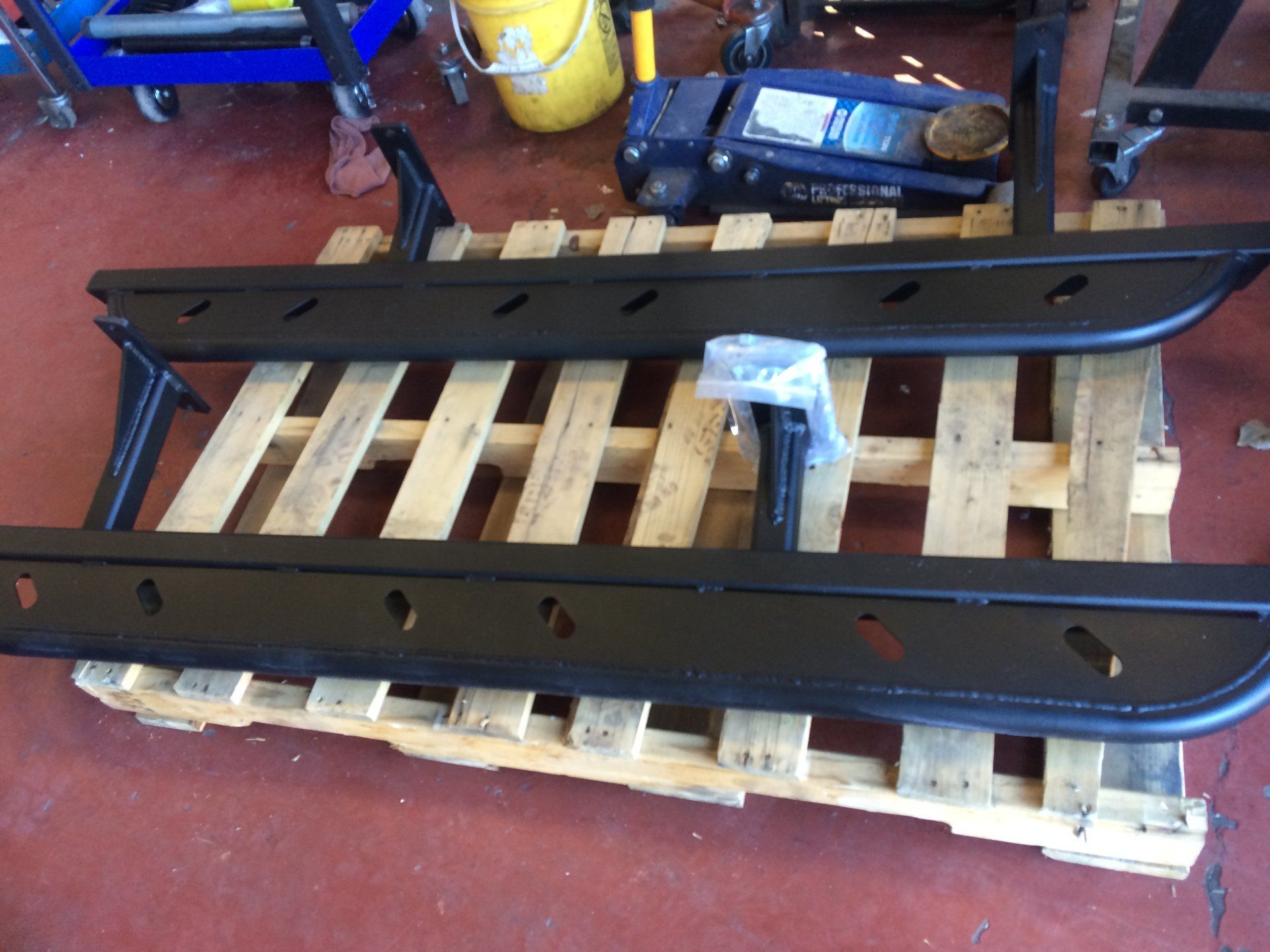

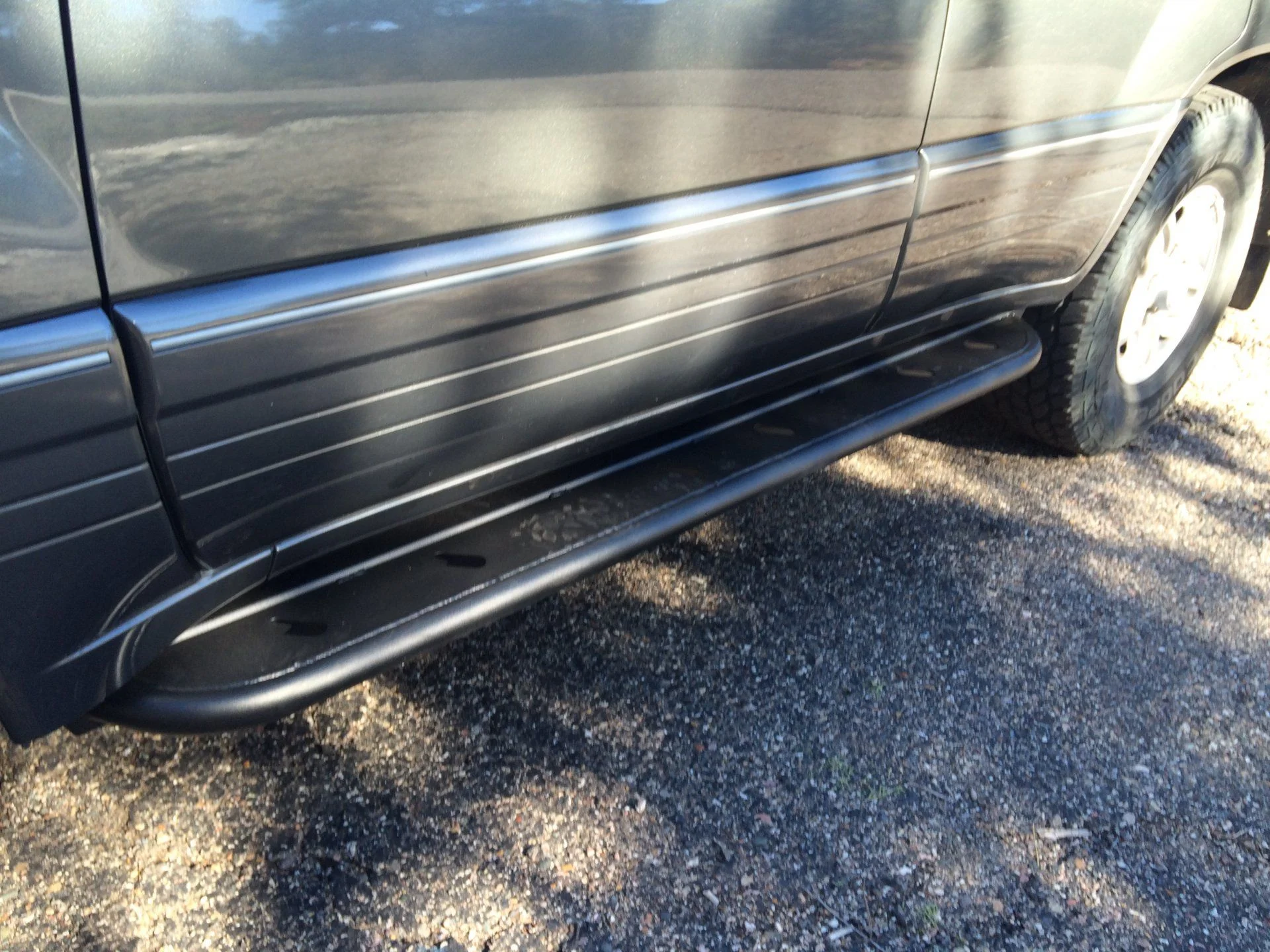

white knuckle. The rear kick out is great for kids getting into the back seat and adds protection! Not to mention white knuckle is bomb proof.
I like how they tuck 'up', which is seems like very few 100 series sliders do. Is that the default 20 degree angle?
Yes, that's the standard install without adjustment. They manufacture these when you order them, so it took nearly 2 months to receive them, but it's worth it.
Nice, thinking about dropping the hammer on a set of Slee sliders. What wheels are you running there ?
I am running BFG 285 65 18 KO2. Like them very much and can run this size with straight AHC and they dont rub even in "N" height.
