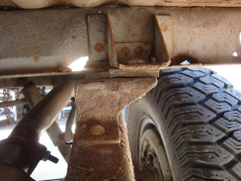

Ok. My bed and my frame do not conform to what has been said above.

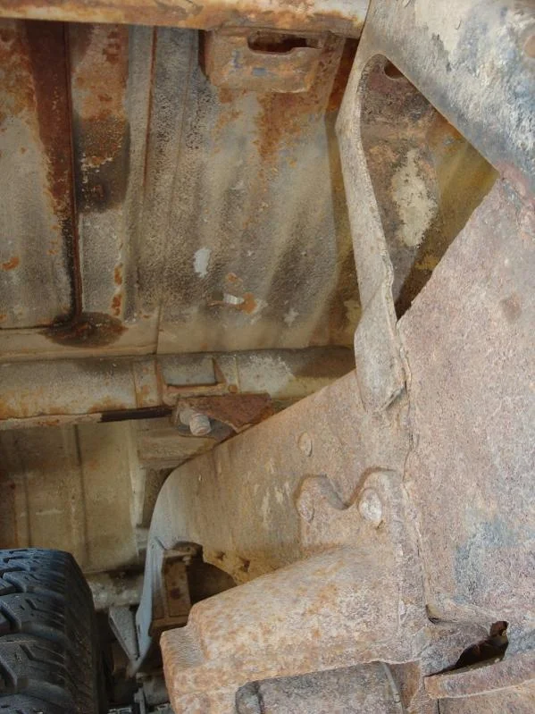

I am trying to figure out why my front bed mounts do not line up. The mount on the frame is directly above the frame as it should be, but the mount on the bed is offset to the outside of the truck.
The other thing that does not conform is the second bed mount. My truck is a July '77 and the frame vin matches the door cin, matches the fender vin. However, the second mound is not directly above the frame, it is offset from the frame as a '79 should be.
I know that my frame has had some mods to strengthen it and it had a picker deck on it, but the mounts look original to the truck; they appear to be riveted to the frame as would be expected.
