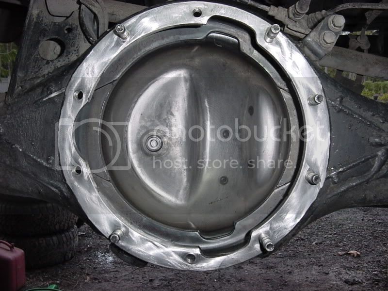

Not quite - the flange where the 3rd bolts up has a notch cut at the 9 o'clock position (easily done with a grinder ) - and the 3rd member itself will take a few studs that are longer than the ones used for the open diff 3rd. If you order rear gasket # 42181-60070, you can use it as a template for what to cut. I don't remember the stud part #'s, IIRC there were 4 studs to be replaced, and they were 3 different lengths.
Here's a pic from my conversion, notch on left @ 9 o'clock is what was added.
Now that I see that pic, the longer studs went where there are none in this pic.
Gotcha, thanks. Basically the same as retrofitting an elock 3rd into an 8" housing.
