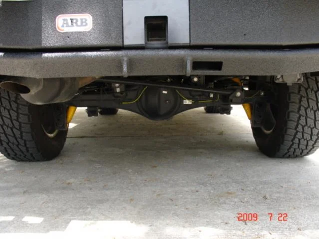

Here are a couple more shots. I need to take a measurement from ground to bumper but I do think departure angle is equal or a tad worse than stock.
Simple question. I assume the upper part of the rear hatch won't open with the tire there huh?
Nope, not a chance. On the flip side, not that bad having to open swing-outs, thought it would be much worse.

There are soooo many better options than ARB for a rear bar. Its like a 20 year old design made to fit the 200 series.
The wings on the ARB are basically unsupported and I would not recommend sticking a hi-lift under them.
