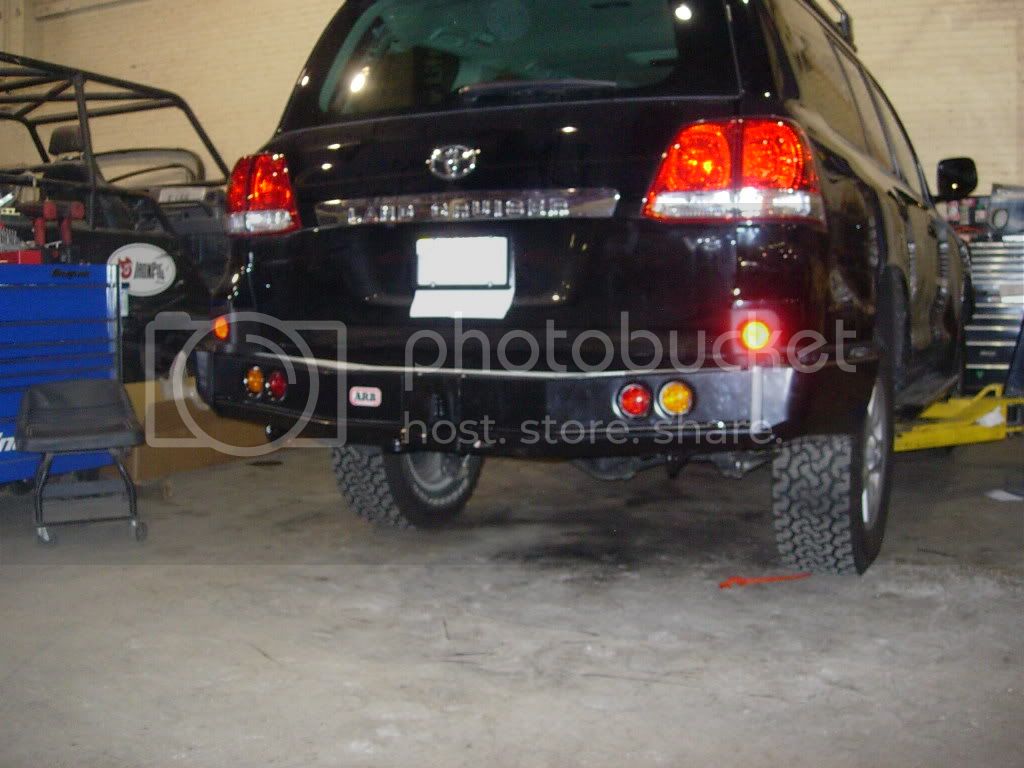

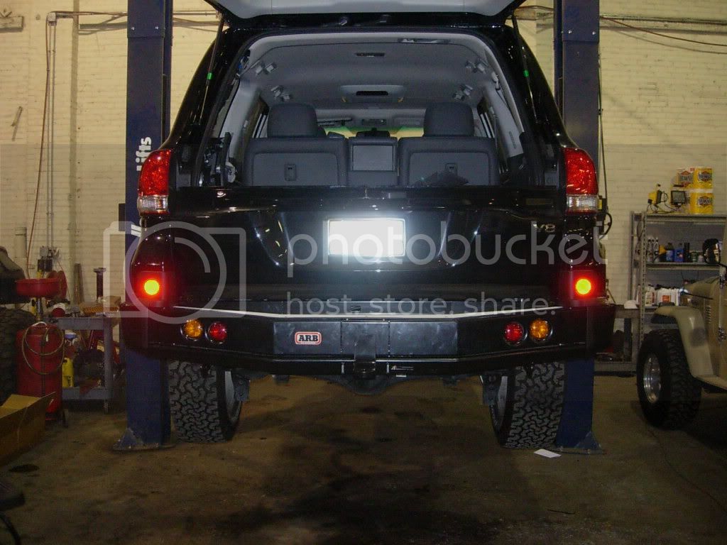

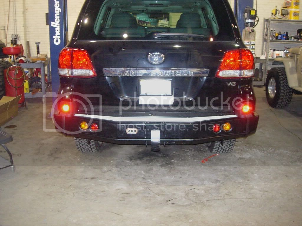

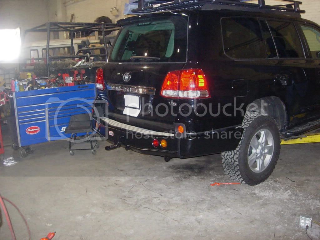

Picked up truck today, looks alot better after final adjustments and reenforced side panel. Gap between side panel and bumper looks tighter, very happy with it. Will post detailed evaluation in a couple of days but I must say I'm glad I installed the OME 440 springs in rear.
Here are some pics of sides and backup camera. At work and don't have way to erase license plate so I'll post rear photo tonight. All comments are welcomed.
Looks good. I thought the camera would be blocked more, but without the cans in there, you can still see pretty well.
Any word on the sensors? What happens when you put the truck in reverse? Do you have the switch on or off?
Any comment on the departure angle? From the pics it looks to be worse than stock. The rear picture will help to give reference to the hitch.
don,
Once again, the rear bumper looks great. Standing by for the rear pictures. Now that your bumper is installed do you see any real issue with left side tire and right side can?
sbly
Here are a couple more shots. I need to take a measurement from ground to bumper but I do think departure angle is equal or a tad worse than stock.
