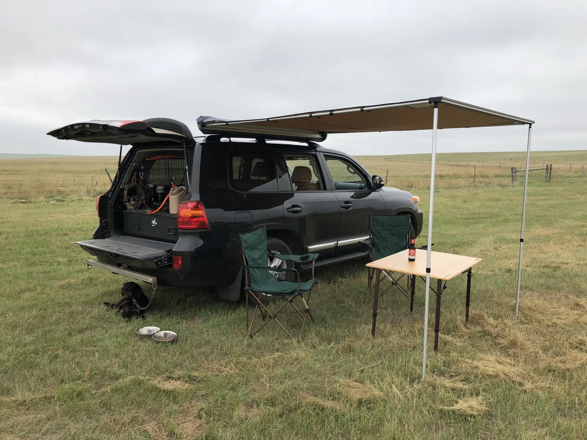

I want to mount an ARB 1250 (4’) wide awning on the back of my Series 200 so it can extend straight back over my lift hatch and tail gate to shelter my dogs in the crates in the back. I also have a Yakima Rocket Box on the OEM cross bars and an ARB 2500 awning mounted on passenger side on the OEM side rails. I’m thinking of something like 2.5”x2.5”x.1875” vertical stainless steel angles bolted to the OEM side rails with tee bolts that the ARB awning would mount to and be above the top of the lift hatch when open.
I figure that the Rocket Box will already shelter and deflect the wind over the new awning for resistance.
Anybody solved this problem before.
