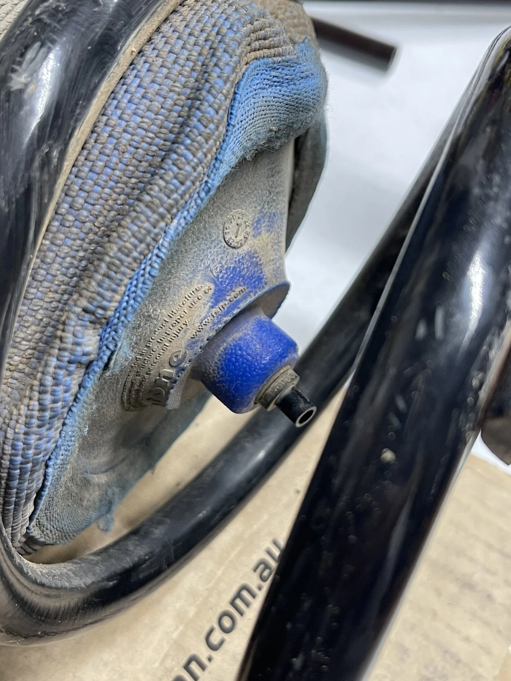

I figured the bag situation out. As mentioned in a previous post, you will want new bags if you are changing springs and want to keep a bag set up. My used ones were deformed at the top. I’m not sure if this is normal wear or evidence of too heavy loads omand too high PSI. I would run yhese bags at max psi (60psi) when towing and 15 psi just driving around town.

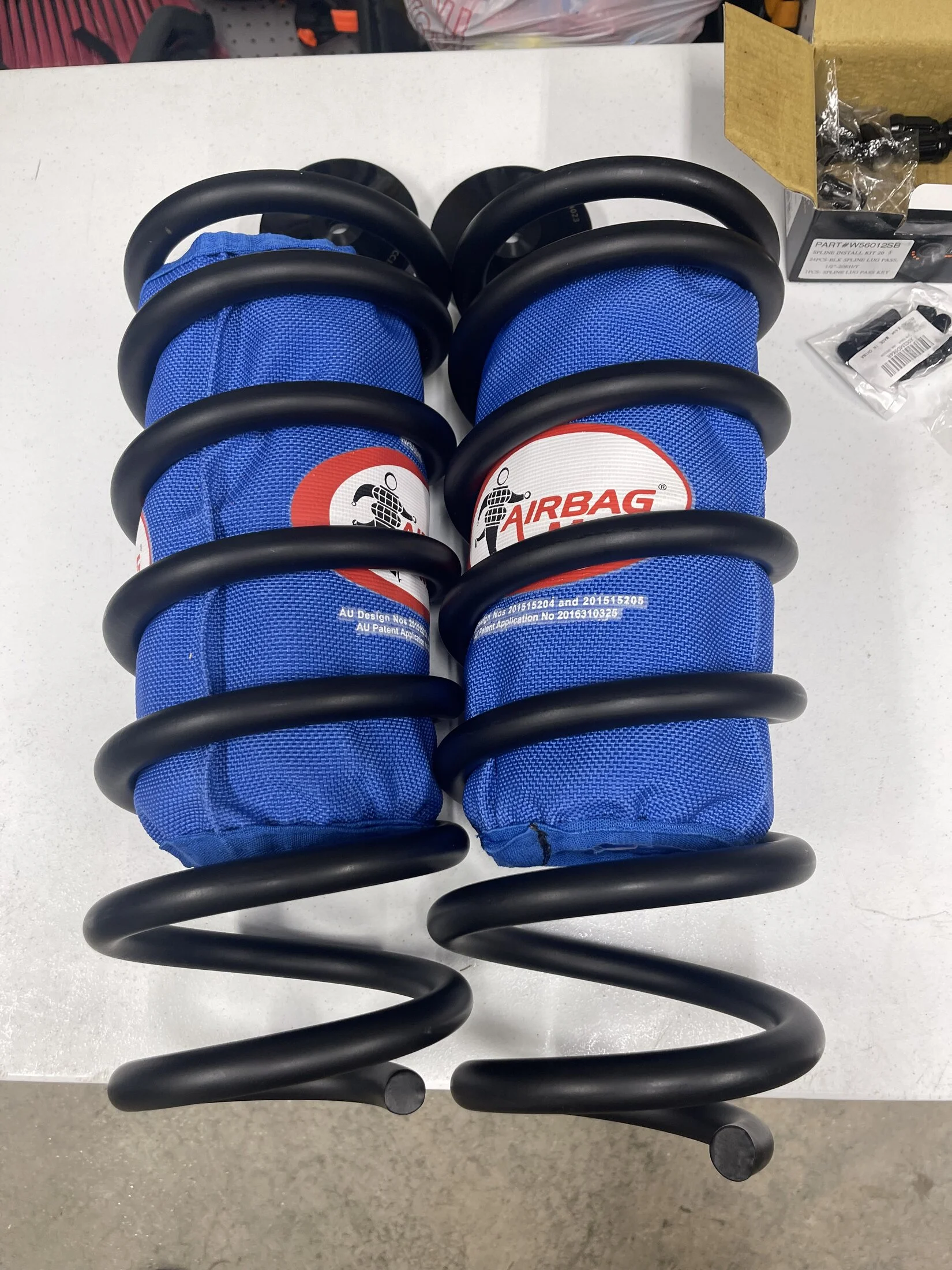

New 2723’s may be the sweet spot for my set up. I’m going to test out with the camper this week.
Rear hight went up .75” with the minimum 5psi in the bags, previously I was running 15psi and .75”’lower. I’m half an inch too high to get in the garage now, I had my wife push the door up higher with a stick and was able to get in. It’s my maxtrax mounting stud things clipping the door. Either these springs will settle in some or I’ll make a change in how I carry the traction boards.
Old bags:
Old bags:
Old bags:

The bags hang down from the top jounce stop. Once they compress it should push a bit of the air line up above the jounce stop... just remove that slack at the top and the bag will hang in the spring. (Or at least that's what I did).
I didn't have the kevlar sleeves but my bags were only rated for 30psi. I used to run them at 5psi when empty so as not to affect my normal ride too much and then 30psi when towing.
