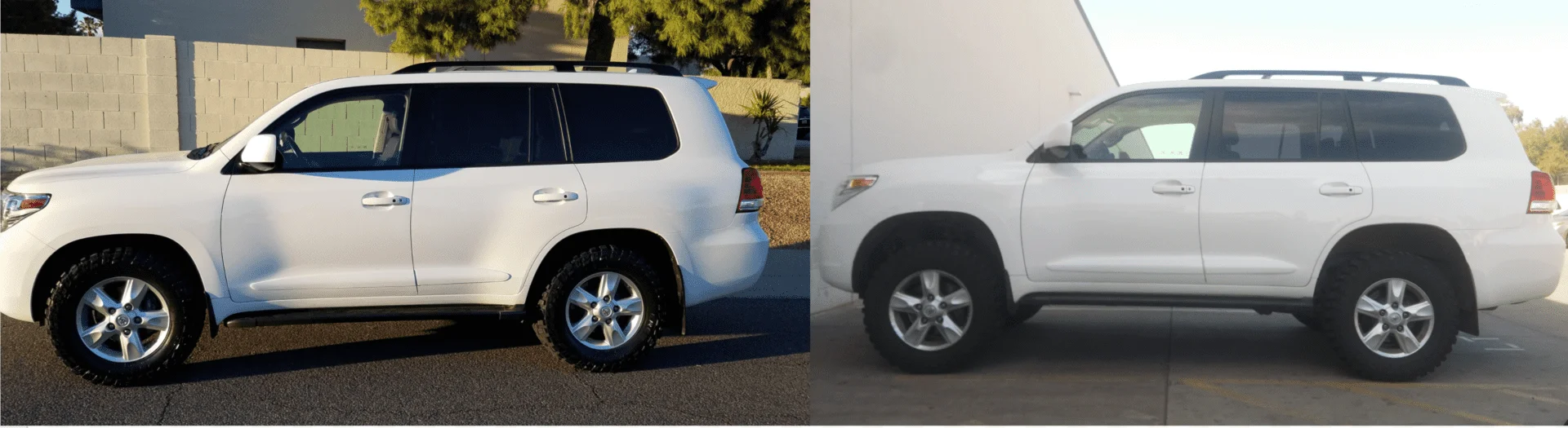

I currently have the 2723s back in the rear with stock weight, no trim spacer. While I prefer the firmer ride driving around (except for rough downtown roads). That’s said, it’s very tall out back. I can’t compare to your 2702s up front, as I have BPs up front with 28mm of preload, and the rear is still 1.5” higher than that. And the front of mine is tall, I just want to make sure your front end is as tall as mine. It looks like it is from your picture, but lets check with a tape measure. Too much rake can start effect cornering handling.
Could you measure the height from the wheel center to the fender lip? I just want to make sure the rear end isn't going to be too high for you.
Height from wheel center to fender lip w/ 2702/2722 combo:
22.75” up front
23.1250 rear
Yup, I misspoke in an earlier post - the 2702/2721 rake was +1/4”. But, the increase in rake going to 2702/2722 was only only +1/8” not +3/8” as earlier indicated.
22.75” up front
23.1250 rear
Alright... my 2723s with no trim spacers are 24.5” from center of hub to fender lip edge.
With no trim packer, you have 1.75” rake. My recommendation if you have a modest camping setup would be to put in 2723s without the trim packers, then test your camping load. If you need the extra .4” of lift, then through them in later.
It’s tough to compare the camping load sag from 2722s to 2723s, but obviously the 2723s can take it without looking like a saggin’ wagon as bad as the 2722s.
If you know you are going to put people, plus 600+ pounds of gear in the back like I do, then I’d put the trim packets in from the get go.
For me to get to that load I have fridge fully stocked, 20 gallons of fuel, dry food, small tool kit, small recovery kit, some extra fasteners, a 24” duffel bag for each person, one cold weather duffle for everyone, shower tent, OzTent, a Kariba stove/shower, a dragon fly stove, sleeping bags, pads, some helinox chairs, and a toilet. It all stays at headrest height if anyone is wondering. I don’t carry a hi-lift, spare parts other than a fan belt, or fluids other than water.
Hopefully that helps kids compare our setups, if you like a firmer “truck” ride, 2723s are not bad. And they are wonderful going down the highway.

Got the 200 back from the shop Saturday and near immediately loaded her up with the family and gear to spend the rest of an extended weekend in Puerto Penasco. (4 hours south of Phoenix.)
The difference was noticed immediately going with the 2702/2721 and 15mm packer setup. The vehicle felt more planted on the road than either of the two previous setups. No wandering within the lane, no squirrel-like sensations. Even felt comfortable taking the 45 mph curves along Maricopa Rd at 70+ mph; there was slightly more body roll than stock, but the wife and kiddos stayed comfy. Wasn't quite up for pushing the "double minus ten rule", that would have registered complaints.
The ride is notably firmer than stock, but not uncomfortable. My wife likes it better; she says it feels more like a truck should. The increase in firmness was apparent not only off road down in Mexico and on their streets, but even on some highway stretches stateside. For example, the one year old would belt out an "aaaahhhhhh" for stretches that would then oscillate her tone with the subtle vibrations of the road coming up through the vehicle. She got a kick out of it, tho, and would laugh after running out of breath. This OME suspension setup hits the spot for us; just pointing out where I suppose the extra money for the coil overs likely goes.
At this point, I'm pretty sure the culprit in the previous suspension iterations was the OEM spacer combined with the 2702 front springs. And the 2722 rear coils likely just masked the issue better than the 2721. Perhaps with the 2700 front spring, the OEM spacer would do better. (If anyone wants a lightly used set of OEM spacers, PM me and I'll work to get them over to you. 3/23 Update: OEM Spacers found a new home.)
Interesting side note, all the previous theoretical calcs relative to this new setup materialized. Am left with 7/8" rake and 1.375" from bottom of Timbren to top of rear axle.
As captured in another thread, this setup did yield faint rub of the 285/65R18 STT Pros against the front sway bar that SPC techs validated could not be remedied without either moving the sway bar or pushing the tires out. So, I'm going back in for spidertrax spacers later this week.
Hat tip to @murf and his crew for their continued patience and willingness to work with me dialing in this setup. Camelback Toyota has been thoroughly great.
Spidertrax wheel spacers are in now; sway bar rub gone.
Minor rubs against some of the plastic pieces within the front wheel wells now (under very specific conditions); nothing a little bit of trimming shouldn't be able to fix.
Mud flap trim complete;no more rub.
Still need to address the rub against front bumper wheel well trim at full lock in reverse. I notice it pretty much whenever backing into a parking spot - which is my customary parking method. So, it’ll need to be addressed. After spending time under the vehicle, unscrewing and re-attaching plastic pieces, am thinking to heat gun the inside elevated channels and then push them in. Just need to address the lower couple inches of the plastic. The theory being the necessary clearance will be gained when the plastic cools.
