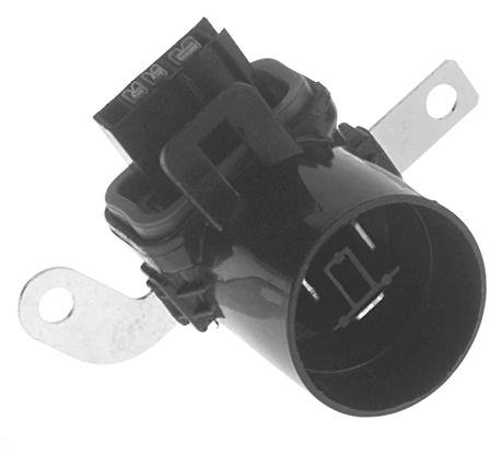

that and this should make it pretty simple instalation
http://store.alternatorparts.com/partno461804.aspx
Part # 461804 - Adapter Plug Fits GM's CS Series Alternators in Toyota and GEO Vehicles. Great for adapting High Output GM alternators
