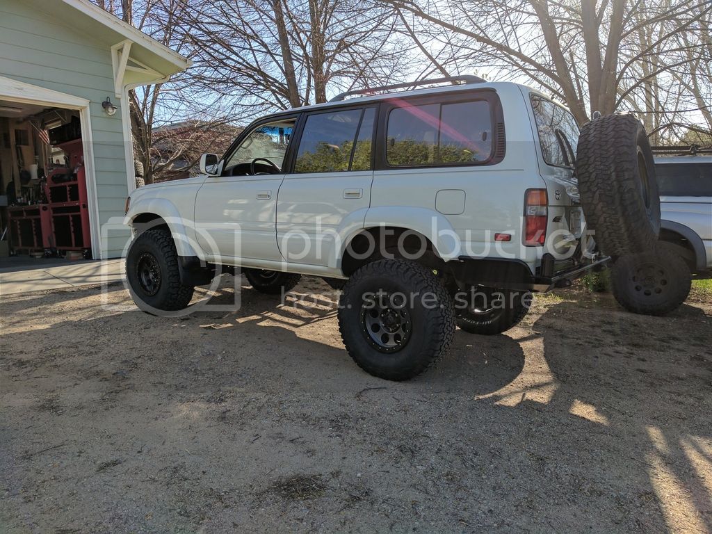

Level 8 Tracker Pros 16x8.5 4.5BS on 315x75R16 BFG KO2

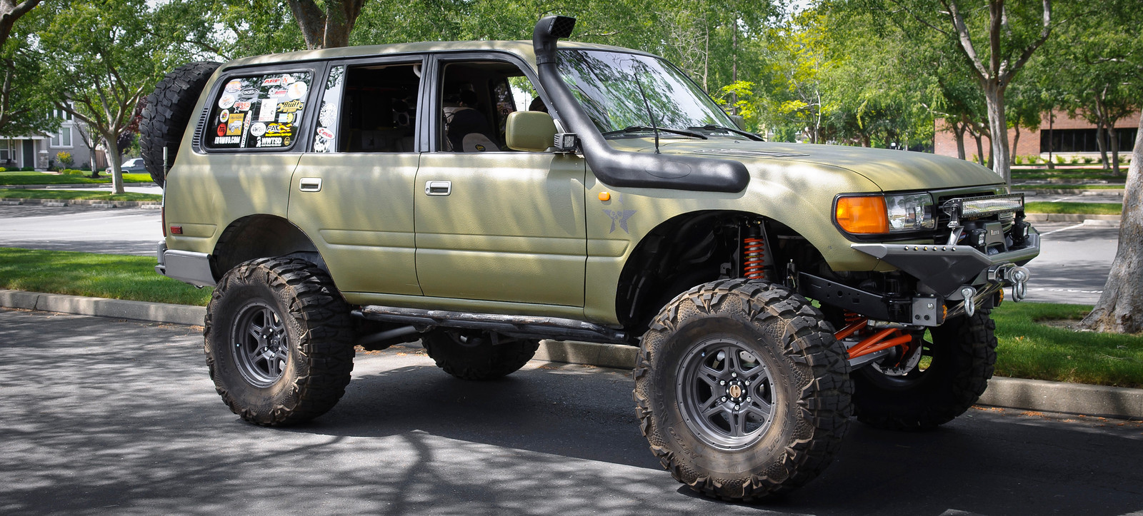

Jcardona1 has(d) the same wheels I do, the Strike 6.@jcardona1 , those are not the MK6 style though?
You could probably go to a discount tire store and they would test fit a rim to see it they will fit. If they don't fit due to the center bore you might be able to take them to a machine shop and have them open the center hole more. Other members have done that on other wheels with good success.
IIRC He has painted them several times. Check his build thread in his sig.@chap79 yes @jcardona1 has the strike 6 but his are a gunmetal color & I cannot locate that color . That is the color j would like
