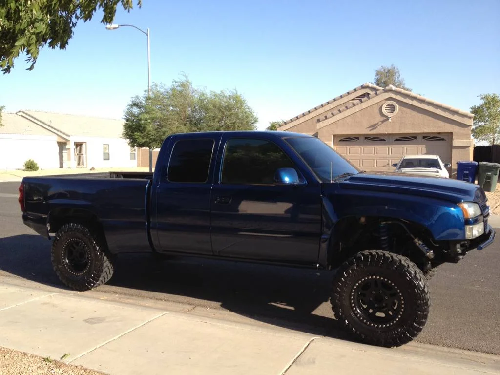

Kings all the way around all the long travel silverado.

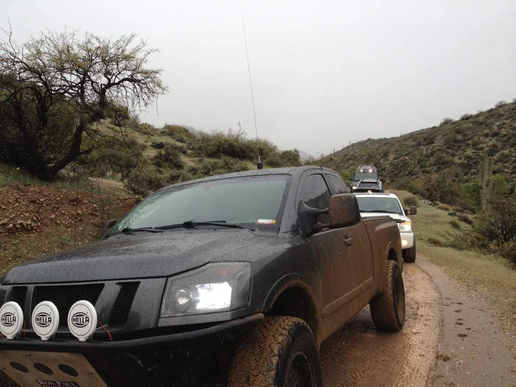

Had Icons on the front of the Titan first, a little too soft for off road bashing so I picked up some Sway-A-Way extended length coilovers with stiffer springs. Always ran Radflos in the rear of that truck.
I jumped and ran the crap out of the Silverado without rebuilding the Kings. I also ran the Titan very hard and never had to rebuild the Icons or Sway-A-Ways. Rebuilt the Radflos once but A) I had those for 3 years which was the longest of all those shocks and B) I had a really soft spring set-up in the rear and was tasked with carrying a bed full of firewood on one of the weekend excursions and it was pretty much bottomed out the entire way from Phoenix to the mountains outside Tucson with some rough dirt road travel and after that I noticed the leak. Radflo customer service was awesome to deal with too.
