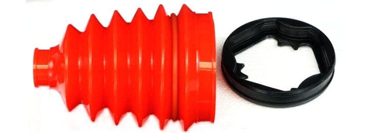

To be honest I have mixed feelings about their signature orange boots...from a purely aesthetic pov.
CVJ boots are red Orange is RCV.
Same, I have seen way too many people have issues with them wearing out pretty quickly but haven't heard much as of late
