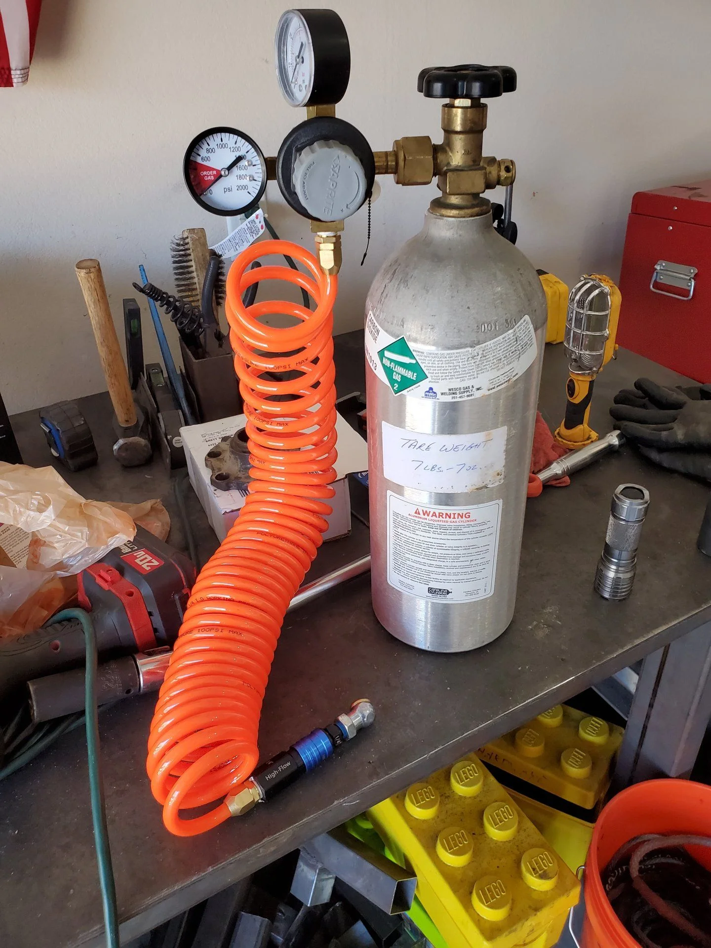

I have a 5lb co2 tank from my beer brewing setup I'd like to make into a tank to refill tires on the trail. I know 5lbs probably isn't enough to run tools , but should I expect to be able to get a least 8, 33" tires from 15-20psi back to 35-40 psi before a refill of the tank?
I know there are better options, but in true beedeegee fashion this is what I have laying around so I don't have to buy an air compressor. I also like the fact that with a 150 psi regulator I can fill way faster than any compressor I can afford and I don't need the battery.
Thoughts?

Right now I don't wheel enough to have to worry about forgetting to fill it really. I'd just top it off (or swap it out) before a trip. I never even need to air down off road locally so I would probably only have it when I go on trips. You're right though over multiple days it would get annoying trying to get it filled again. Maybe I should just get a 10 lb tank. I like the idea of being able to run an impact off it, but maybe my battery powered one would last just as long I dunno.
As far as it blowing up I'm not too worried about that. I drive around with SCUBA tanks at work all the time. The main hazard would be dropping it and knocking the top off while pulling it out to use I think.

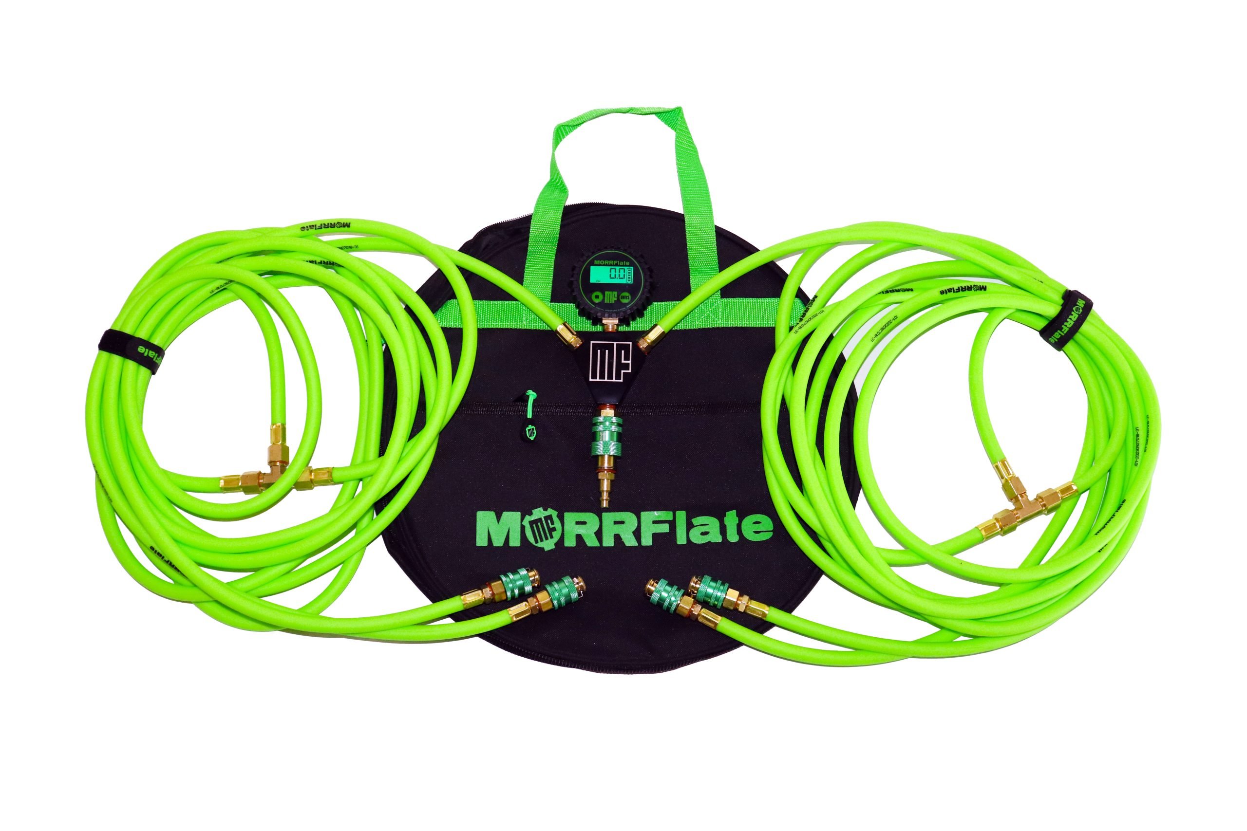

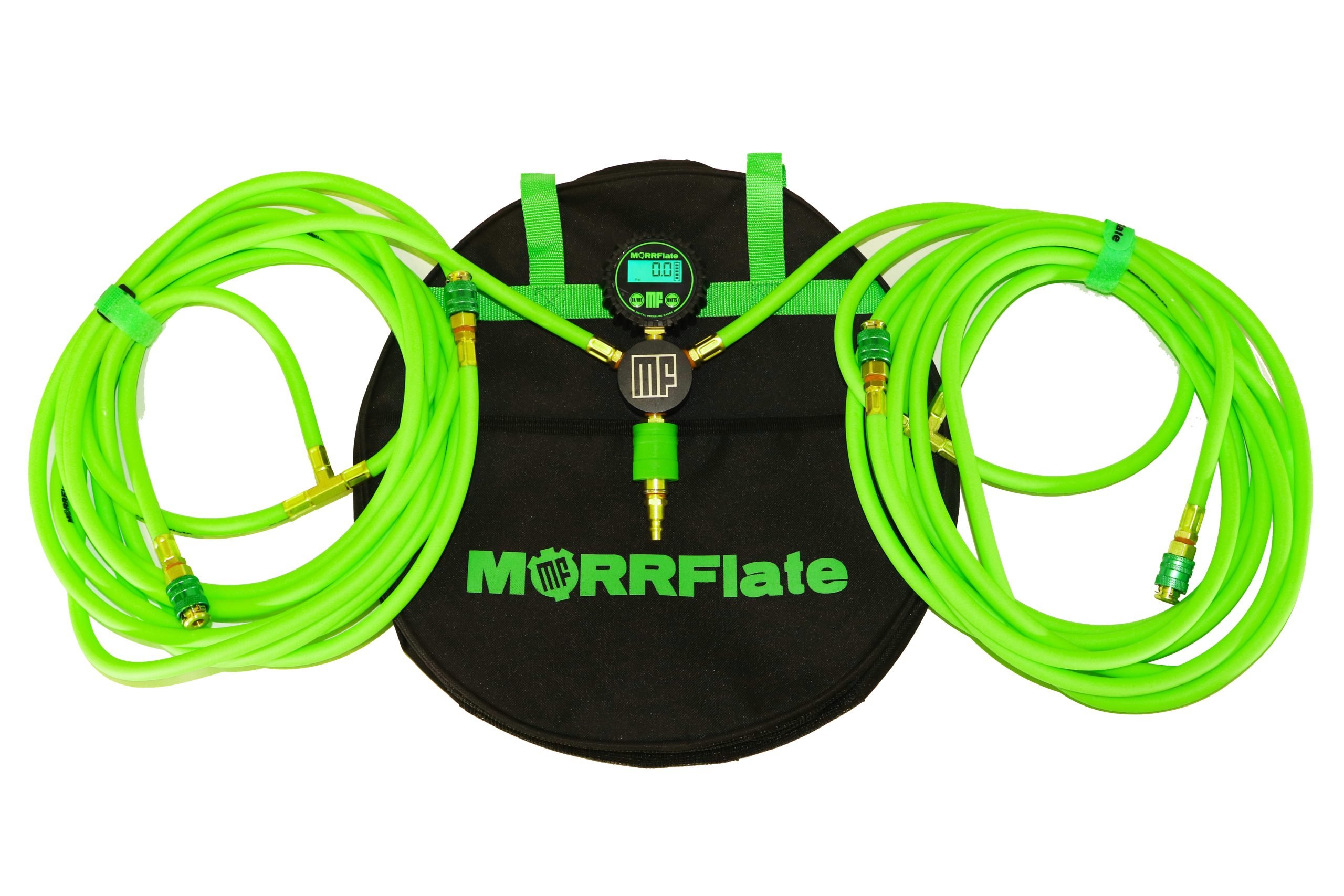

Yes, I love this approach. I use a "MORRflate" setup with 4 outlets. It's really nice to have all 4 equally pressurized. I got their kit with the built in pressure gauge. Worlds nicer than doing one tire at a time. FWIW, the MORRflate setup with gauge is $225 and comes 100% assembled and ready to rock. The only other step up I'm aware of would be to run hardlines to your wheel well areas and use a small quick connect to complete the circuit to the tire. I think that's the "Wifey" kit approach. 🤷
