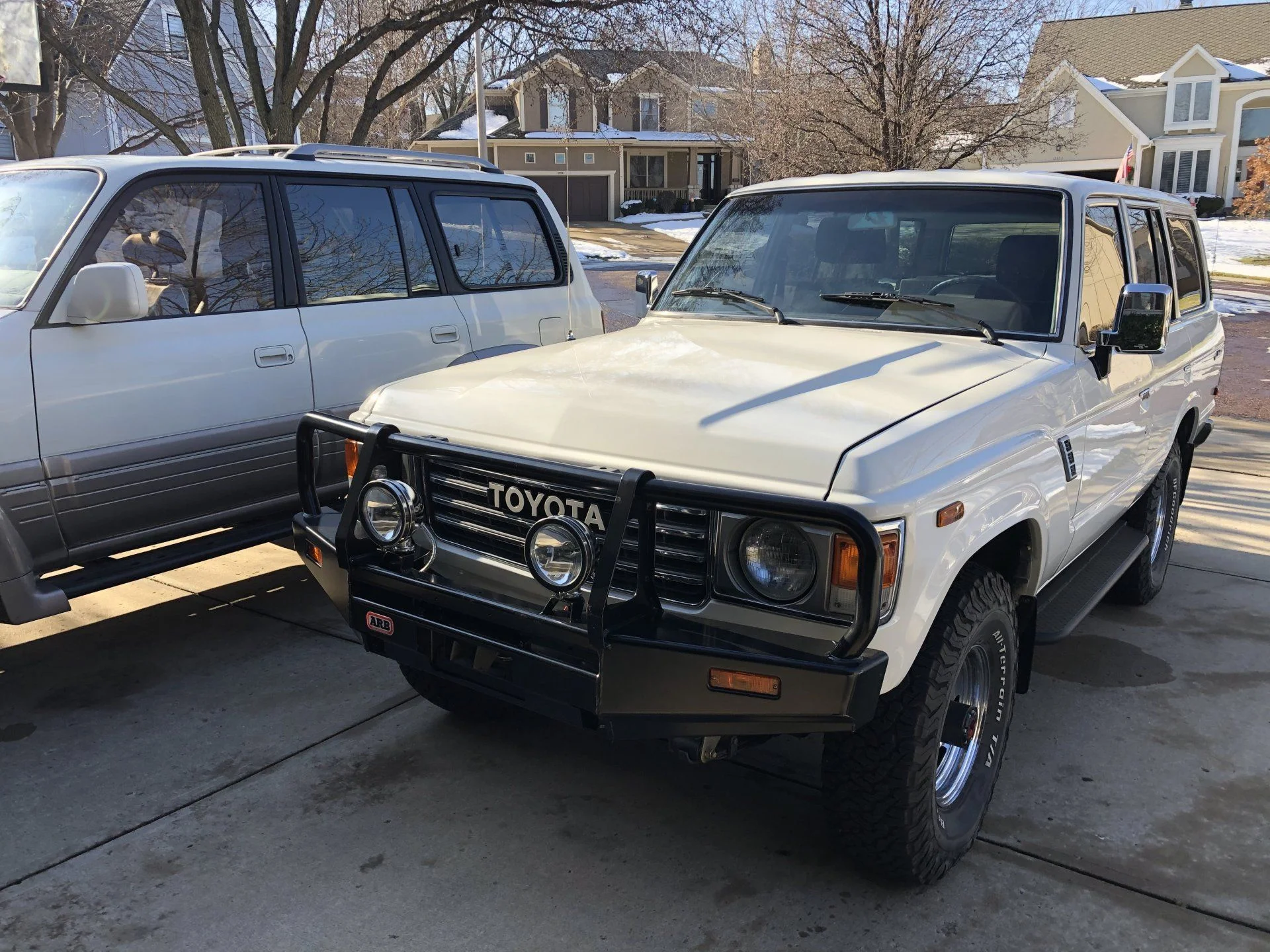

What headlights are those? OEM or upgraded? The whole front looks great.
The lights are Trucklite LEDs with OEM reconditioned bezels

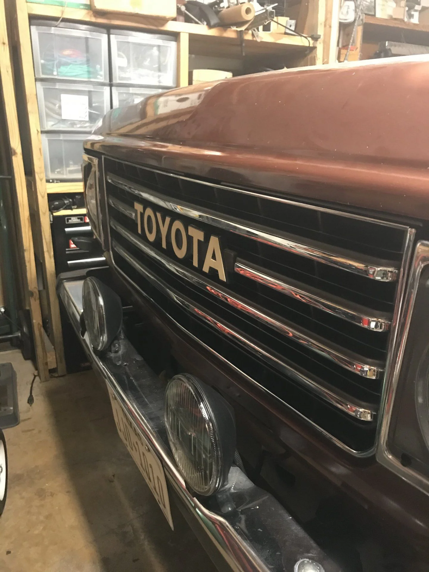

The YOTOTA emblem is a separate part number and still available new. Ordered this same grill last year. Have over 1,500 miles half on highway. Seems to be holding up with no chipping. You will notice it is lighter than the OEM grill but once installed, looks great. Wasn't expecting much at this price but turned out to be a good purchase.
The YOTOTA emblem is a separate part number and still available new. Ordered this same grill last year. Have over 1,500 miles half on highway. Seems to be holding up with no chipping. You will notice it is lighter than the OEM grill but once installed, looks great. Wasn't expecting much at this price but turned out to be a good purchase.View attachment 2389995

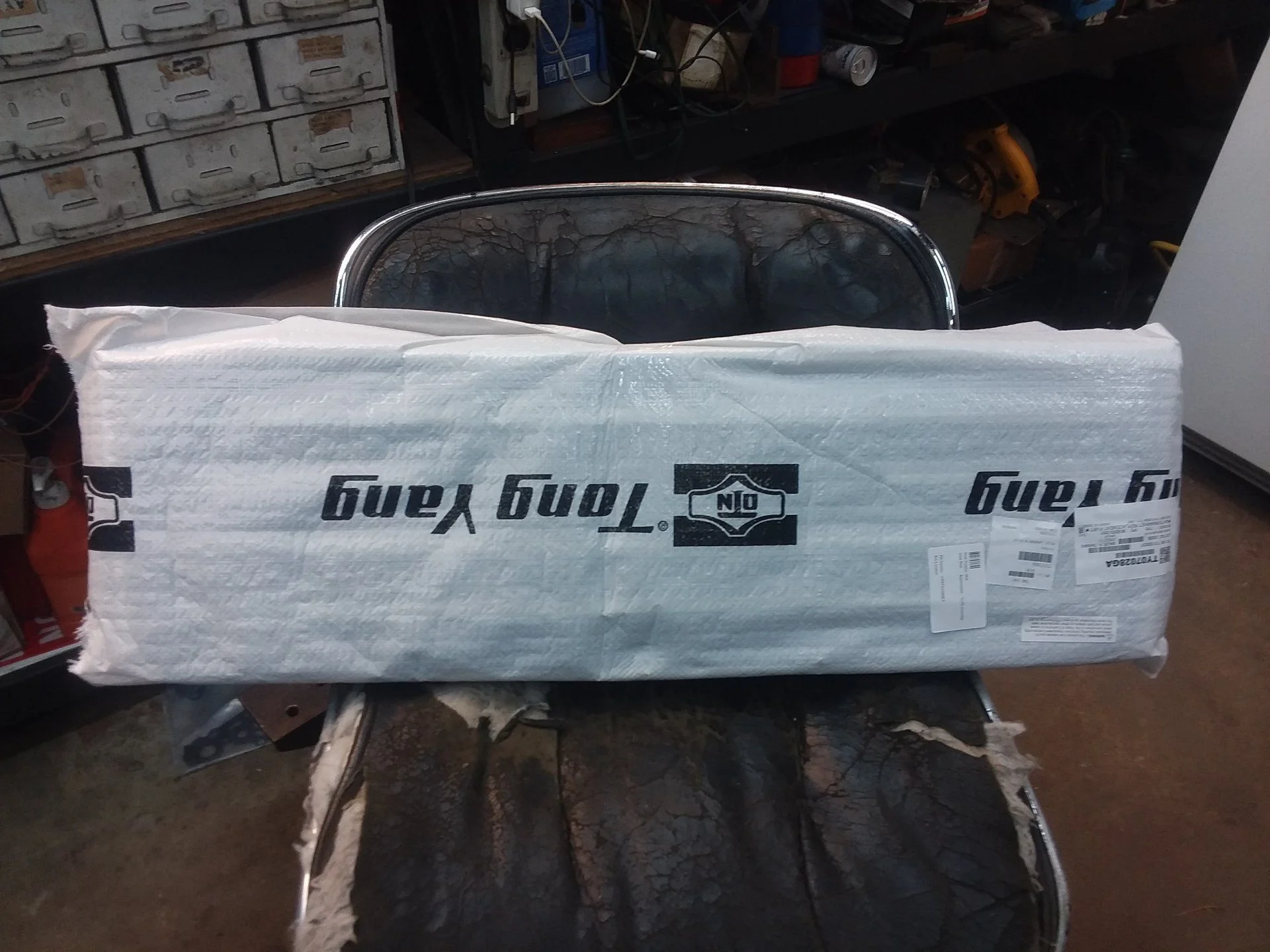

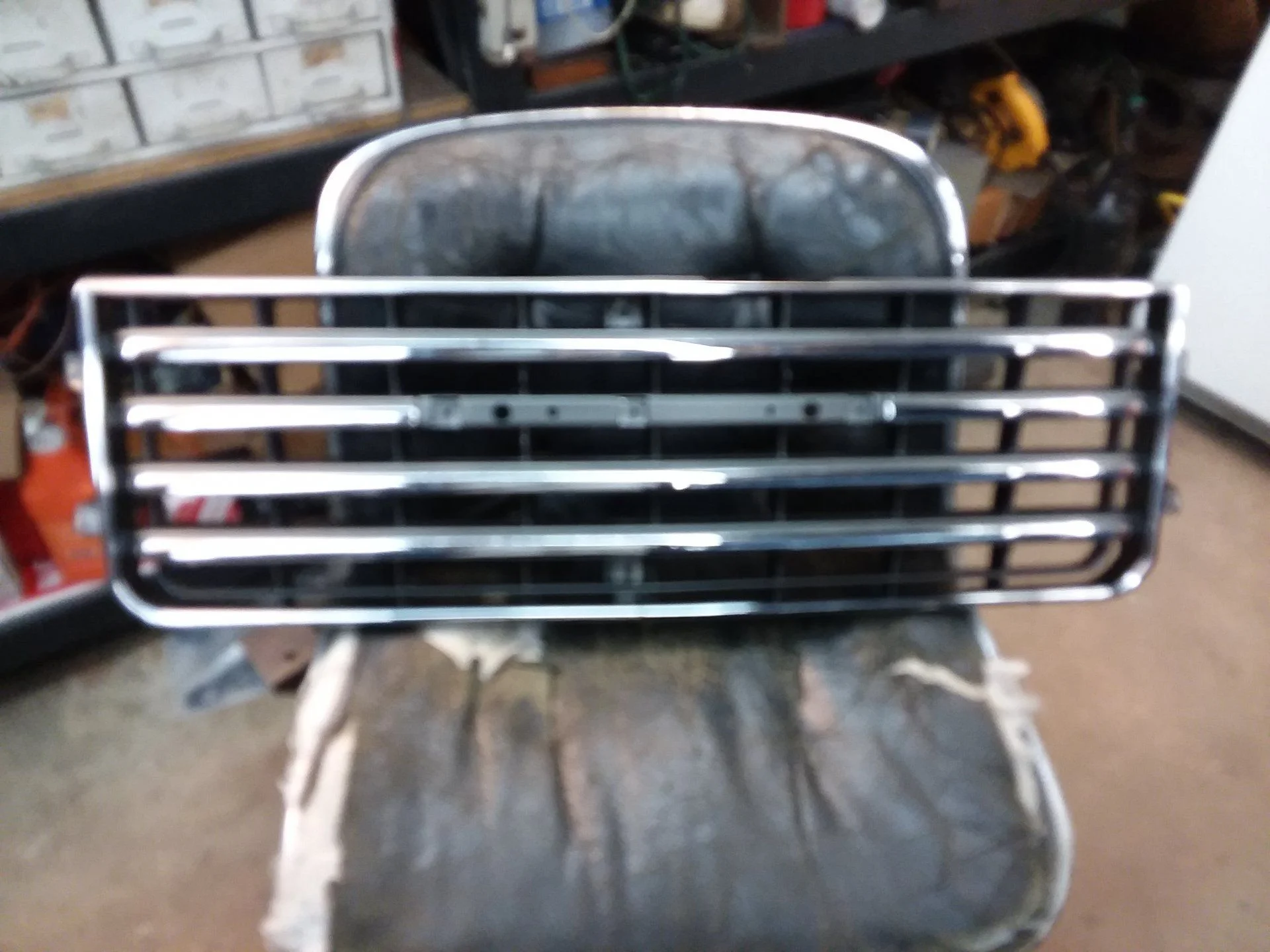

On your recommendation, got one of these grilles as well. The chrome bits on mine were bubbling and flaking off. Agree, cannot beat the price and it looks great. Thanks for the tip:

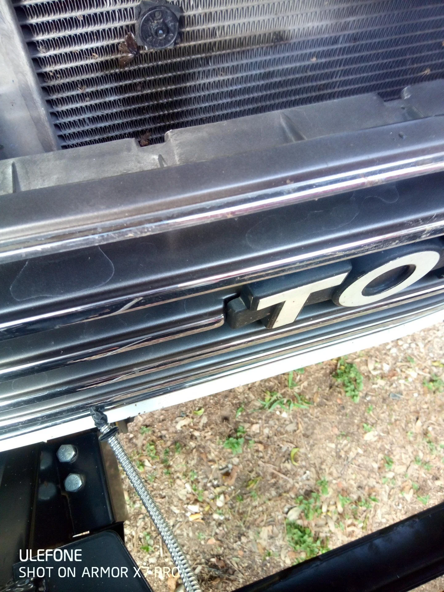

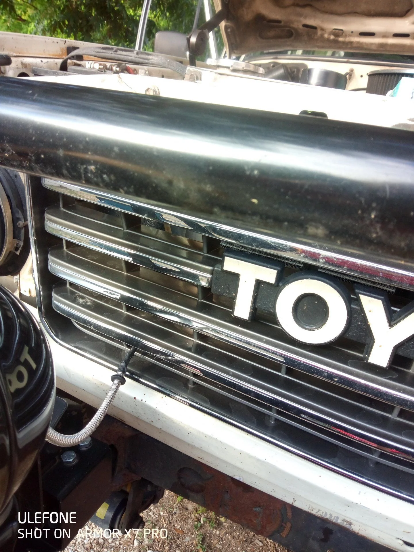

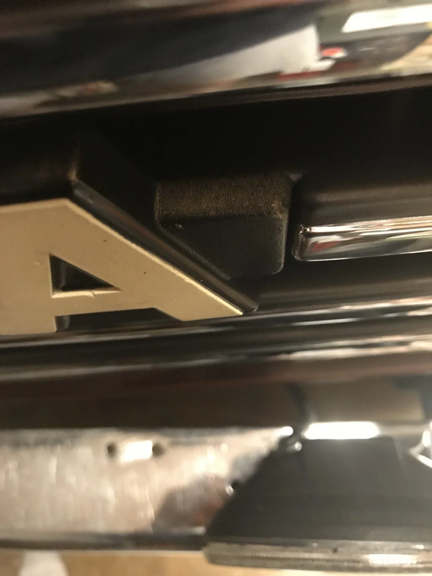

I had to make a couple of minor alterations on mine. As you can see, the T doesn't quite sit perfectly. But still a bargain price.
I had to make a couple of minor alterations on mine. As you can see, the T doesn't quite sit perfectly. But still a bargain price.View attachment 2417698View attachment 2417699View attachment 2417698View attachment 2417699
Yes. I had to make the same mods. The holes on mine where the badge fits in and is centered on the grille were simply not opened up from where the part was cast/made. Leftover plastic from the manufacturing process. Just had to take a knife and open them up some with some strategic trimming and the badge fit fine for me.
Prolly not as good as OEM but was fine for my needs when you factor in the cost. No idea how its gonna hold up over time, but willing to take a chance and see for $52 dollars shipped. Thanks again.

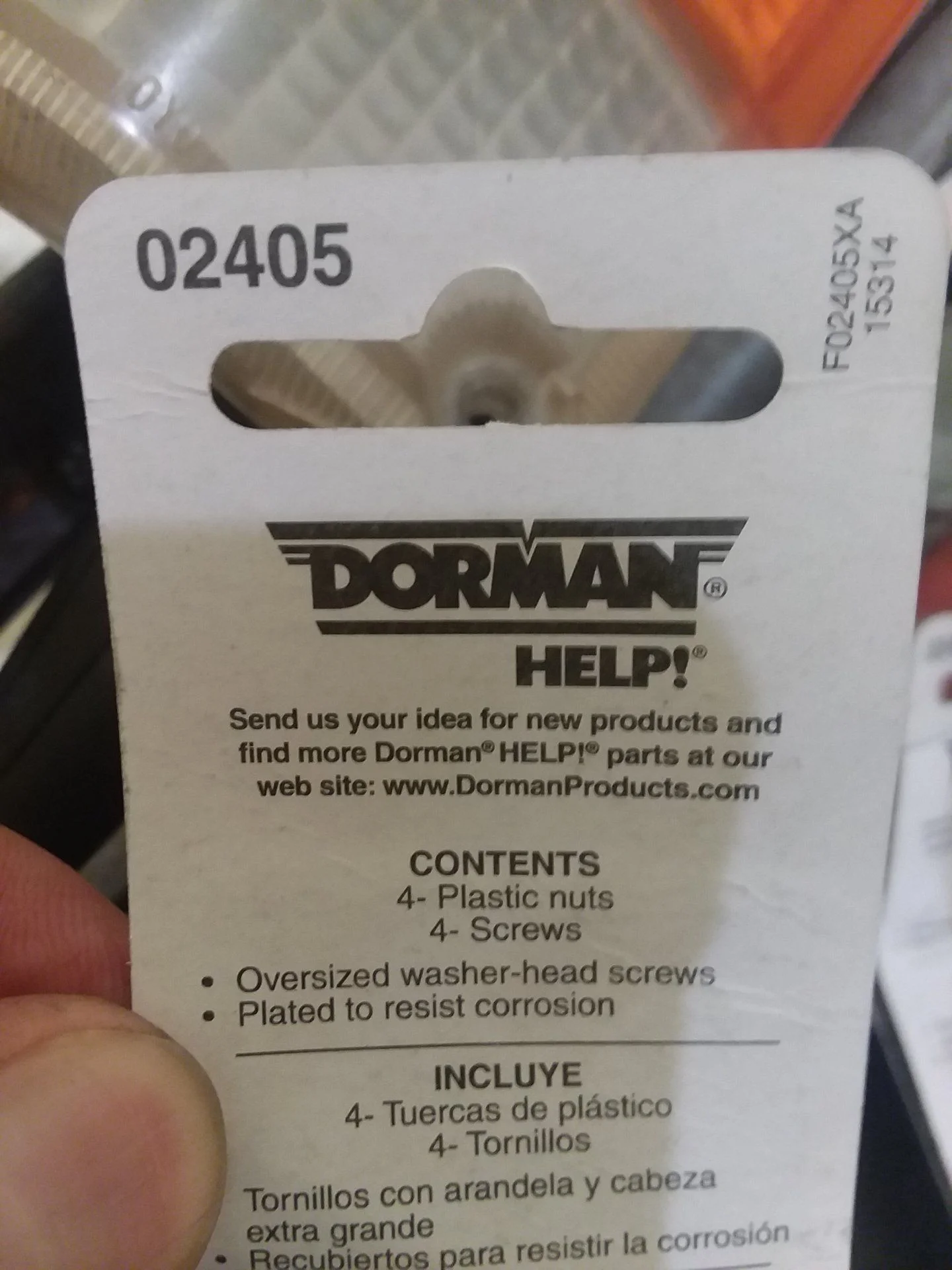

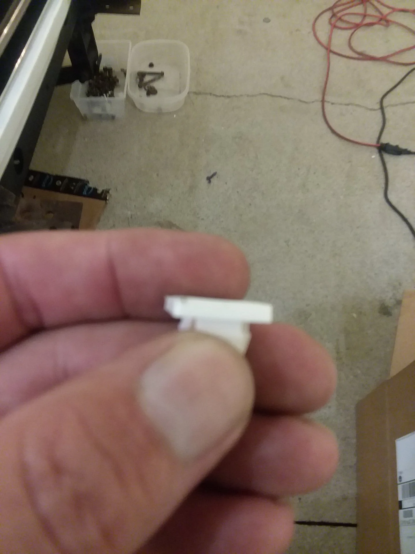

Updating with pics the oem inserts for the turn signal don't uite work with the new head light doors from cool cruiser they are made by the same company that males the grill i used the dorman part# in the picture with the oem screws they work but they need to be sanded down because they are thicker than oem and will make turn signal stick out further.
