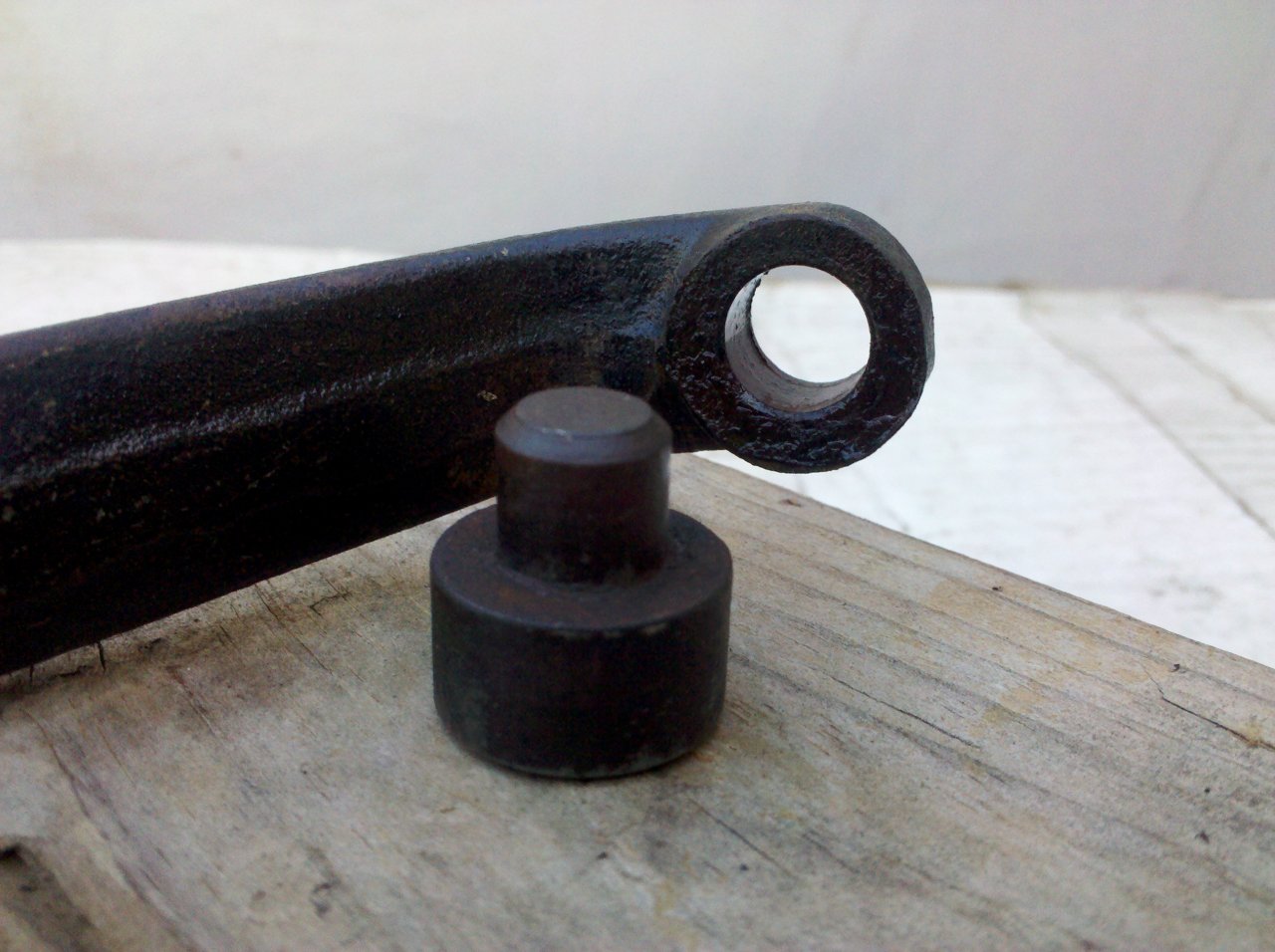

The problem with the transfer case shift linkage is the mounting location of the pin it pivots on. Take a look at the bracket it is mounted to and see about raising it the required amount.
The nub on the rod the rides in the slot is actually a pressed in piece in the shift arm. That bolt head is going to hit your exhaust pipe when raised if not replaced. Here is what the factory one looks like:
My thought is to remove the knot on the back completely and just have a knob the correct height and width for that slot on the transfer case welded to make that adjustment therefore removing the night to muffler/exhaust rubbing issue
That Preston piece looks like rubber is that correct

Here are the photos of my linkage and the current offset. Going to get the offset fixed this week. Bought the stock nub so there will not be rubbing on the exhaust.
