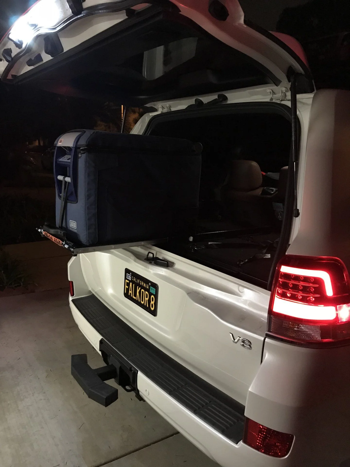

Just wanted to close the loop on this. I purchased the Front Runner Drawers, and installed them in my LC for about a month with the seats still in.
I got tired of the "looming" feeling of dragging around a bunch of dead weight, so two nights ago i took the seats out and installed the trim/ deck completion kit, and the Alu-Cab Tilt slider. so far i love the setup.. going camping glamping this weekend to test everything out.
so i just wanted to say thanks to @gaijin for all of the details about the FRO drawers, and @indycole for posting some of the first shots (that i could find, my click fu is weak) of the Alu-Cab tilt slider.

Ok, tilt-slide questions:
Do the frame mount nuts protrude low enough to interfere with the drawer dividers?
How did you possibly reach far enough into the drawer to fit the back nuts (assuming you followed directions)? Is there another way?
I may be having a brain cramp.
I just installed the FRO drawers, so far so good. Definitely need above-head hatch lighting!
I'm going to order the Alu-cab fridge slider and install as seen above...
@FALKOR8 is that the small or large slide? I don't have a fridge (yet) would be using a yeti65/canyon55. Did it come with mounting hardware, or did you hit the hardware store?

Quick question, when you installed the fridge slide, did you pop the wood top off or did you screw them in by reaching through the drawers? Trying to find the easiest way. Thanks!
