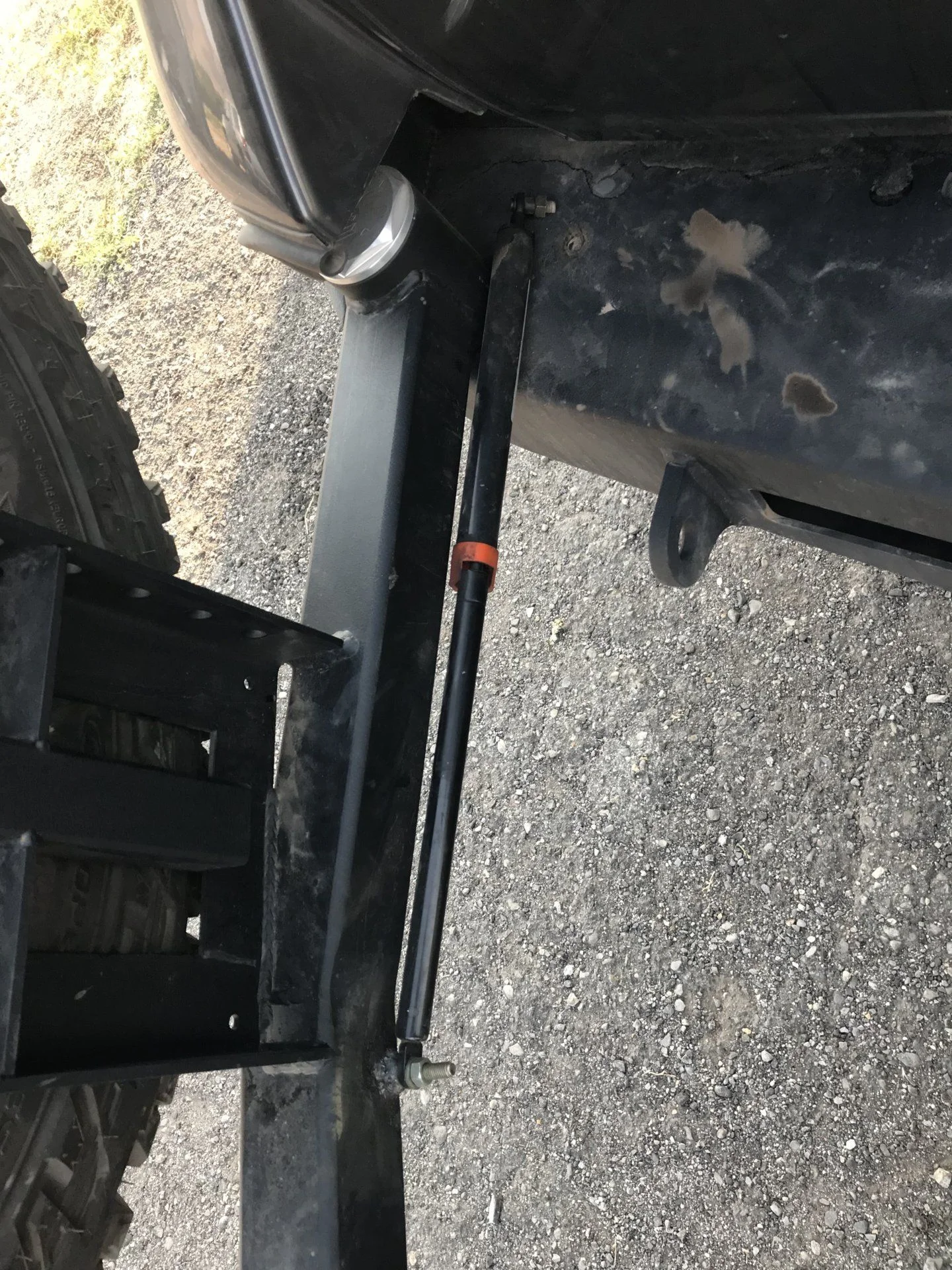

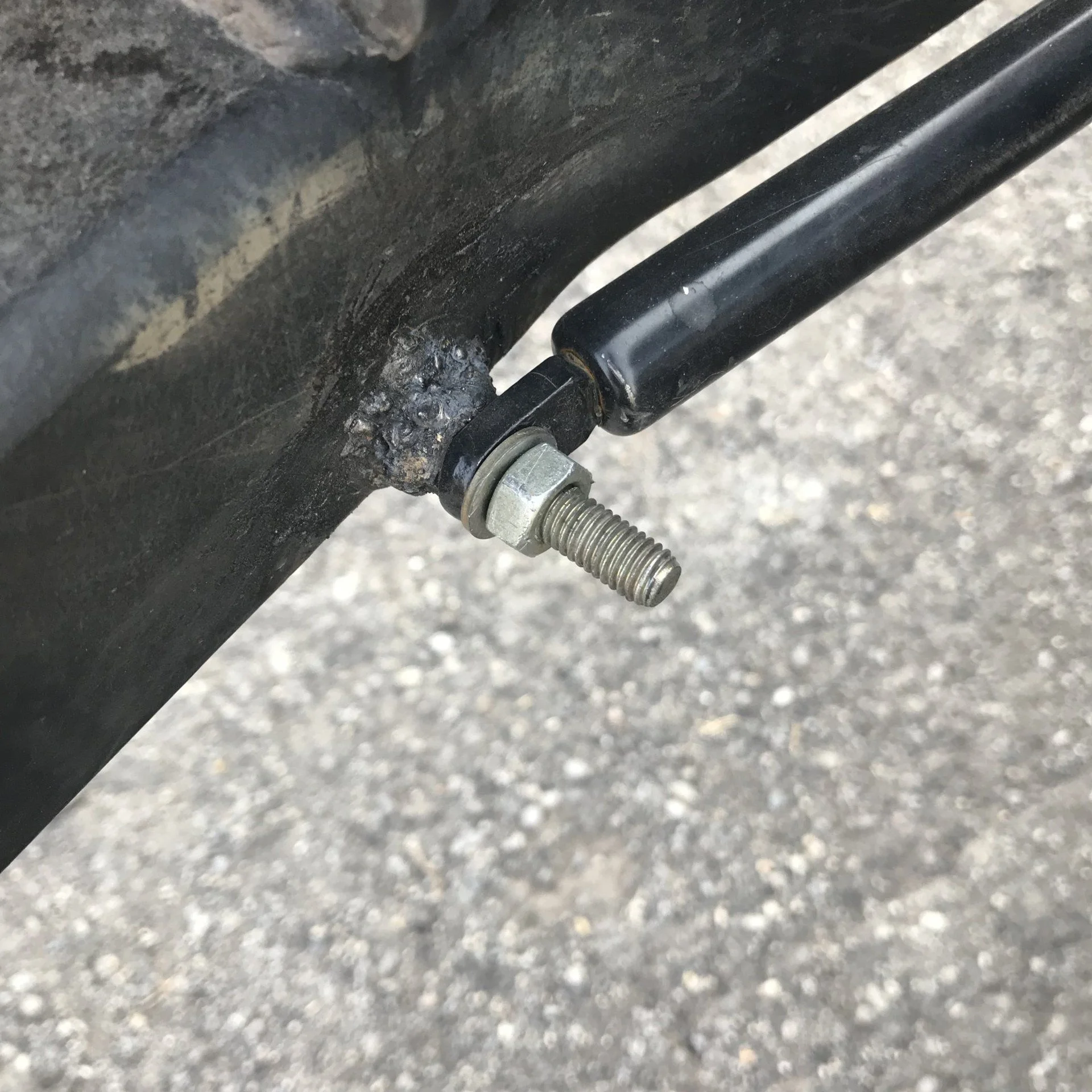

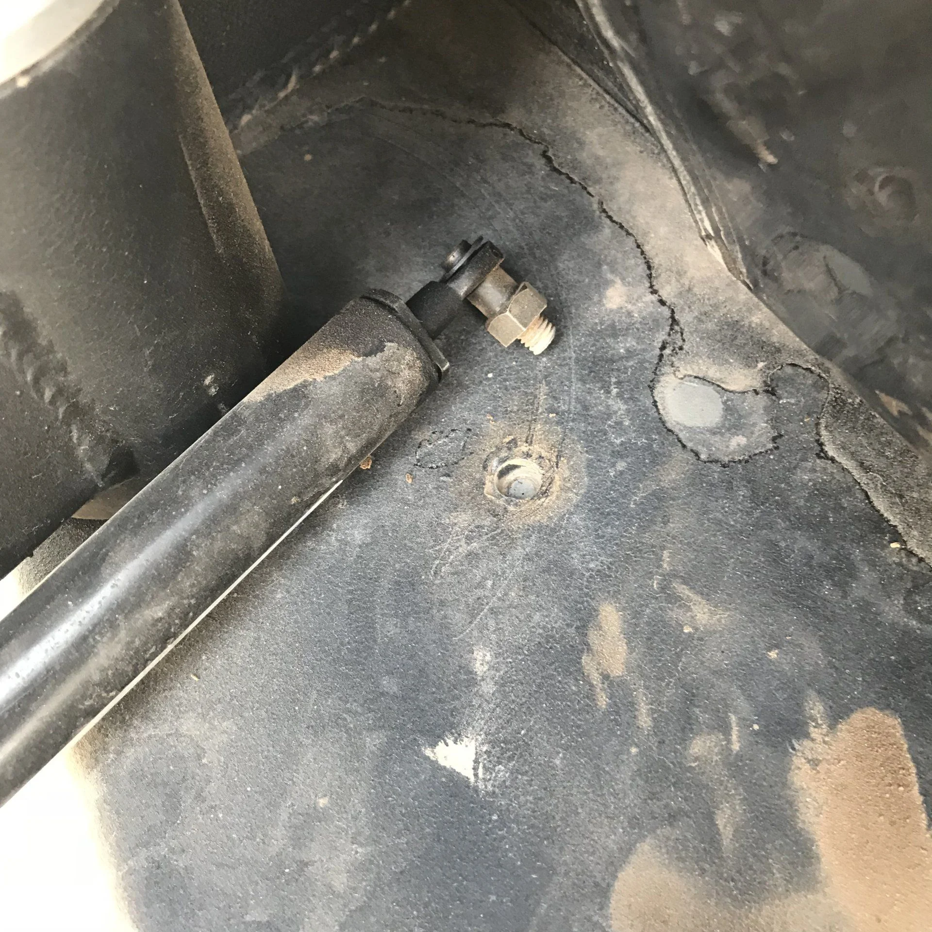

Beyond that hold open/latching mechanisms are problematic. On an otherwise outstanding Trail Tailor bumper less than a year old, the studs on one of the struts has already failed on both ends. The PO welded a bolt on one end. The other side just failed, sitting on level ground in my driveway. I have opened it less than a dozen times as I recently bought the 200, none of them were abusive, hard slam openings.
The TT has lock open struts, which make closing a double swing out a 3 handed (or 2 hands and body checking a dirty spare) operation. Again not :princess: princess friendly.

That type of connection would work much better with a Heim type ball joint as opposed to the existing?
